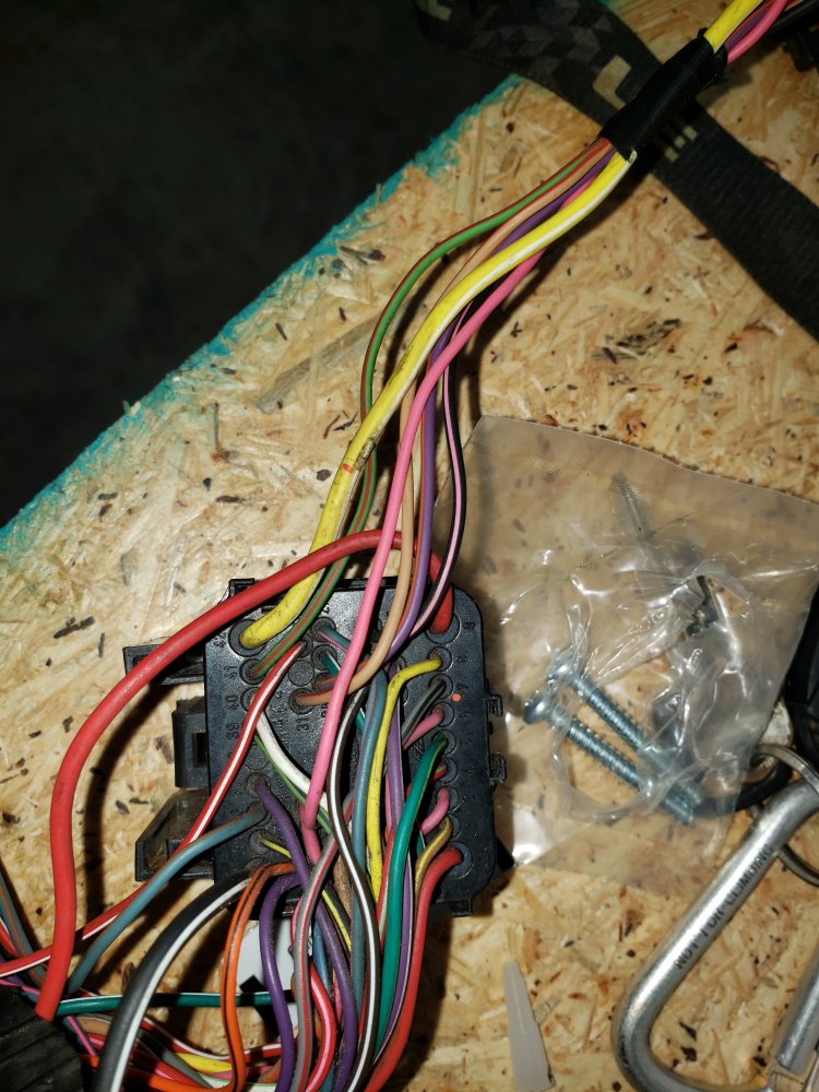

talked to a freind of mine who has used a few terminator kits on LS swaps today, he said he had 3 bad factory wiring harnesses and tech support for it at holley is useless because they sub the manufacturing of wire harness, also the "self-tuning" did not work for him, i believe he said due to injectors, and they had to be professionally tuned to get it right. so thats his opinion/experience. he recommended i get the sniper kit if i wanted to that route.

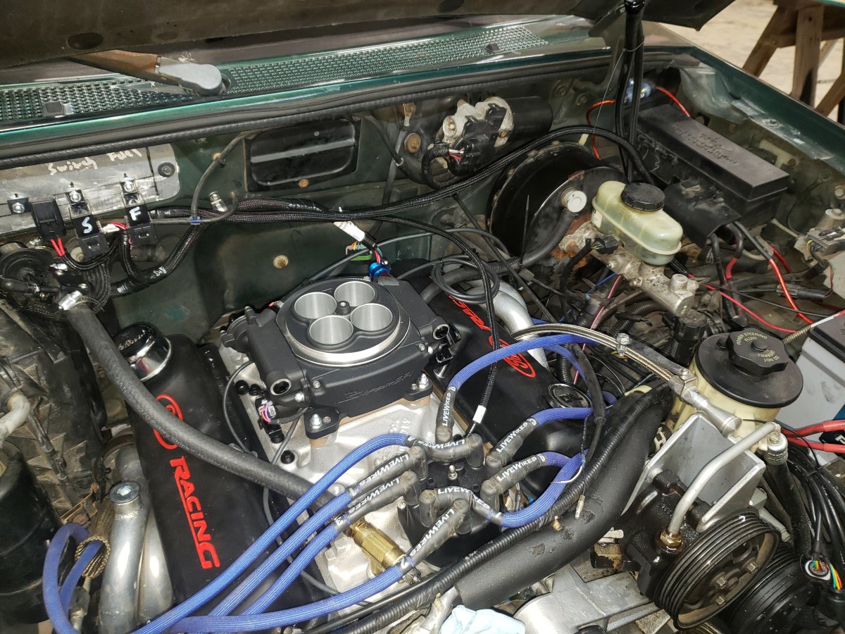

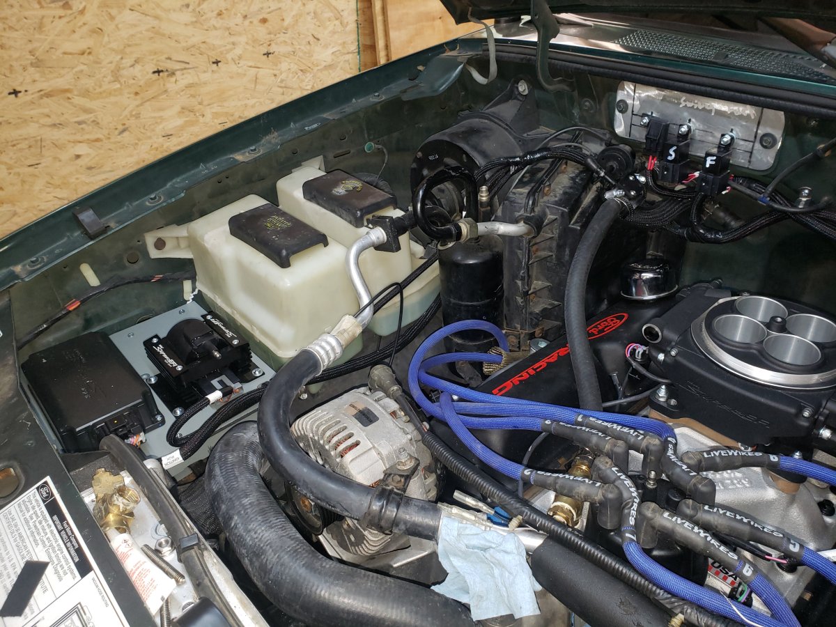

Making some headway, carb intake on, panel to delete original ecu, and hold fuse and relays for sniper. I removed some of the tape holding looms in sniper harness to reroute them for my install. Did not change length of wires just routing. Harness wanted everything on one side, I wanted coil and ignition box where stock air filter is located. They are mounted on a peice if 1/4 plexiglass with a few peices of small angle iron underneath, nothing fancy. Ecu delete panel and relay mount is just that, nothing else. Working on looming, and cleaning up wiring still. Will post more of that later. Rond has been helpful as always.

Still has functional A/C. Doesn't look like you had to clearance the evap housing.
This could be the way I go if/when I've had enough 2.9L in my life.

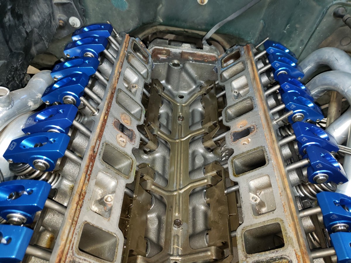

It was running with a traditional 98 explorer style swap. Just not satisfied. A/C will still be functional, will need some more sorting out of wiring for that. But will happen soon. Sniper ecu has outputs/inputs for ac kick on/off also. Already had AN feed and return lines for fuel. For evap house I heated with heat gun, pressed gently with oil filter. Minimally. All that is in my swap thread.
