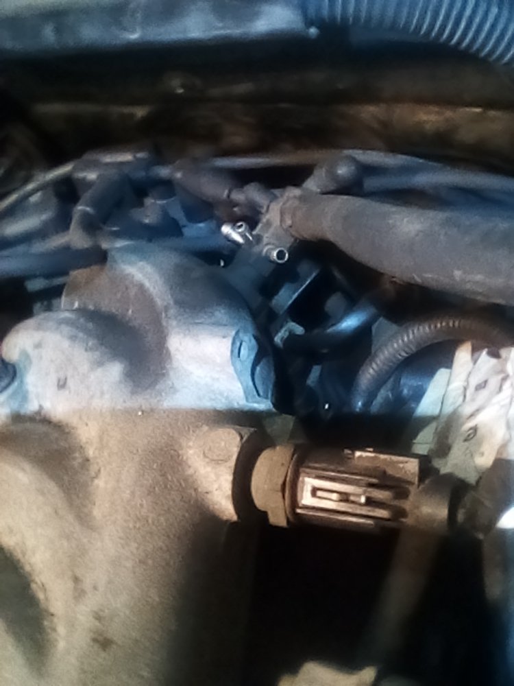

Anyone know where these vacuum lines go? 1991 3.0
misterW
Feb 15, 2010
90
1994
Take a look at the pic, these are the vaccum lines that come off the back of the intake manifold, right near the distributor. You can see there are 3 lines that don't have hoses. I swear I labeled these. But somehow over the course of a project taking much, much longer than it should have...they're not labeled now, and I cannot find where they are supposed to go. I took a vid of the engine compartment before I took the engine out, but the file somehow got corrupted haha.
It's a 2wd, and I don't have AC anymore, so I don't need to worry about lines that do anything for that . Is there anything essential these lines are supposed to be doing, and if so, where do they get routed?

The brake booster and pvc line should be large diameters, the only smaller lines would be for the cab vents, dpfe sensor/egr valve, fuel pressure regulator and evap purge.
