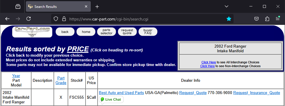

I didn't repeat the search with 2001 and 2003, but here is the one sole hit that came up for 2002...

I didn't repeat the search with 2001 and 2003, but here is the one sole hit that came up.
Thanks for the catch. I see that one too. Car-Parts automatically searches for the full range of 01-03 if you pick any year inbetween.
And I've seen screenshots from 8 months ago on other forums, where that part shows up from Best Auto. So it's been listed for a long, long time.
Every other time I've seen one appear, it goes away within a week.
Which had me skeptical. So I look at their reviews, and...
Sadly, I don't think the one they have listed is real or exists. The overwhelming number of those reviews says "scam," or "they'll take your money and never ship," etc.
