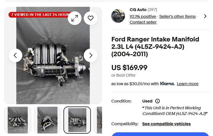

I'll still sell ya mine when I'm done with it but if you need one sooner this one popped up on ebay! Looks clean too.
