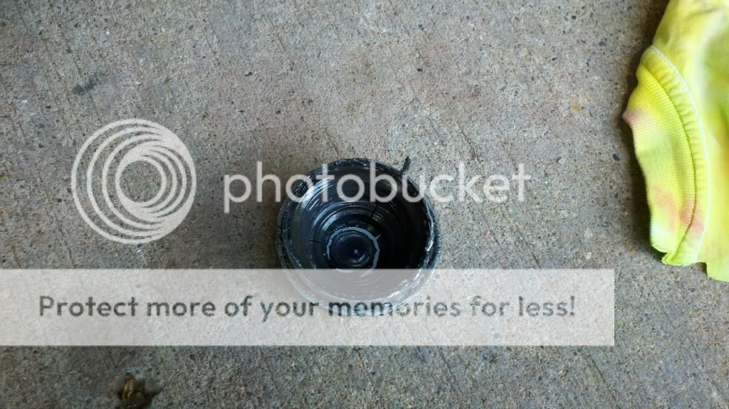

Didnt get to do it this weekend but heres a teaser pic

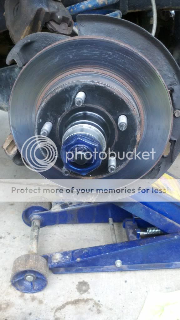

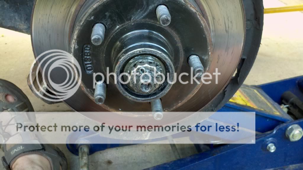

despite the early morning rains i did manage to rotate my tires and change out the bearings and install the oil bath hubs. i took my truck for a 2 mile test run in hopes that if it leaked i would be able to catch it before it did irreversible damage, but as i had hoped all went well.

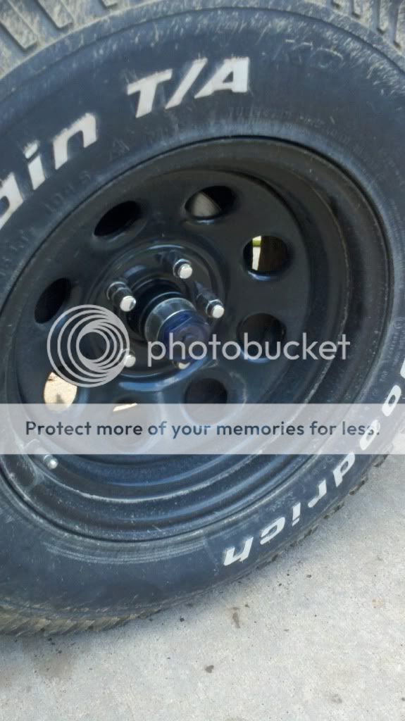

im running the wheels with no center caps so i can keep an eye on the oil levels incase one of the seals starts to leak, i drive 80 miles a day to work so chances are if something goes wrong and i dont catch the noise in time i will be sitting on the side of the road waiting for the tow truck but so far (12 miles) i have no leaks and the levels are dead even with the bottom of the holes.
So after approximately 60 miles the only sign of oil outside of the hubs is this little bit that i believe slung off from the fill plug, so im going to try to add some atf to both hubs to see if that swells up the rubber a bit. I should have added it when i initially filled them but i was unsure how much they would take so i skipped that step. Ill keep updating this thread until i reach a final conclusion on this experiment.

I agree theyre not that large when compared to what some other guys are rolling on but the difference between a 30lb tire and wheel and a 60 lb tire and wheel is quite noticeable, especially in the stopping fast department. I think a 31 is as big as i would feel safe with having only single piston calipers, plus its only 2wd and my daily driver so 31 should probably be max any ways. I did just add the atf on my lunch break after wicking some 75w90 out with a clean rag, then i wiped off the wheel where the oil sling marks were so ill see how things look when i get home tonight.

I know the 4x4 bearings are close to if not the same size inner and outer, where as the inner on a 2wd are twice the size of the outers, which i believe is the reason im having the wear problems. Both of my small outer bearings were burnt and had a nice gold tint to them, while the inners still looked new.
