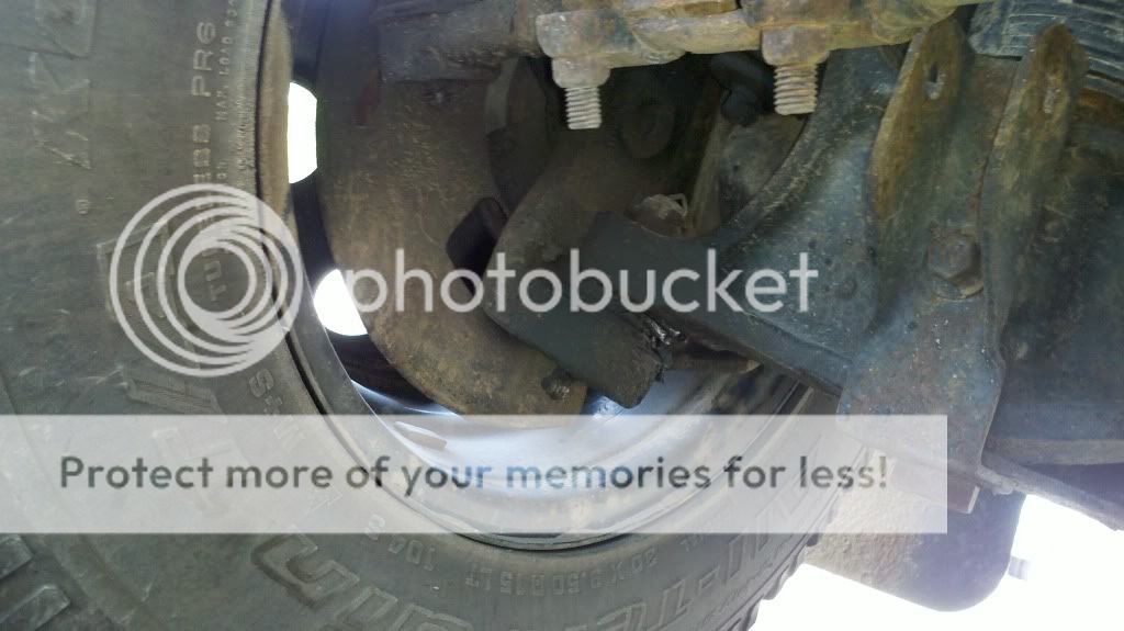

Ill try to take a pic of the leak today, im betting its on the top side of the spindle because it doesnt seem to leave a puddle in the wheel when its parked but ive got an even band of oil around the inside of the rim, luckily it runs into the rotor and comes out the fins so its not drenching my brakes, its just quenching my rotor from the inside out haha!

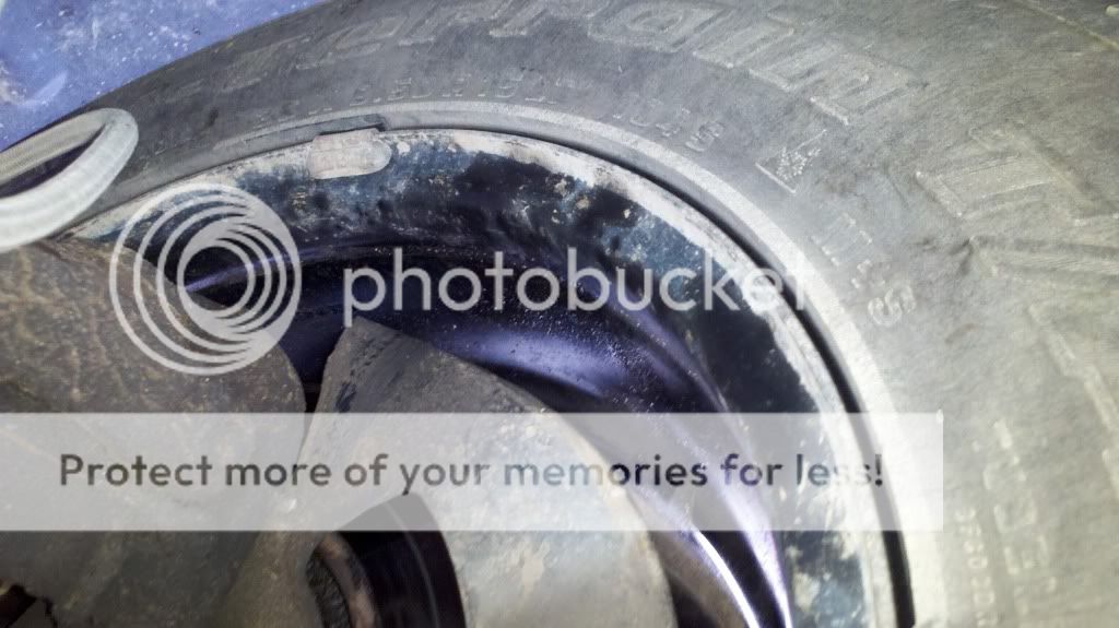

Heres the pic of my oil leak, i didnt touch the oil level between when i cleaned the wheel and when i took the picture, so ive got about 100 miles worth of leak here.

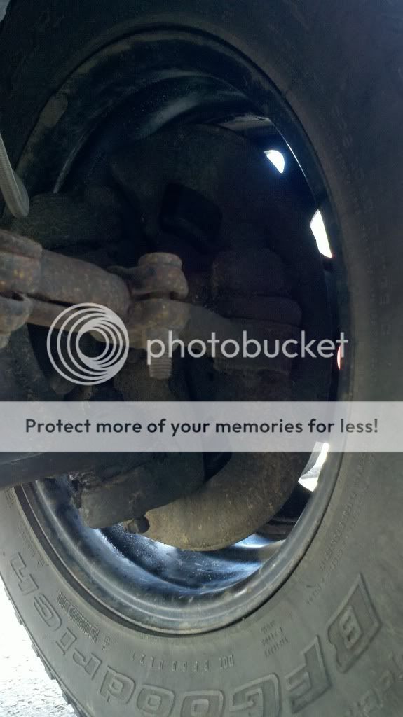

Heres the passenger side for comparison, no leaks since i installed them

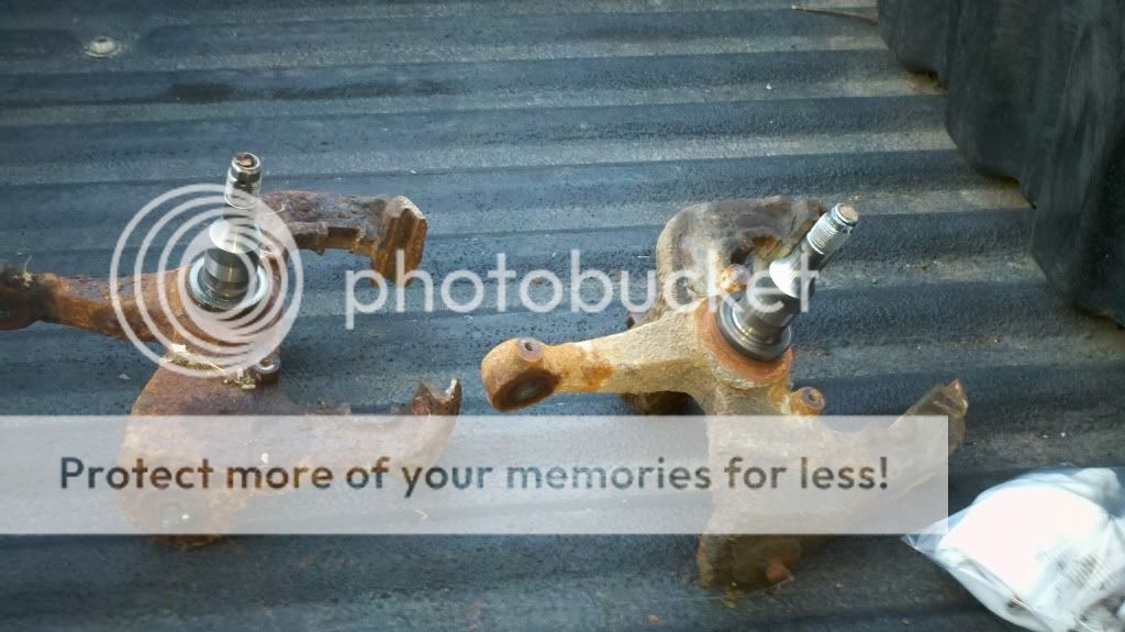

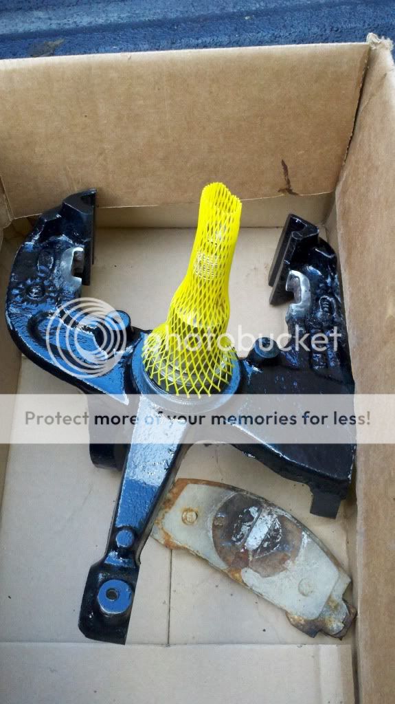

victory at last, the hi temps finally broke and i got work done. heres my two specimens, one from a 90' and one from a 94'. i cleaned the best looking one up and welded up the wear areas from the inboard brake pad, now i just have to grind-to-fit with an old brake pad and then i can swap ball joints and hope this fixes the leak.

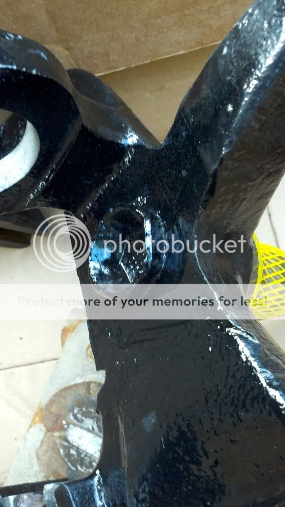

the only difference i noticed between the 90' and the 94' was on the back side of the knuckle where the spindle is swedged to the knuckle, on the 90' it has a tapered hex and on the 94 it has a uniform hex shape inside of a raised and machined nub.
i measured this spindle with micrometers and compared the measuments to BCA / Nationals' published bearing and seal dimensions and everything is within spec so now i just need another window of opportunity to swap out the bad one for the good one
