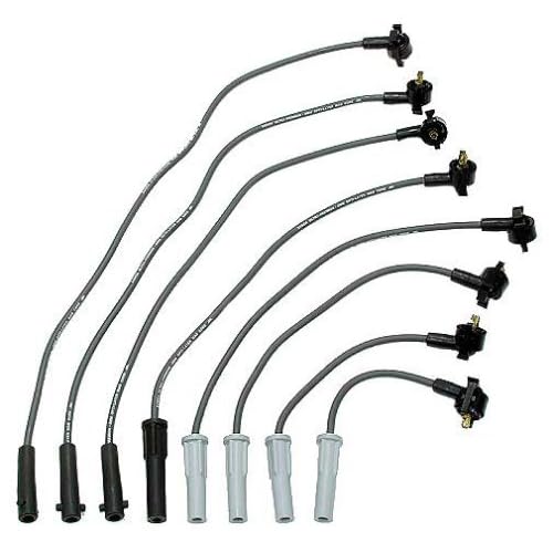

maybe this is an issue. these are the bosch plug wires i have
there isnt any indication on which 4 go on which side. so i just lined them all up from shortest to longest. then i would pull one spark plug wire off the truck and find its best match. it ended up being the 4 wires with the gray boots on the exhaust side and the 4 with the black boots on the intake side. also whats with the 3 odd black boots? are those supposed to go on certain cylinders? the directions didnt mention anything about this.

also whats with the 3 odd black boots? are those supposed to go on certain cylinders? the directions didnt mention anything about this.[/QUOTE]
I just changed Plug wires on my 96 (original wire set) as well as plugs went with autolites and Duralast wires.
the odd plug ends are for the plug pulling hooks that come on three of the drivers side plugwires from the factory
, the wire under the ac pump, and both wires under the intake plennum.
use a small screwdriver to unclip the pulling hhoks and reassemble them around the new wires.
