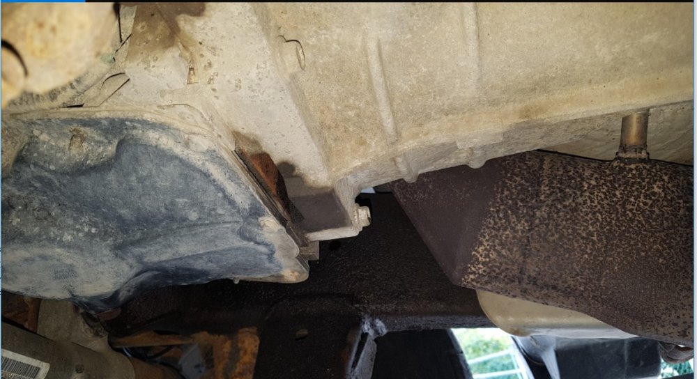

Hm. i did notice a bit of moisture down there. but it didn't look bad at all, but not perfect (see pic). Is that DEFINITELY hydaulic fluid from the slave? looking at my master reservoir it didn't look low but i did top it up just now a touch past the step... hopefully that doesn't over pressurize anything.
Would your throwout going have anything to do with the slave losing pressure?

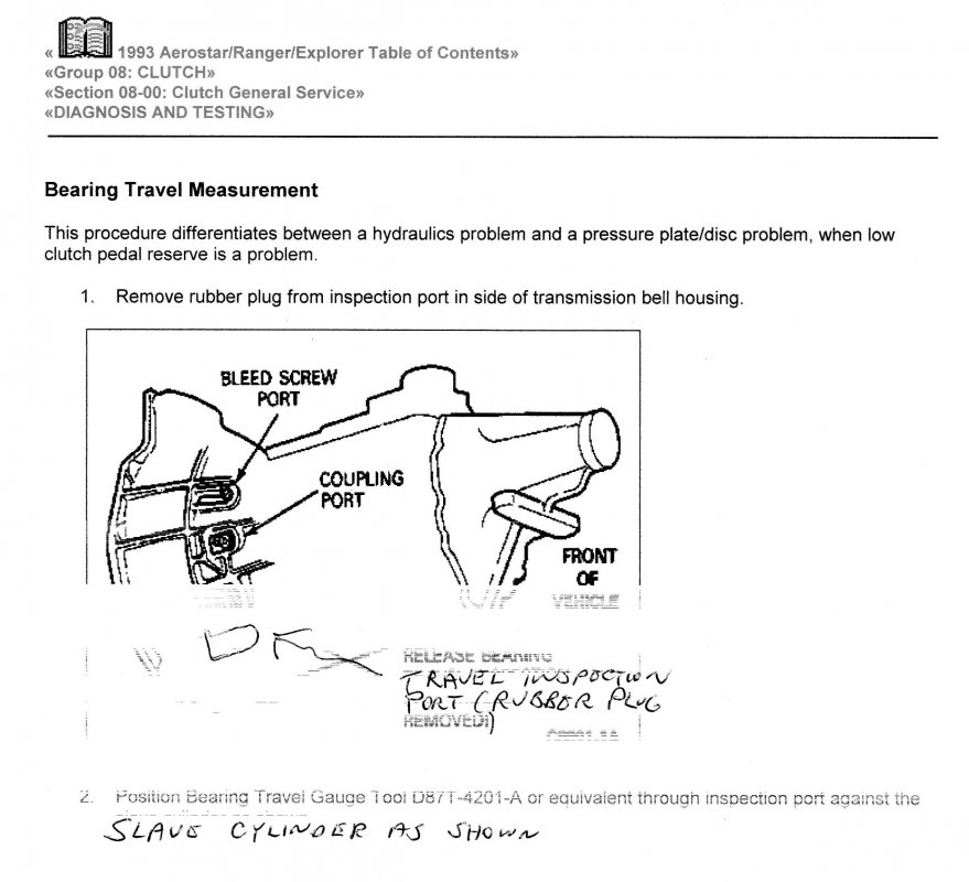

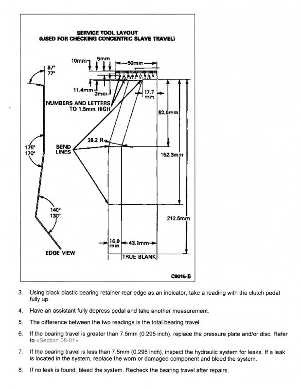

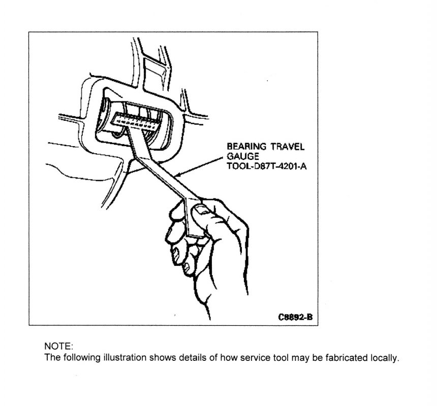

You can take a bearing travel measurement fairly easy with the home made tool shown, or anything that will give a good measurement
Yeah i wasnt being argumentative just wasnt sure if you were serious or not. It seems many cars these days actually automatically shut off at stop lights, so i can live with shutting my off and restarting. easier to replace a starter than a clutch.
Regarding the bearing measurement: what would i be looking to achieve there?
I suppose your problem is the clutch is not disengaging and that will help determine the problem.
