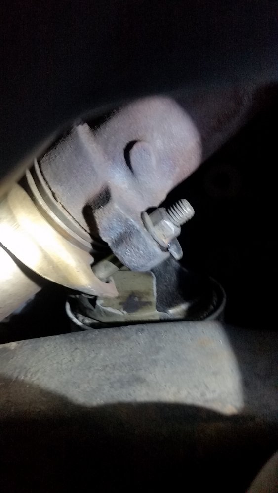

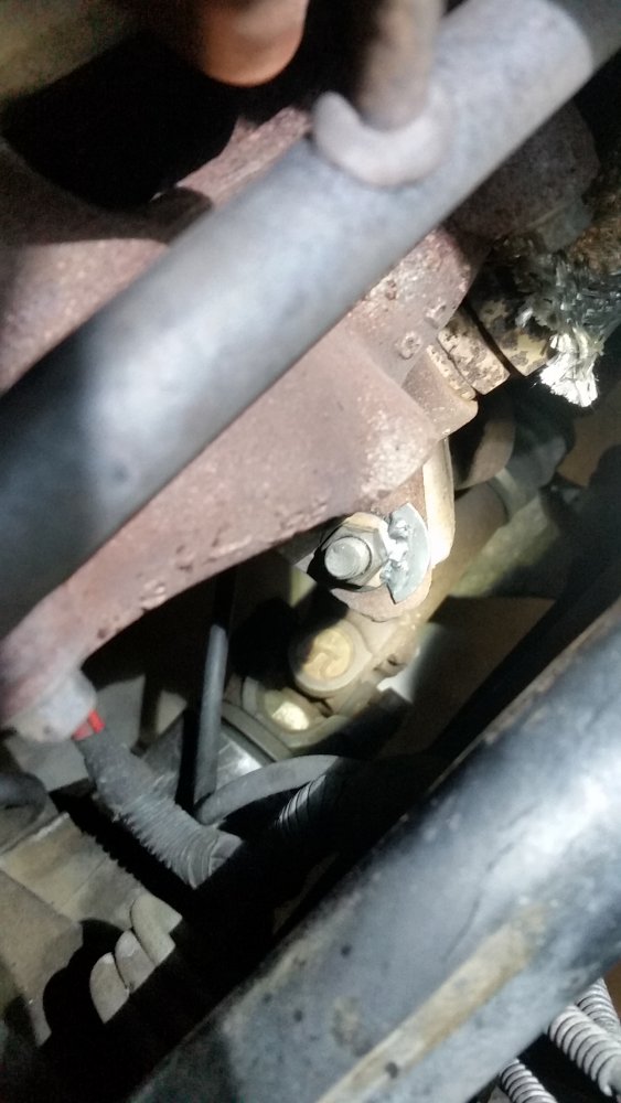

Removing the Y-pipe from the exhaust manifolds was a huge hassle. I used my complete playbook of tricks and still managed to snap one of the bolts (no damage to the manifold!). I was able to drill it out without having to pull the manifold. For the reinstall I used bolts where I welded a tab on the nut to prevent it from spinning. The bolts go through the existing threaded holes on the manifold flange. I gooped the threads with nickel anti seize. I now have the option of cutting out the bolts if need be. See photos.
