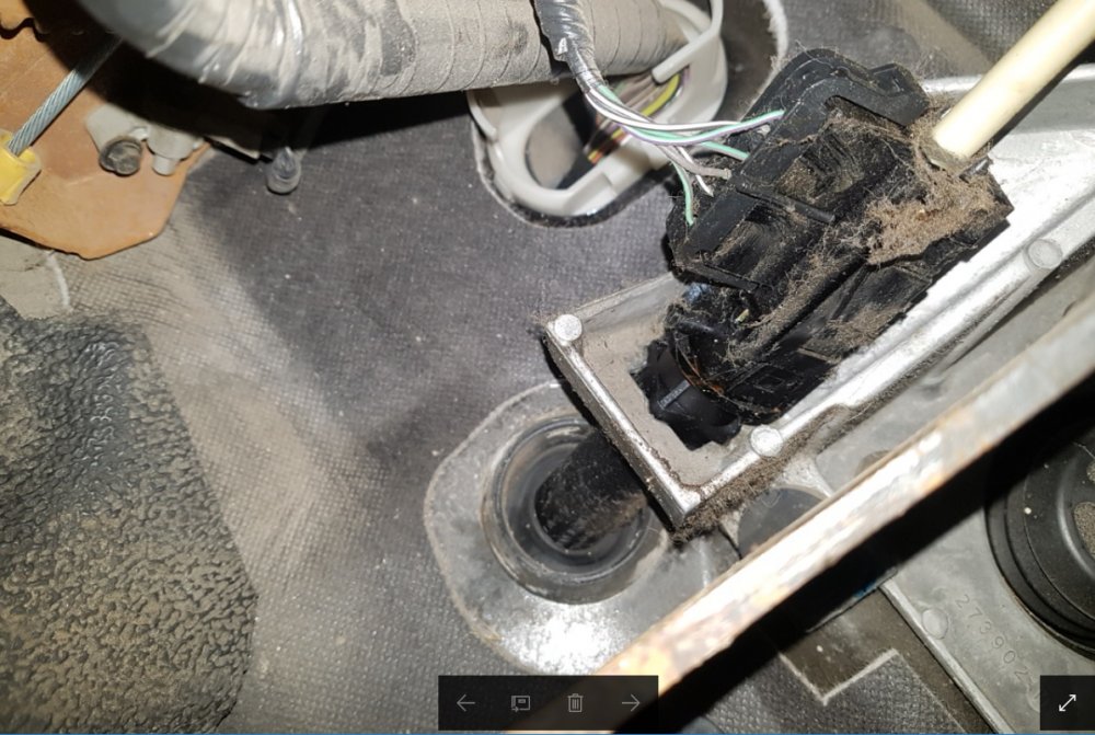

Here is a photo of the power torque slave cylinder i was referring to earlier, that clip makes it so much easier to secure.
