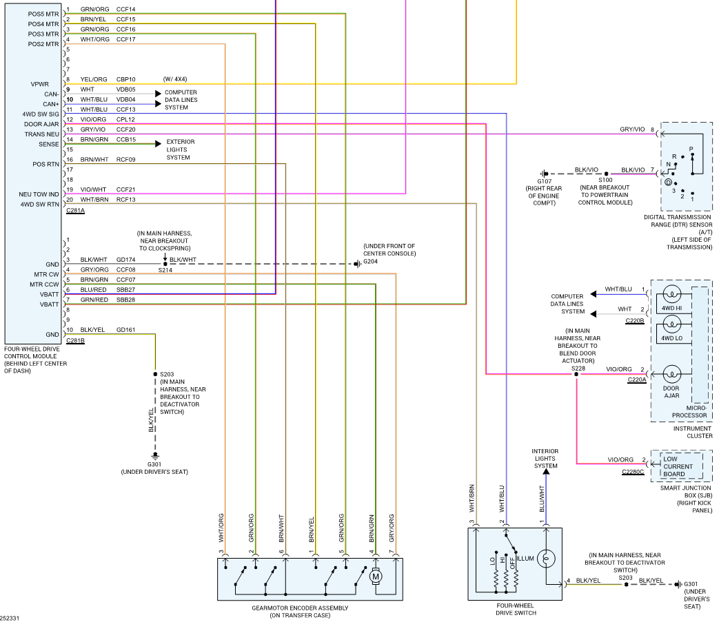

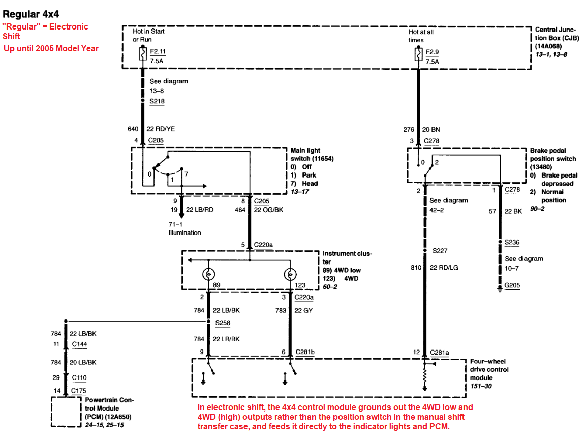

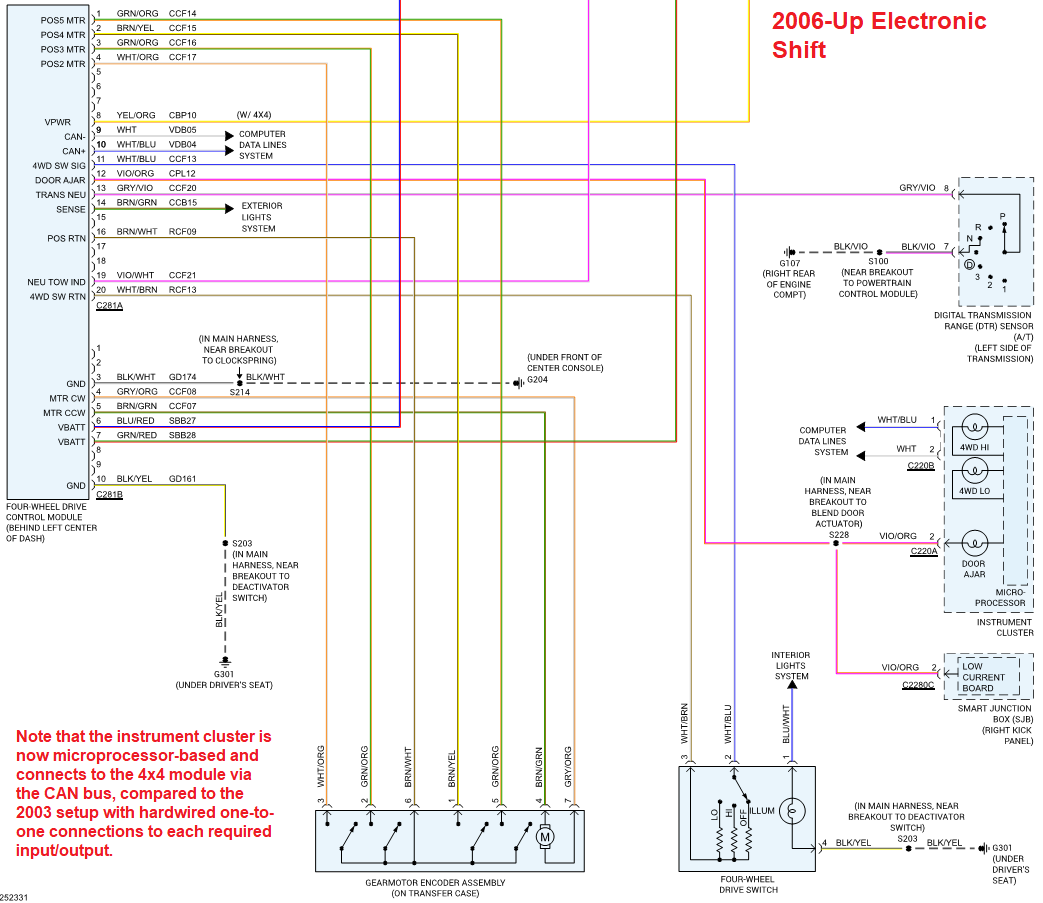

Unfortunately, starting with the 2006 model year, Ford implemented a high-speed CAN bus to connect all the modules together, including the PCM, 4x4 control module, and gauge cluster. This means that rather than point-to-point sensor/switch connections to multiple modules, everything goes back just to the "parent" module and then the modules talk to each other over the HS-CAN bus. (See attached diagrams).

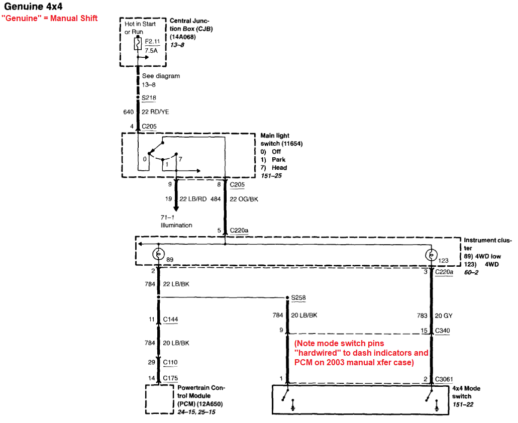

The 2003 manual transfer case setup omitted the 4x4 control module entirely, and has a 4x4 position switch in the transfer case hard-wired to the 4x4 High/Low dash cluster lights and the PCM. The position switch either grounds out pin #1 or pin #2 depending on whether it's in high or low, and that satisfies the PCM and dash cluster.

I'm thinking I will need to leave the 4x4 electronic selector switch in place, and switch it along with manually shifting the transfer case. I'm also thinking I'll need to somehow take the position encoder from an electronic shift motor assembly, and attach it (without the motor itself) to the manual transfer case so that it will communicate the transfer case position status back to the 4x4 control module and avoid any DTC's or malfunctions. But if there's a way to just make the 2-pin position switch satisfy the 2006-up electronics without the need for all that, I'd love to hear it.

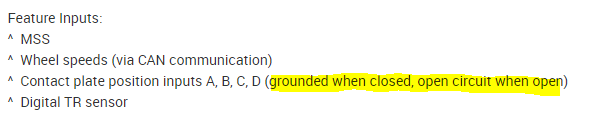

I dug into the "principles of operation" on the 2007 4x4 system and found the following (Incidentally, @lowspeedpursuit you're correct on the speedo):
The "4x4 Mode Switch" on the 2003 manual t-case grounds out either pin 1 or pin 2 depending on whether the transmission is in 4H or 4L. Those pins are an open circuit otherwise.

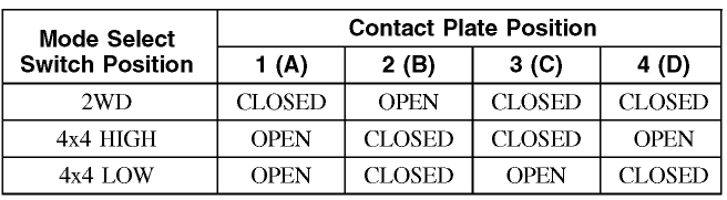

In the troubleshooting/diagnosis section for the instrument cluster lights, the following table is provided:
So if I take the 4H pin on the manual T-case switch and wire that to contact plate wires 2B and 3C, it will close (short to ground) in 4H and correspond to the 4x4 High mode switch position.
If I take the 4L pin on the manual T-case switch and wire that to contact plate wires 2B and 4D, it will close (short to ground) in 4L and correspond to the 4x4 Low mode switch position.
When it is in 2WD, both of the manual t-case switch pins will be open, satisfying the required 2B contact condition. My only remaining problem is showing 1A, 3C and 4D as "closed" - or shorted to ground - in 2WD mode. In theory, though, if the system is reading 2B as "open," then you'd think it would be programmed to know that it's not in 4H or 4L since that contact being closed is common to both. I suppose it may throw a DTC or the 4x4 lights may blink, interpreting it as a system malfunction. Only one way to find out! If that's the case, I may need to add some sort of circuit that senses an open 2B state and grounds the other three with a relay or something.
