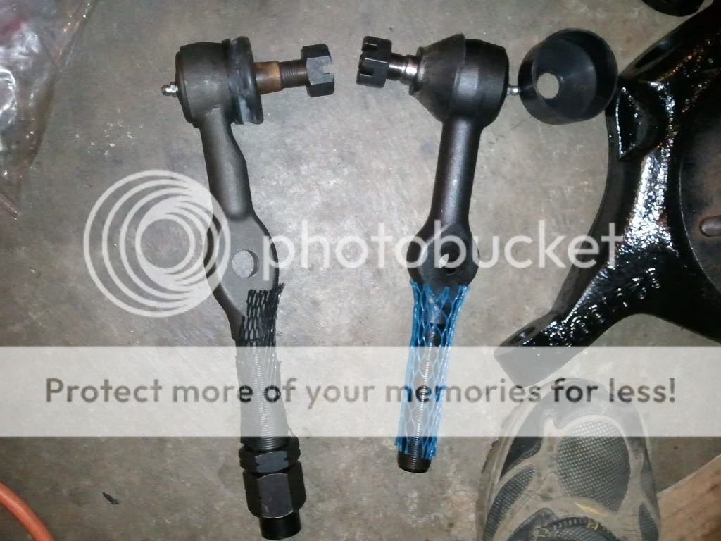

Well I thought TREs would be the best easy way . Got another end from O'reilly's auto parts for $20 . Not as nice as the one from ruff stuff but should work . Just need to drill it out and ream it . Part # ES2233L .

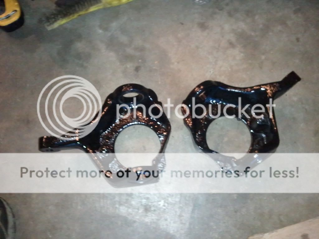

Got the knuckles cleaned up and ready for new TRW ball joints .
what are you going to do about the big ass hole in the bottom?

Lol .... in the knuckle:icon_confused:
yes. If you ream out the hole in the top, how to fill up the gap that will be in the bottom of the knuckle

I used these.
http://www.ballisticfabrication.com/Tapered-GM-TRE-insert_p_1706.html
Drill the whole out to a inch and weld these in to get taper the right way.
Thanks for the link . But I don't know , I might wait and do that later . Should be just as easy to do that later when I have more time and money .

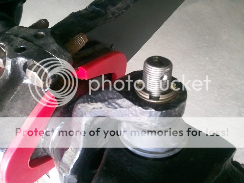

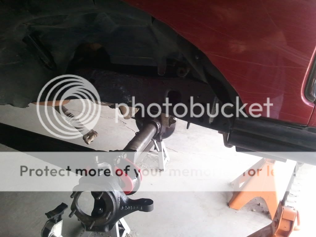

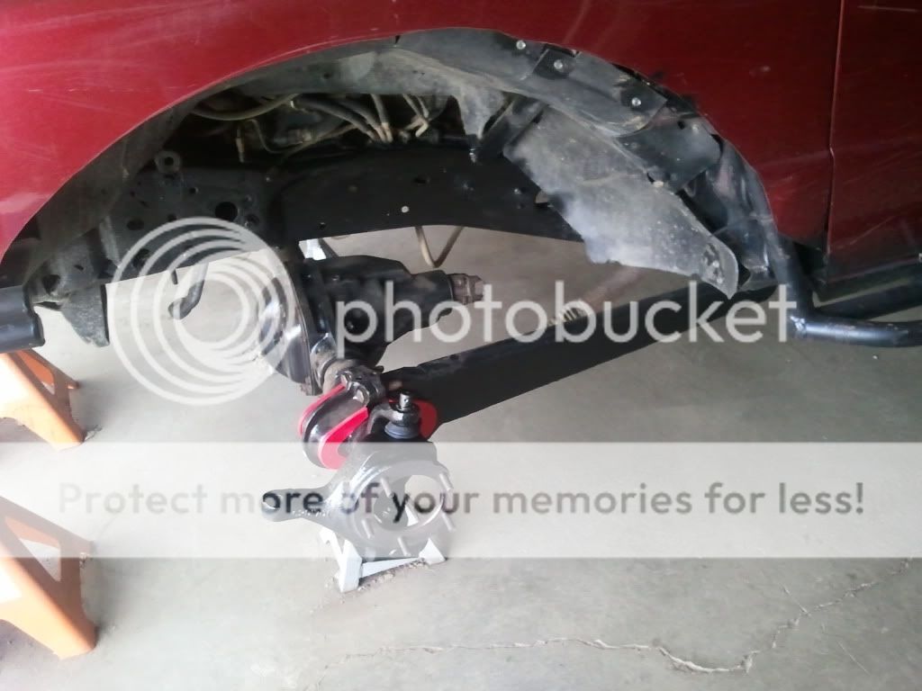

Got the ball joints pressed in and knuckles halfway installed . And took the old coil buckets out .
Need to order or make a socket to fit the upper ball joint sleeve . It needs to be torqued to 70 ftlbs .
