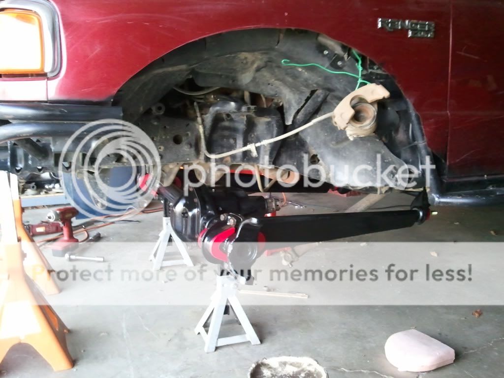

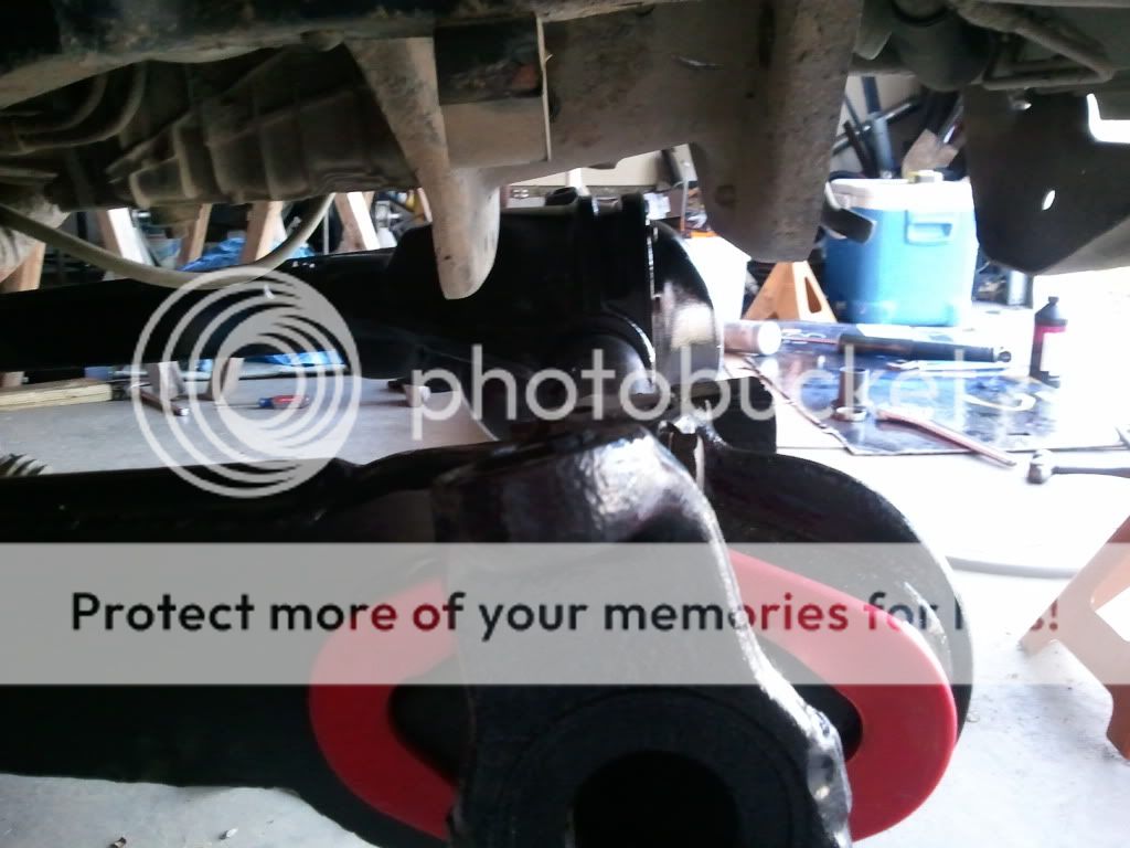

I need all the help I can get .
The plan was to ream the knuckles to put the tie rod ends on top but they are already reamed to fit in the bottom . This wouldn't be a big deal just easier to hit the on the rocks but the y-link end is reamed to work on top .
I drilled mine all the way through, then welded in a reducer to run a 1/2" bolt, and ran my drag link on top of my track rod on the passenger knuckle. I ran heims though. I have heard if you buy the good heims, they will last a while, but they make a lot of noise as soon as the teflon wears out. Kage has the same issue as well where they make a lot of noise
