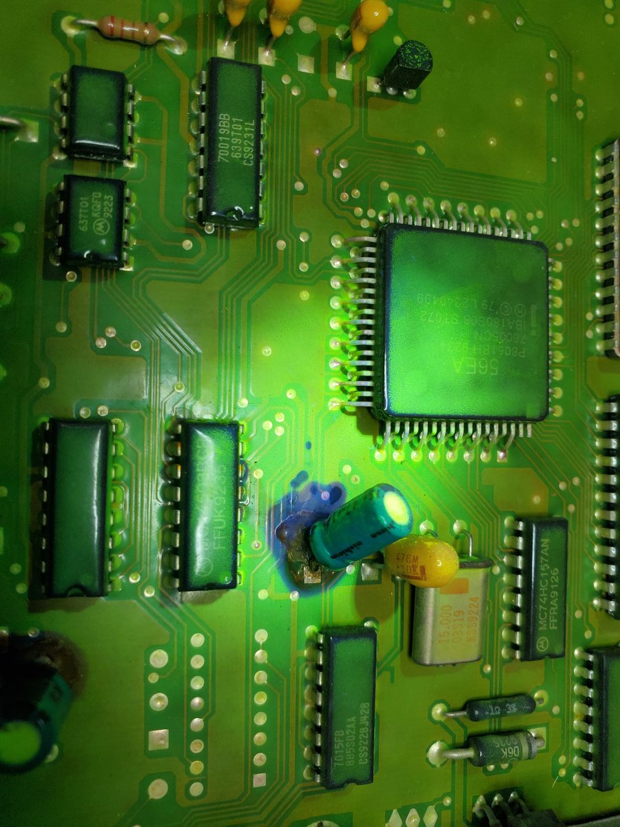

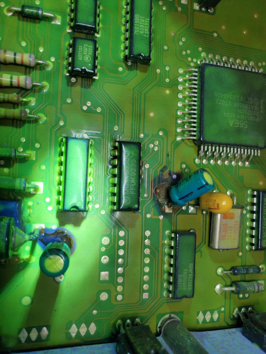

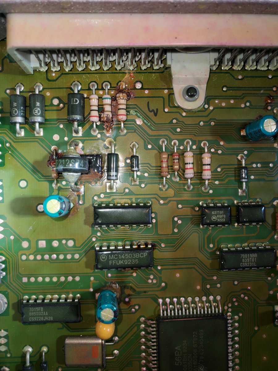

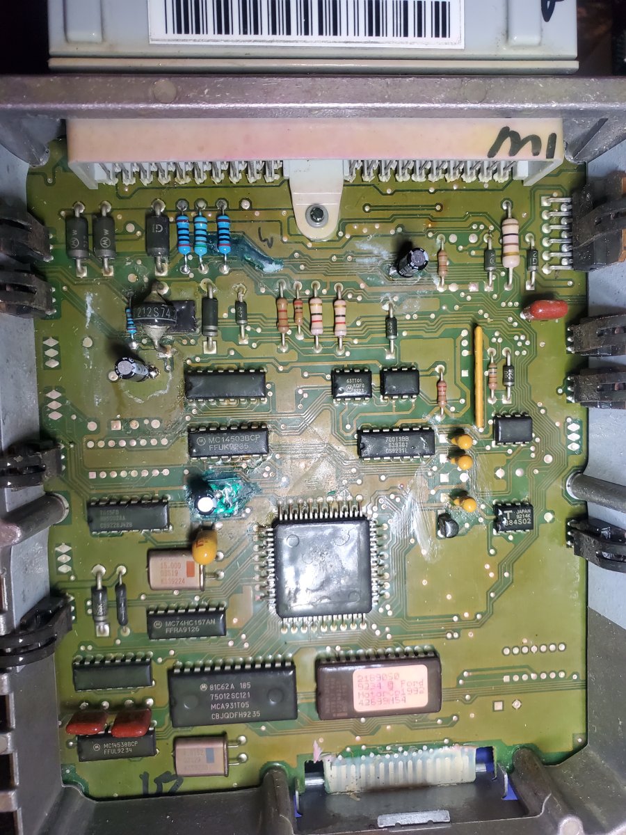

My Ranger has started to run like its got no fuel. It start as a stumbing under load and then not idling.
Today I stared to dig into things and decide to pull the ECU and found this carnage.
While I wait for parts I am ultrasonic cleaning for board. I am hoping for no to minimal board damage.

Oof, that's nasty. I think you caught it in time where it would be pretty easy to save it though. Amazing what the electrolyte did to the coating on the resistors.
Edit: modern tantalums are supposedly better than vintage ones but you might consider changing them for film caps or electrolytics depending on the values.

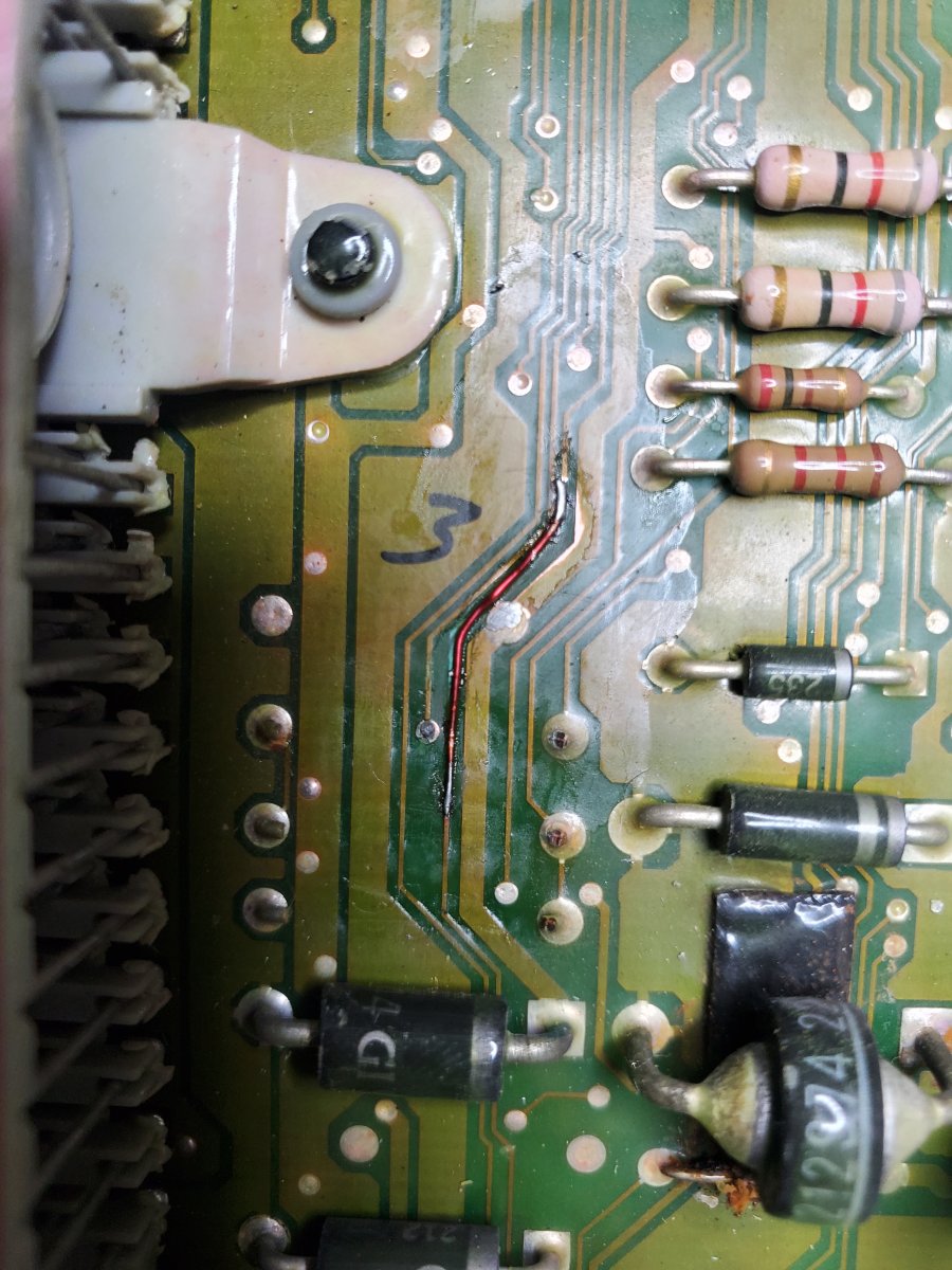

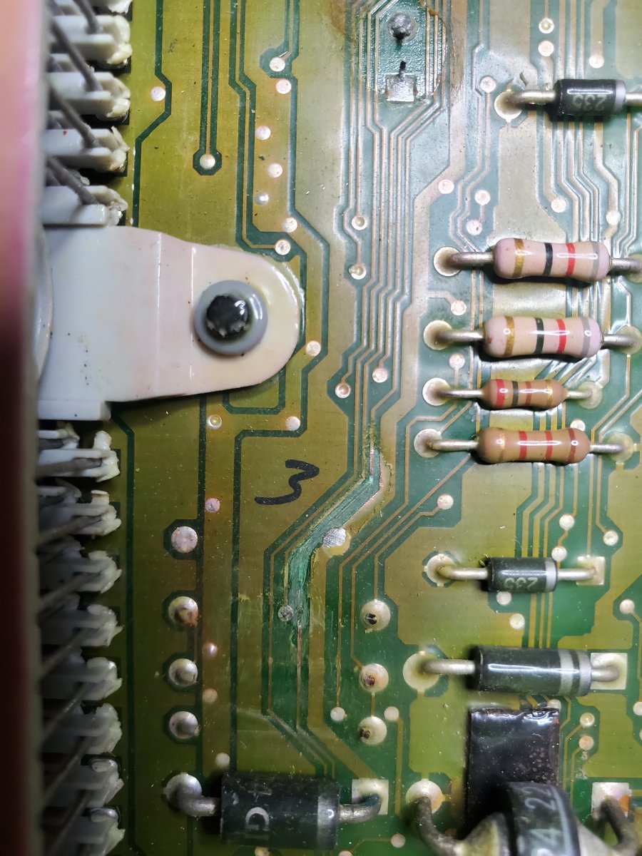

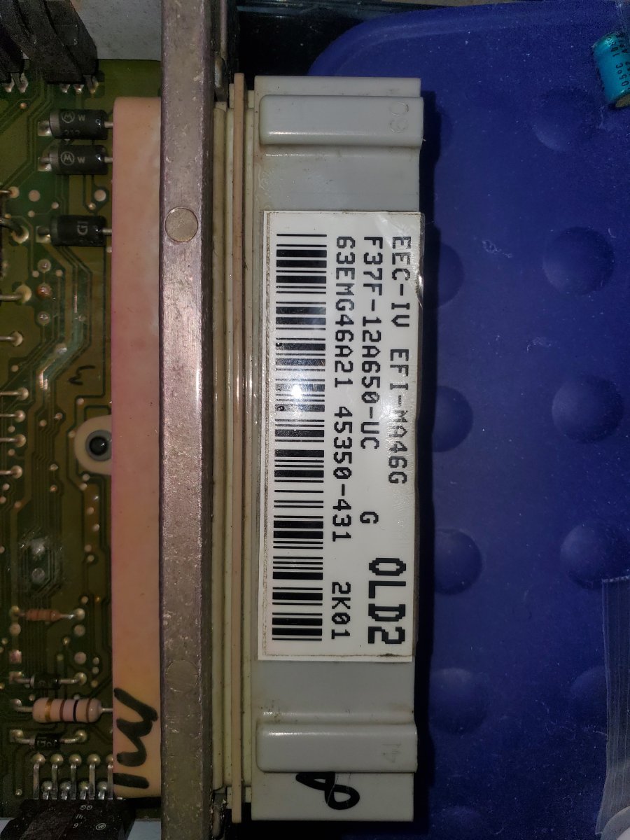

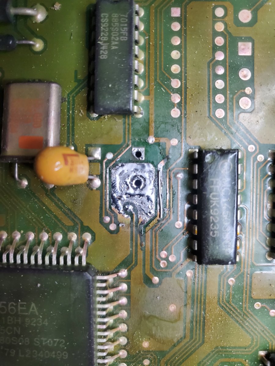

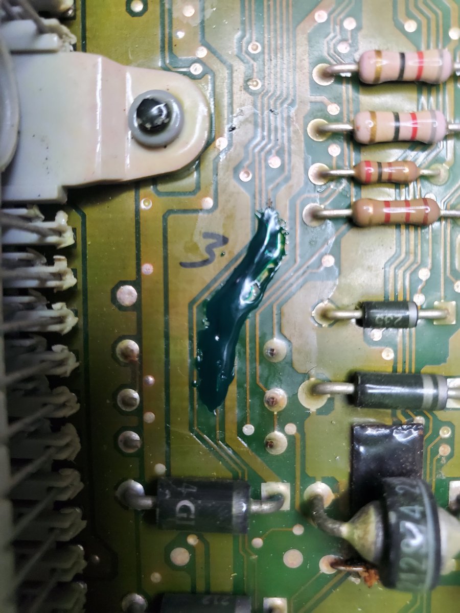

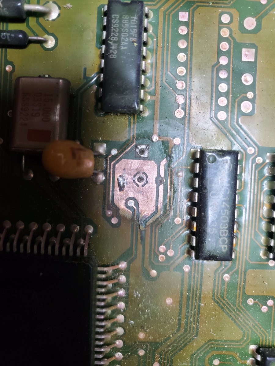

I have an update: I had to repair two traces, replace three capacitors, and four resistors. I don't have the tantanum, and I need to conformal coat the areas where I removed it, so I'll do that later.
The truck started right up and runs like a top.
I am by no means an expert at board repair, so probably better ways to get this done.
I found it best to clip out the bad components, scratch with the fiberglass pen to remove conformal coating, solder mask, and corrosion. The electrolite gets under the conformal coats and solder mask and eats the copper away.
Flux the area and add new solder to melt the old solder, pull the legs out.
I used the needles to clean out the holes; solder wick would work too.
I used my ultrasonic cleaner with a mild solution of white vinegar to clean up as much of the mess as I could.
A tip: with a UV light, you can see where the electrolyte has leaked.
For the traces that were damaged, I used magnet wire to make the repairs. Coated the clean copper and the magnet wire repairs with UV-cure coating.
Make sure you use an ohm meter to verify your repairs. The vias can also be eaten away, and that's a tougher repair; that's when you have to run bodge wires to complete the circuit.
The resistor values were guessed, I decoded the best I could, and compared them to photos online. I hope they're right
My ECU is from a 93 4.0L Ranger, if that helps anyone. If I were not in a hurry to get everything running, I would have made a video.
