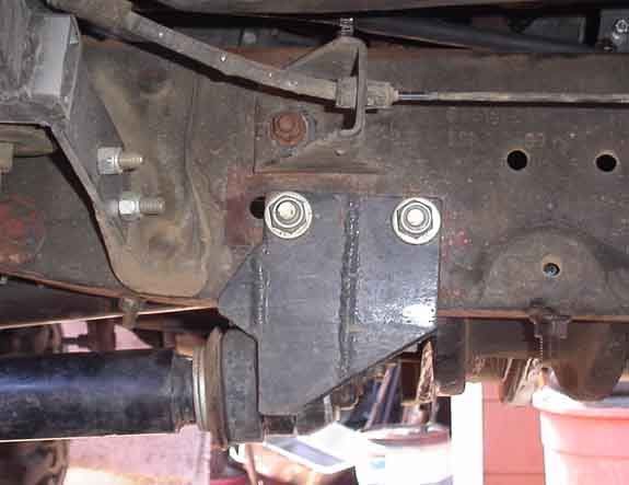

I built mine from scratch
(more pics are on my BII Cardomain page)

The "donut" for the bushing is angled downward very slightly on mine (to match the RA's angle).
I used 2" wide CR steel strip (3/16" thick) to make them. The "donut" I made using some of the leftover DOM tube from the arms.
If you're not sure on fabbing them, then I'd probably look at the '73-'77 mounts. IIRC, they can be bolted on.
12-15" over stock length is a good range to shoot for (mine are 12" extended)

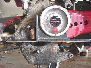

See, that's what I don't/can't understand. How do I measure caster and all that. Do I need to buy one of those angle measuring devices?
Allen
Having one would certainly make it easier.
Try to find one like this that has magnetic sides on it so you can just stick it to the knuckle, beam, wherever and leave it.
Measure where it is now, and then just match it up when you build the arms.
(this provided your trucks handling (and steering return-to-center) is good currently)
