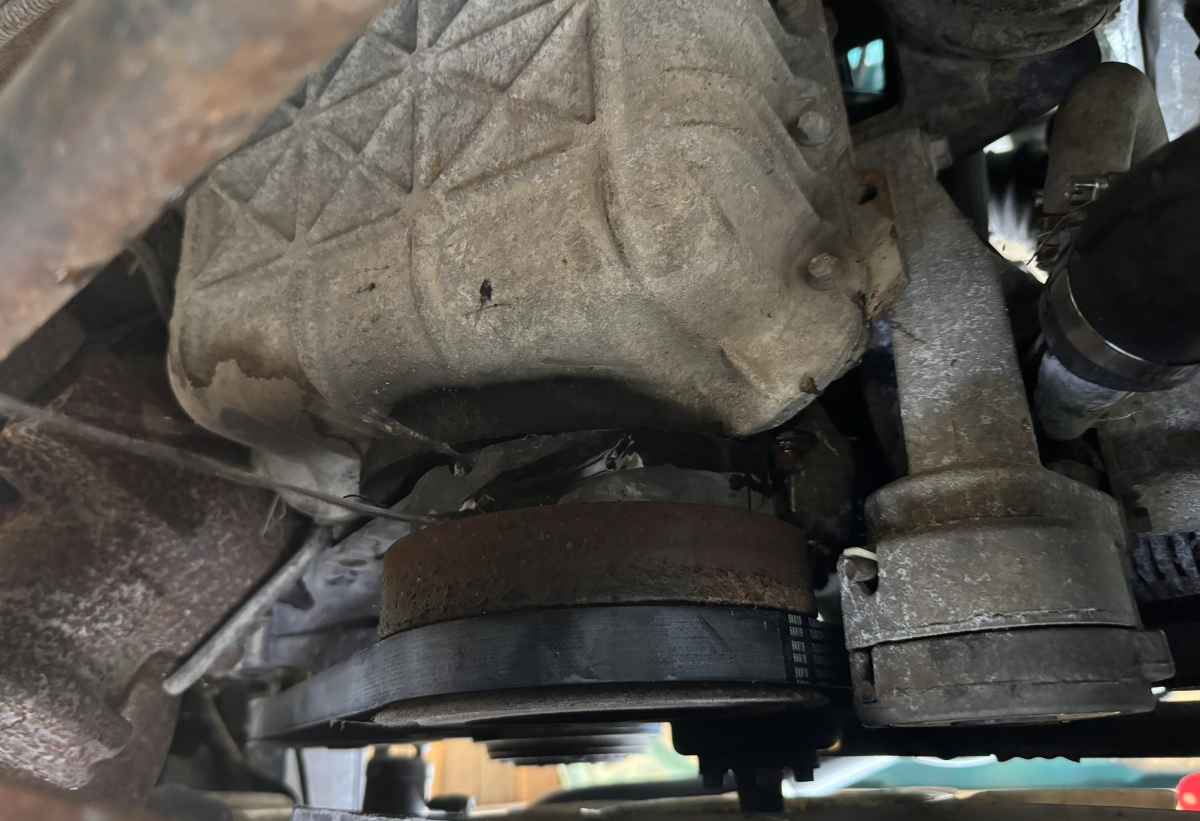

@scotts90ranger I poured more water into it this morning and got a pic of where the leak is coming from; it seems to be leaking from around the center, rather than from above the rad hose. It almost looks like it's coming from within the timing belt?

Looks kinda like it's coming from the side of the lower hose, look close up 6" above the hose connection, the water pump is about the only thing that has coolant there...
The water pump inlet deal "shouldn't" need the water pump out to change but that depends on how well it goes... doing the water pump on my '97 is on the short list after a few big projects...
Not to sound totally stupid, but would it leak from there without the engine turning over?
Since it's plastic and if it's broken after you worked the lower radiator hose off then on I could sure see that happening, it's about the only thing that makes sense unless your thermostat housing rusted out and broke from replacing that hose... but the thermostat housing is steel and the lower hose housing is plastic or fiber reinforced plastic of some form...
So i realized that I didn't put a gasket into the thermostat housing when I replaced the thermostat so I'm wondering if that's it. I got a gasket and the liquid gasket silicone; will advise once thats rectified
