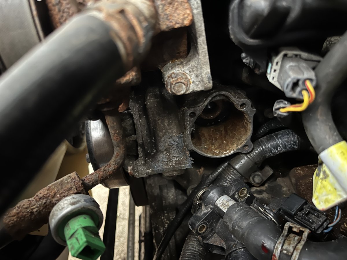

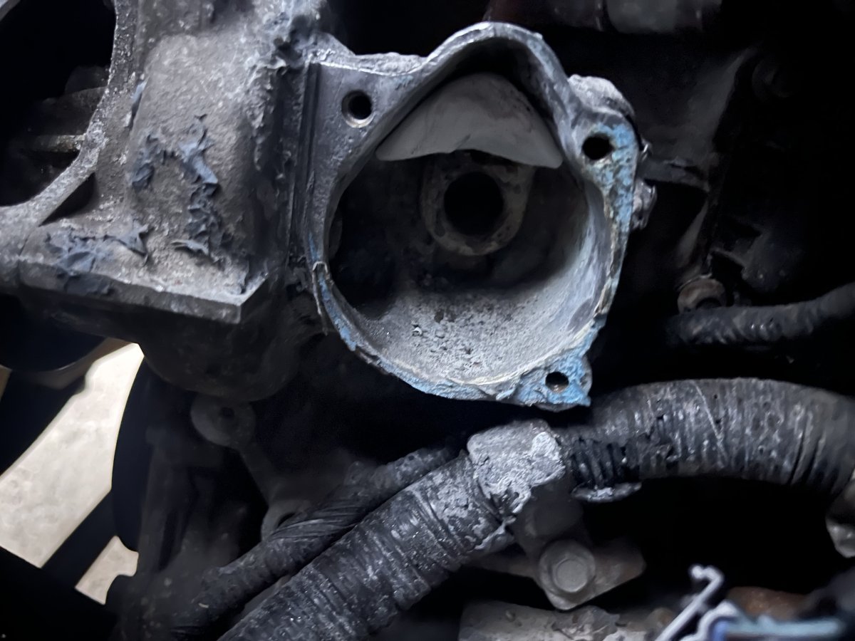

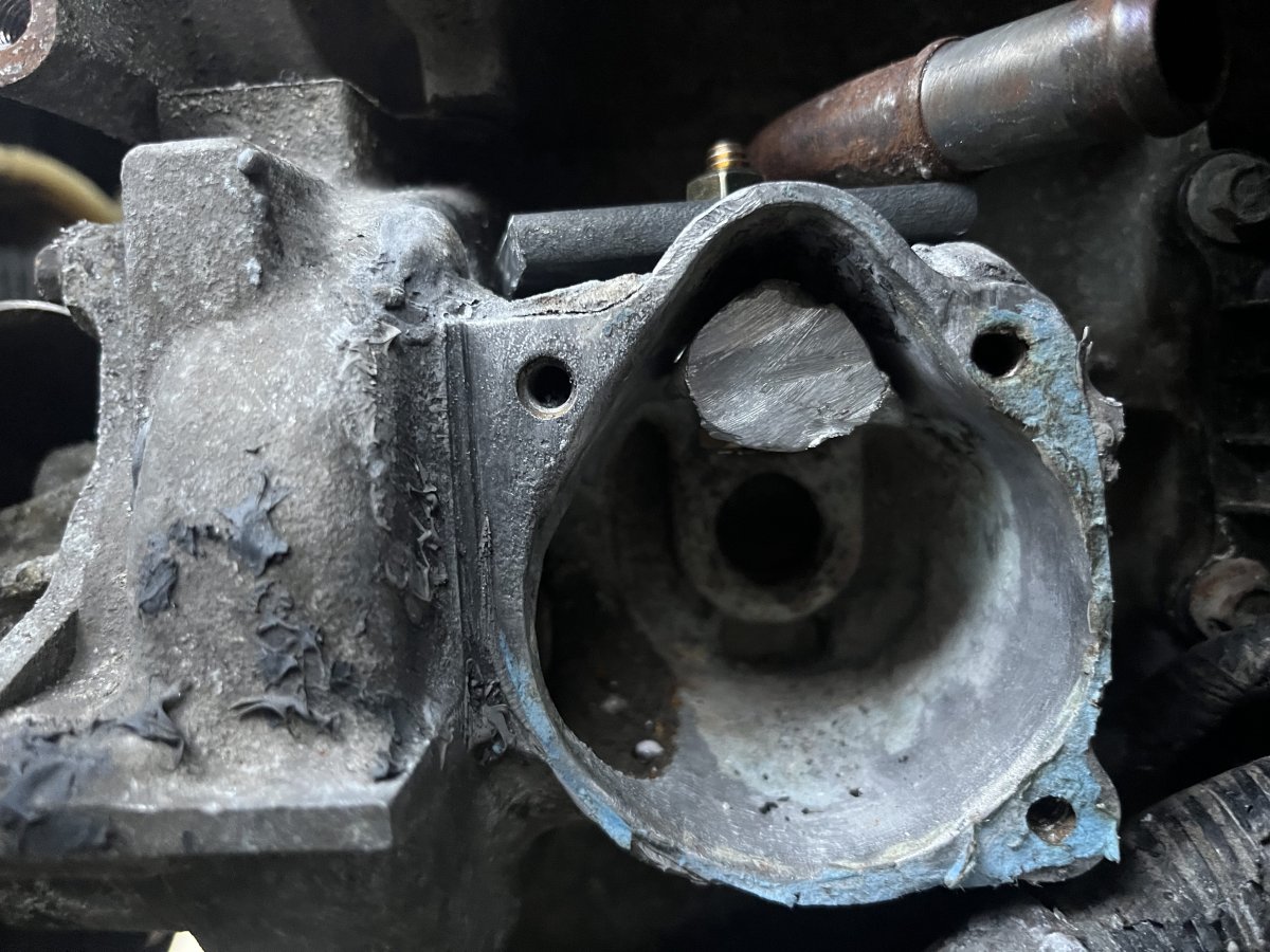

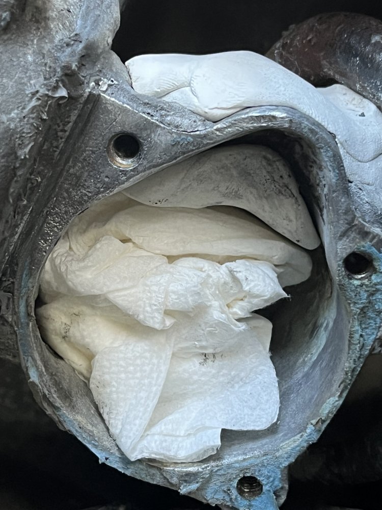

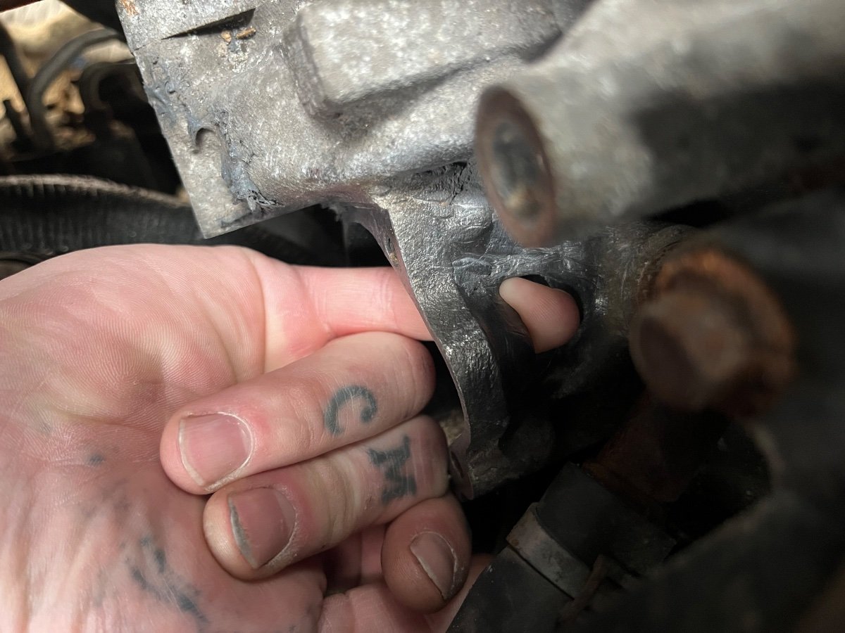

So i found the problem. They ran stop leak i think and erroded the engines cooling passages. Just when i think it cant get any worse, i get a hair brained idea for repair

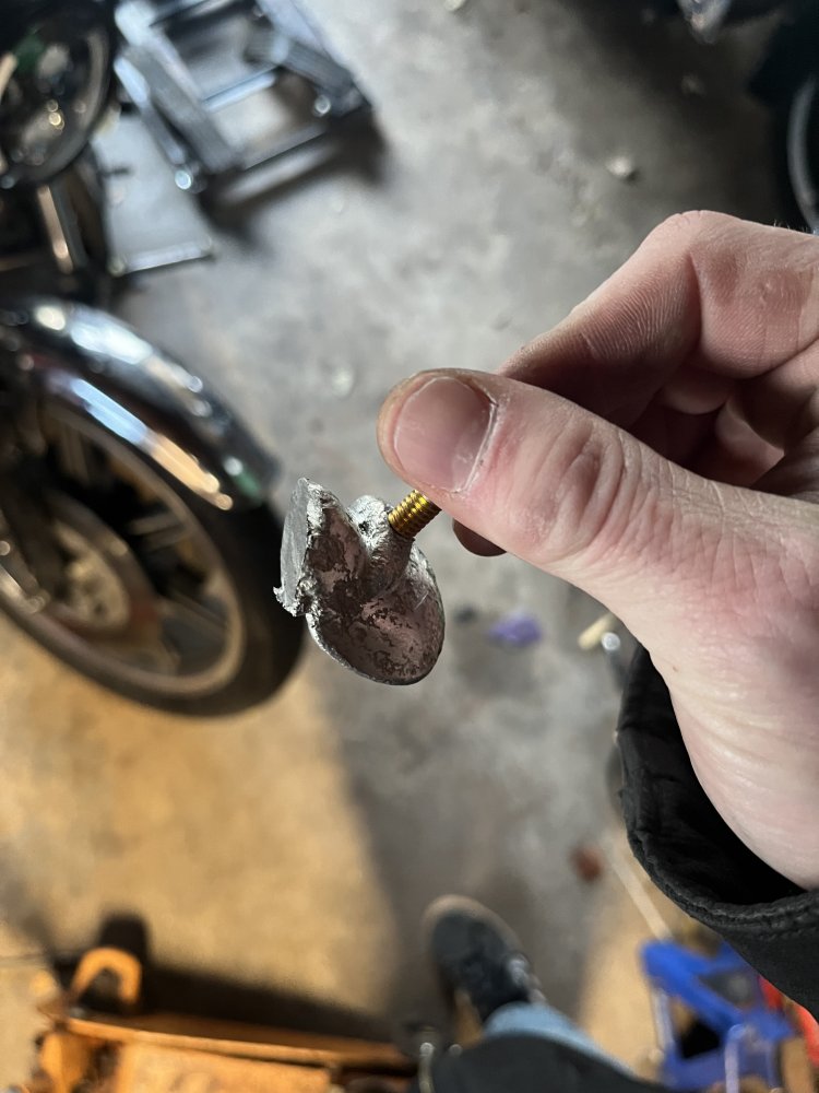

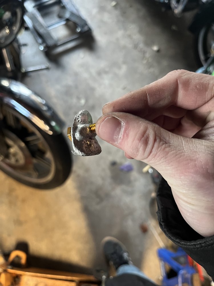

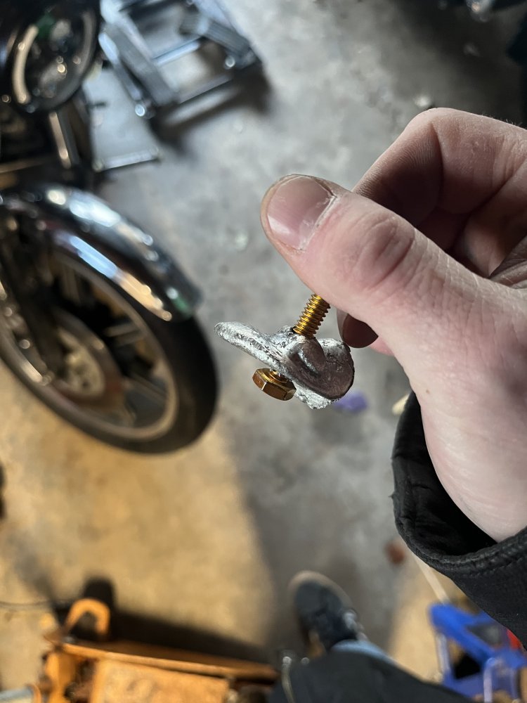

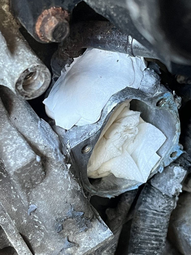

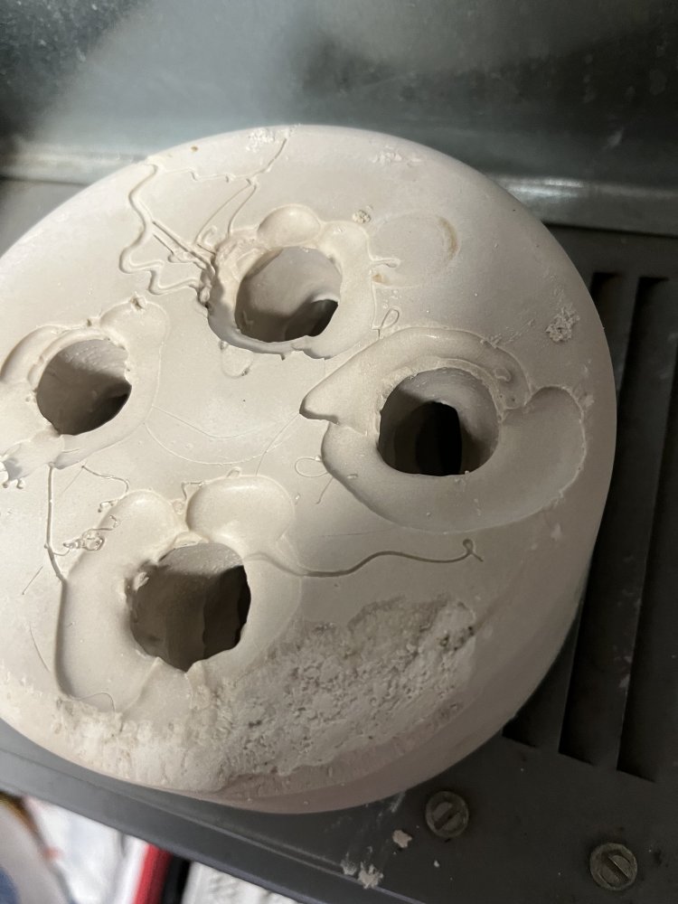

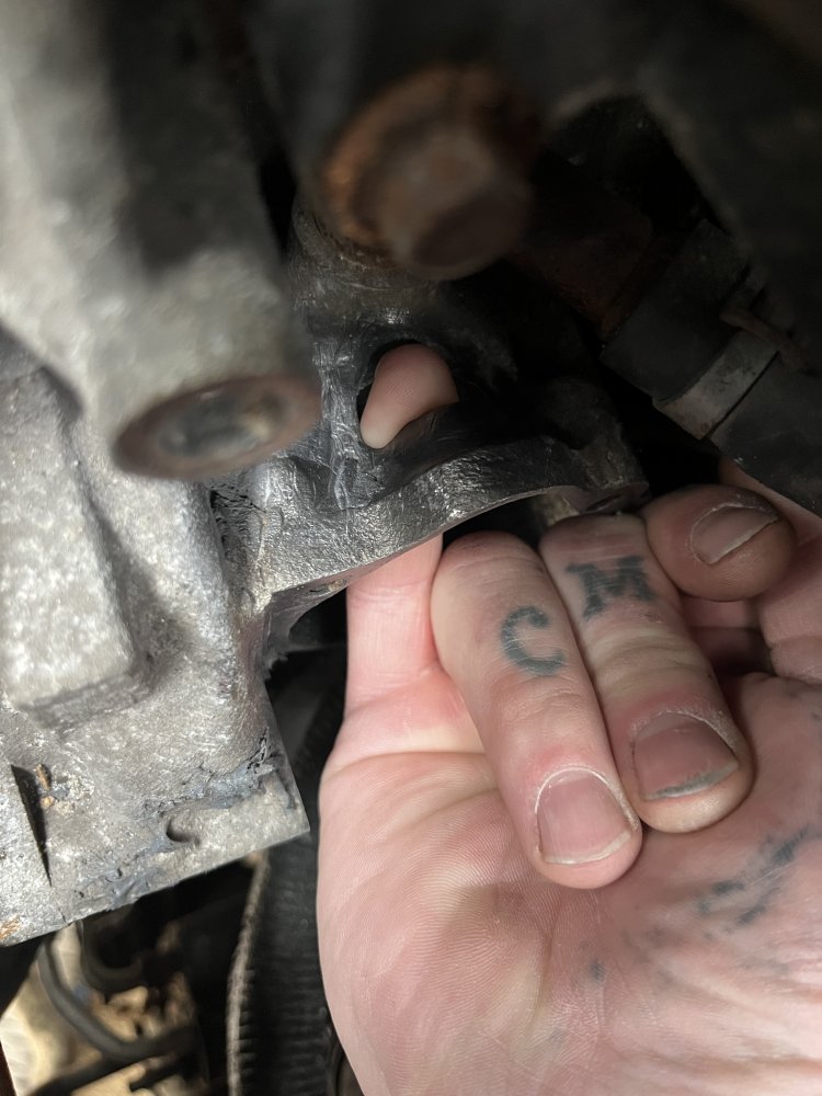

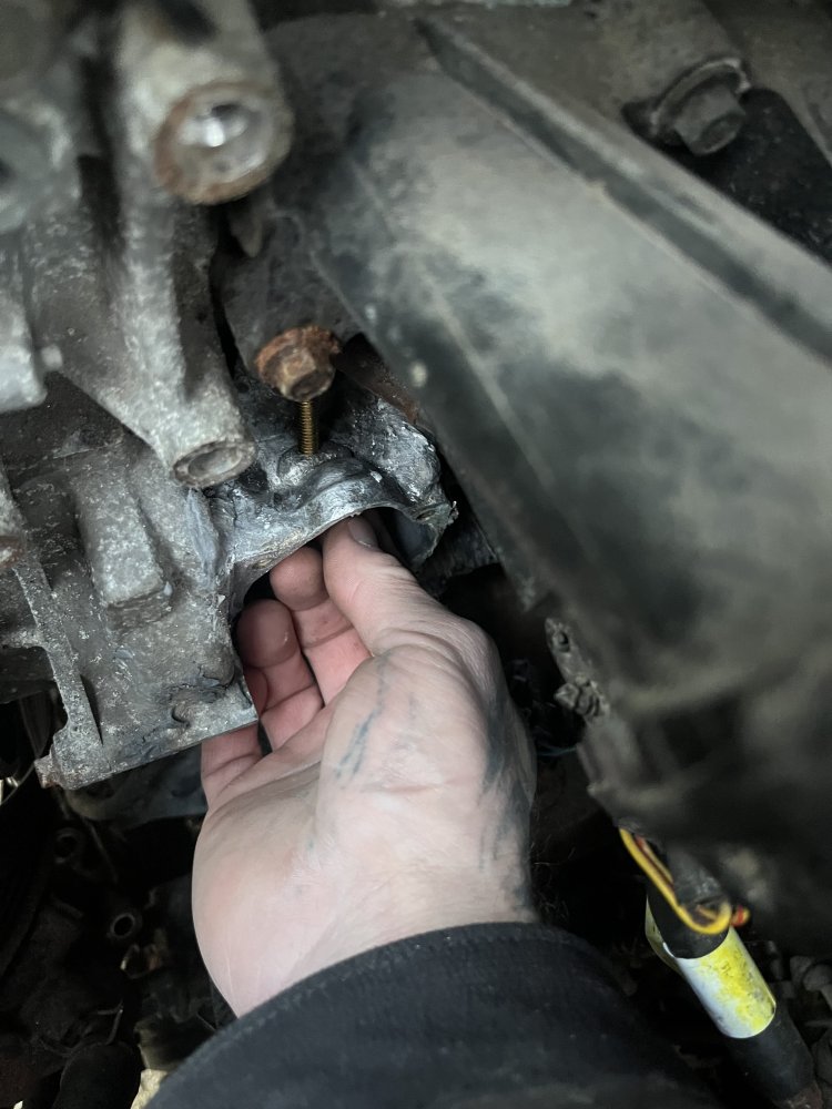

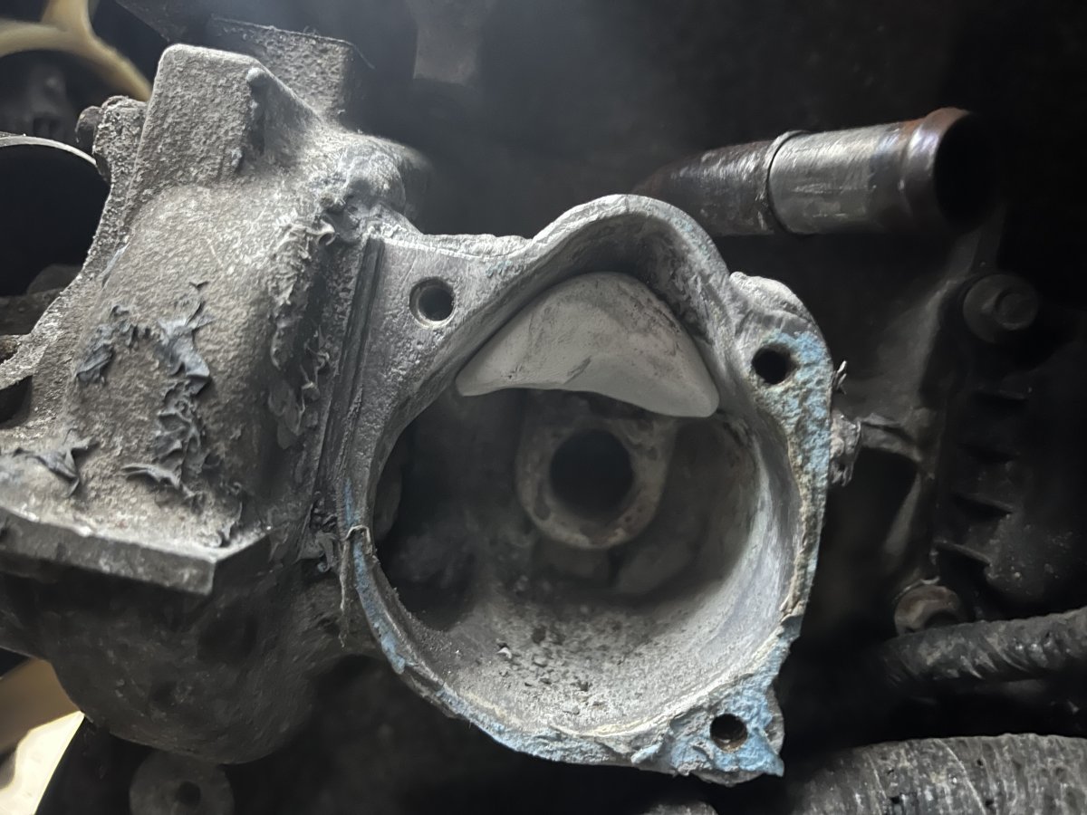

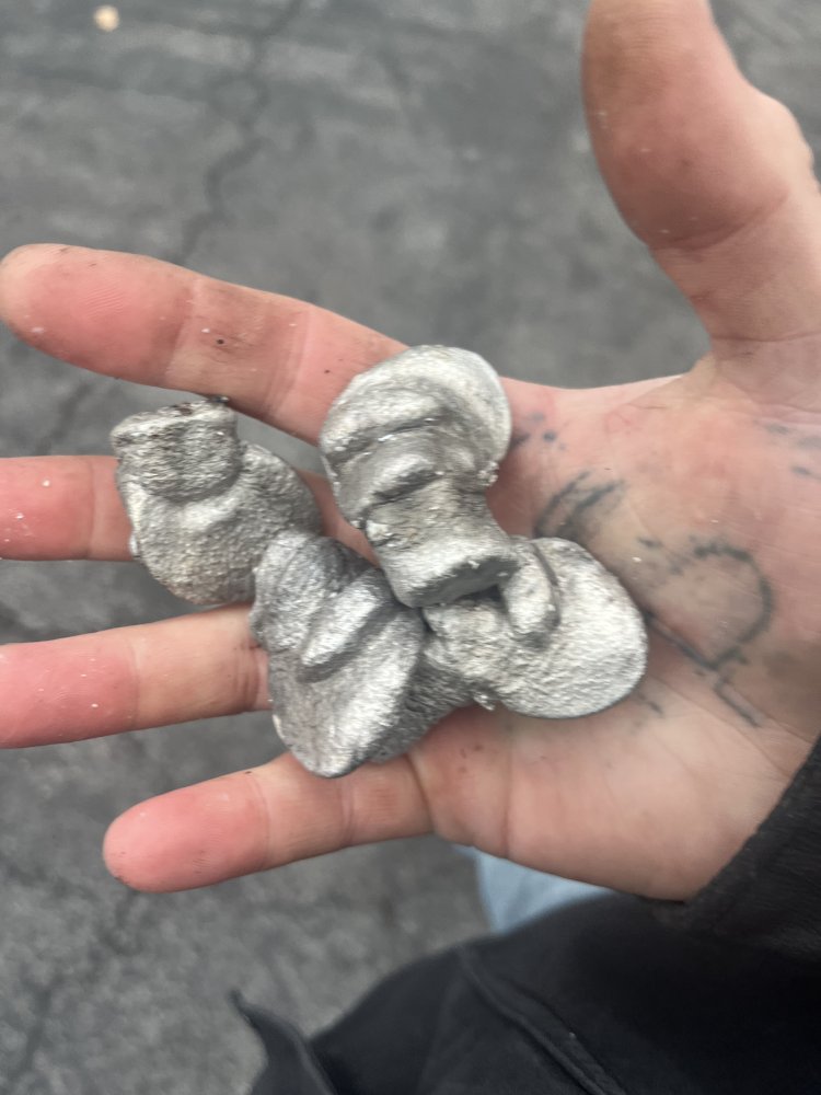

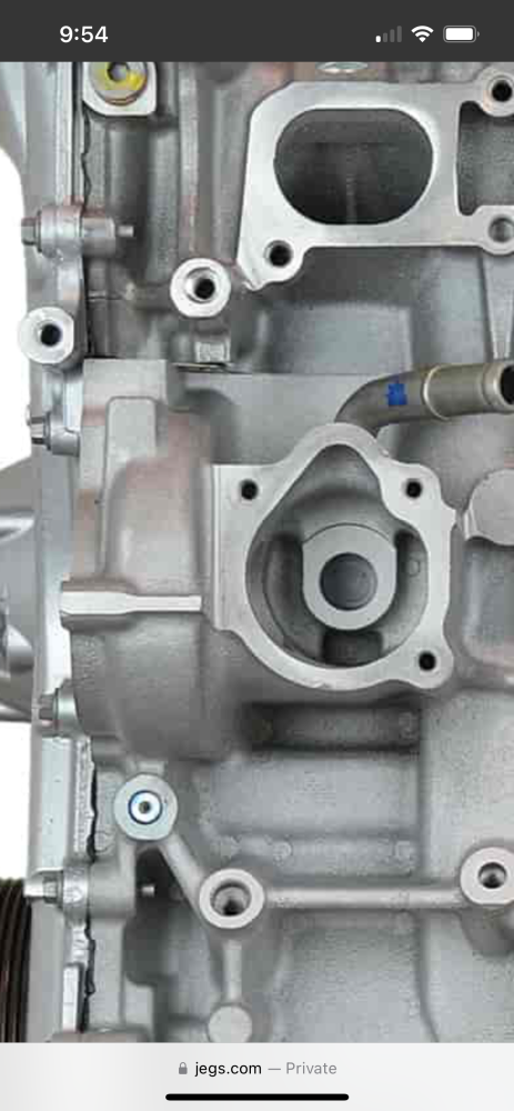

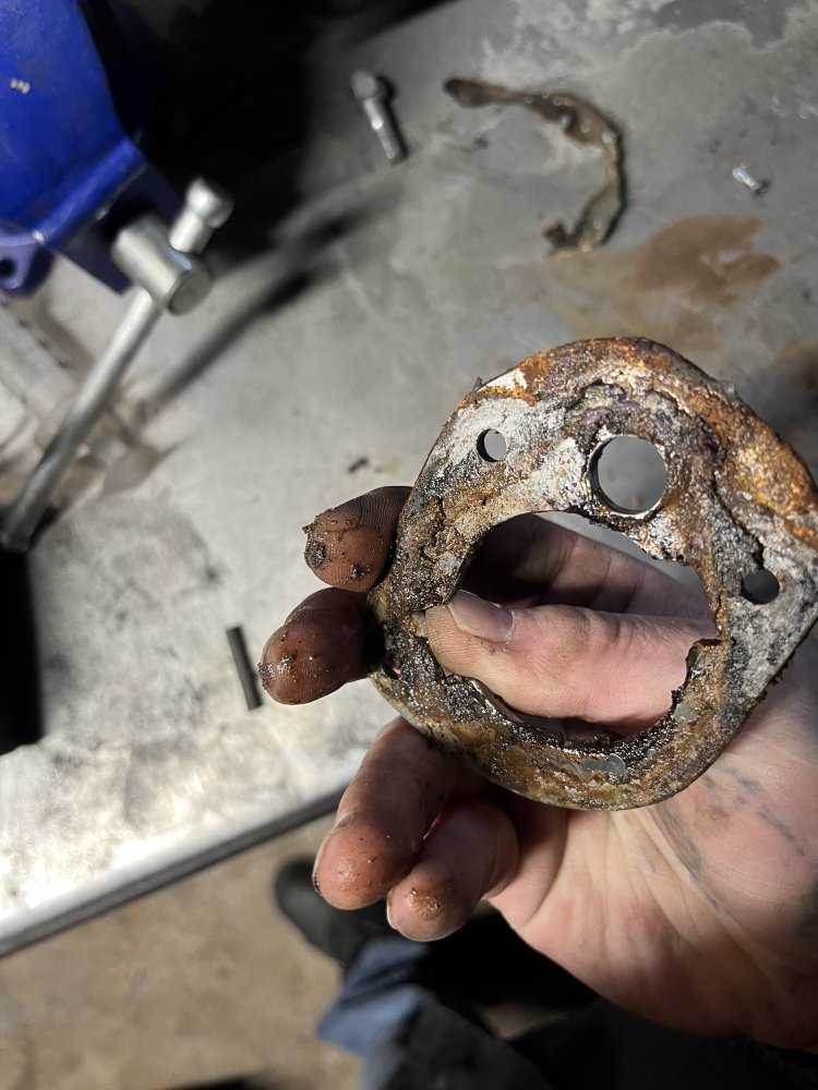

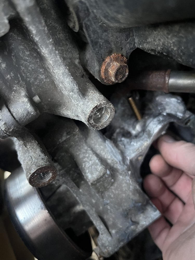

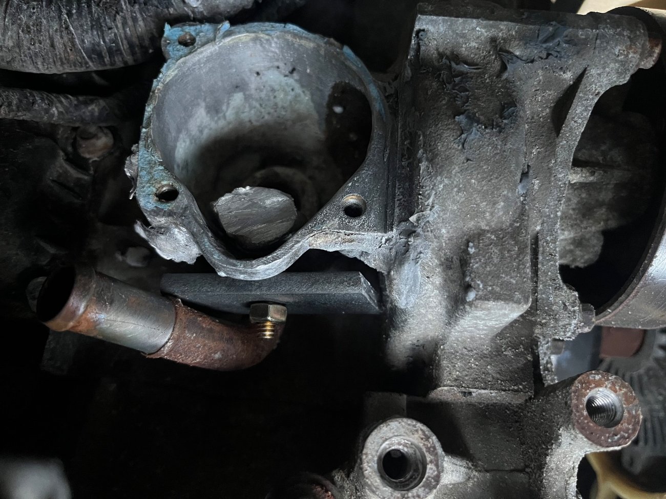

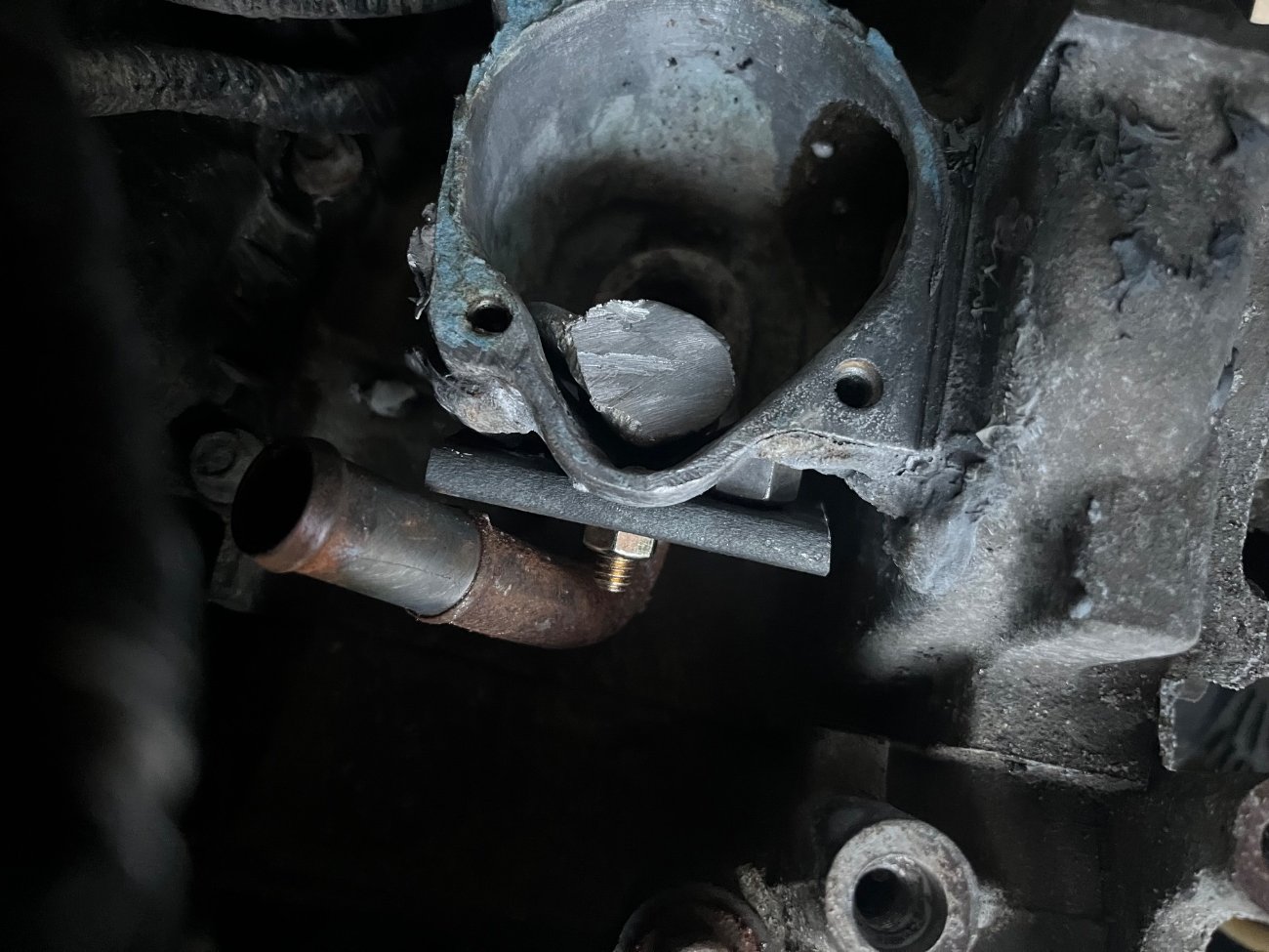

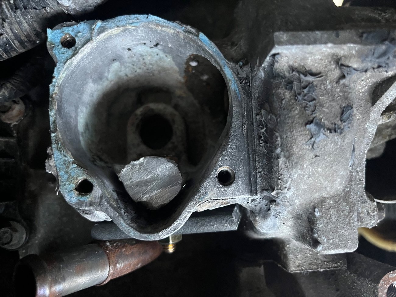

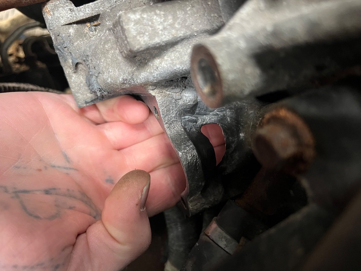

I went as far as to make a clay casting of the damage, made lets call it, an internal plug. I made a few molds and eventually was able to plaster cast my plug with aluminum. I made a bridge of sorts to hold the plug into place. It works of course…
