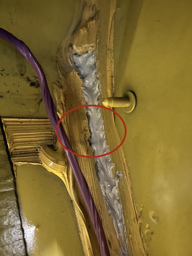

Passenger's side: I removed the fender to access the area. My leak was coming from a body seam. It is in a lower area that has three seams coming together. I chiseled out the interior factory seam sealer and discovered the discolored area. I went from the outside and pushed some new seam sealer in that area. I noticed that is squeezed in to the interior and sealed the hole. I then sealed the interior as well. I removed the factory foam pieces. They where distorted and I am thinking that they might have been adding to the problem.
I circled the area where the three body seams join.
