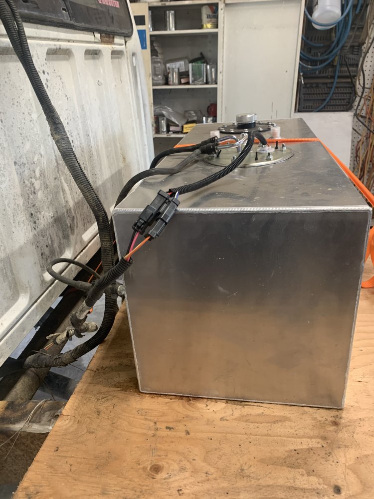

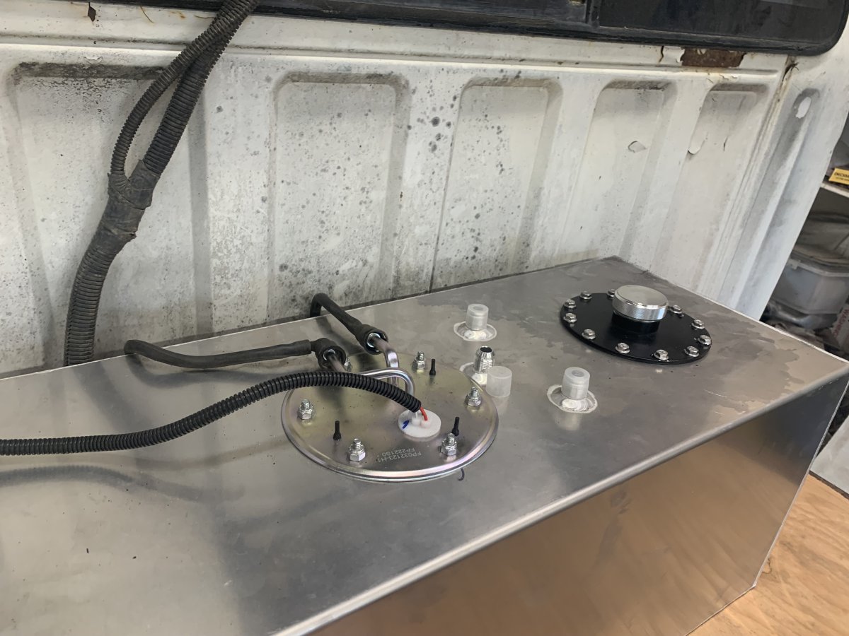

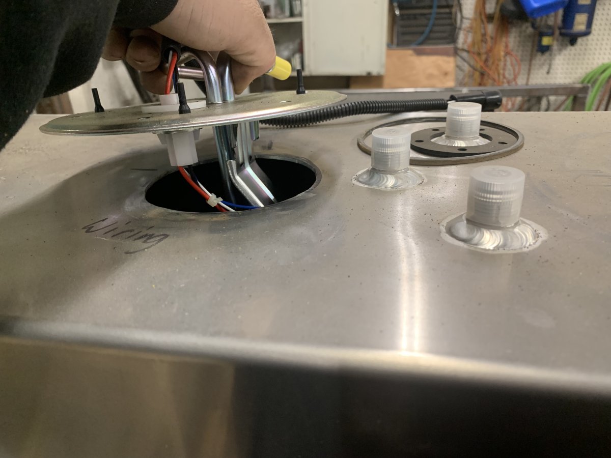

When I was looking for info on this. It was impossible to find info on it. This is what I did. I bought an amazon 19 gallon fuel cell, a 1999 F150 fuel sending unit and pump.... marked the fuel cell and drilled out for a bigger hole. The F150 fuel sending unit bolts in. Gasket is on the fuel pump. Used nylon rigs on the bolts to seal them. Fuel lines plug right into my 91 fuel lines. I had to change the plug. The fuel gauge works as it should. fuel cell is 12"s tall and the fuel sending unit is 11.5 inches tall so you pretty much can pull from the hole tank.
