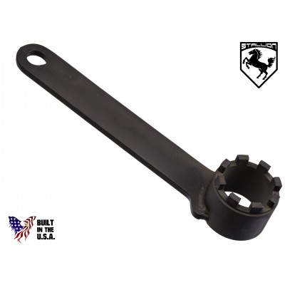

Something you also need is the rear jackshaft sprocket tool. I didn't use this tool the first time I did this job. I just used the camshaft locking tool in the OTC tool kit, and tried to hold the front bolt. I'm not positive but I think this is what caused the camshaft failure minutes after startup on engine #1.
The tool is kind of crappy because it's not long enough for the amount of torque required. You can manage with a cheater pipe or blocking it against the engine stand.
