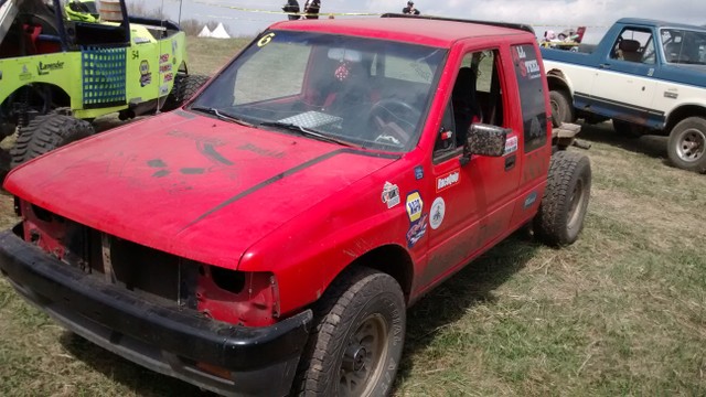

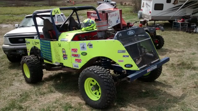

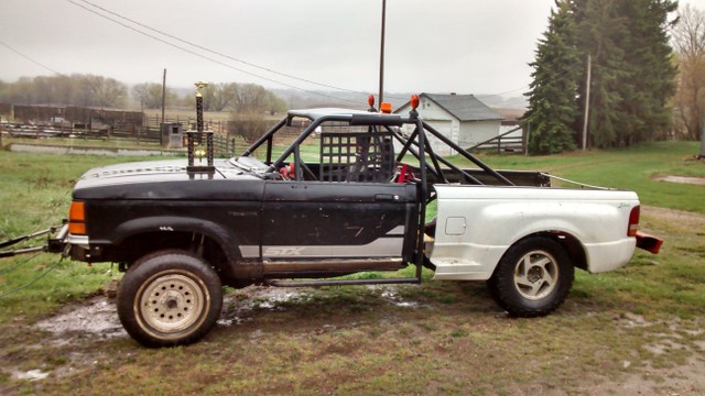

First...the pic to prove I got a trophy;
alwaysFlOoReD's race truck
I wasn't sure if I was going to be able to make it to the races as I'm in the middle of moving my shop. I have a LOT of crap!!! But I decided that I could take the time so I did a quick check of the front bearings and looked for loose bolts and hooked up my tow bar. My 2004 f150 5.4l was bought with a known cam phaser problem which I have temporarily fixed by running thicker oil. Well, it seems that now is the time that it decides it has had enough of the thicker oil and starts running like crap. I pull over after 5 minutes and decide to go back home. Two minutes after that it starts running good again.....WTF! So now I turn around again and head off on the 200 Km trip to TORE - Total Off Road experience, an offroad park south west from Edmonton. I make it with no further problems.
The drivers meeting is supposed to start at noon and like most [all] races I've been to it's late, by what seems like hours. I have bad knees and standing around is one of the worst things I can do for pain. Flop my butt on the ground and start cloud watching...
The way this series is run is a combo of points from side by side 200 foot sand drags, doubl knock out, and a slalom. I seemed to be a little quick on the trigger [tho the wife never complains] and red-lighted the first drag race, won the second, and lost the third. Again it seems the truck is working good, just the driver needs tuning.
In the slaloms you are racing the clock. You get two runs per day. I posted a 1:07 and a 1:05 for the Saturday

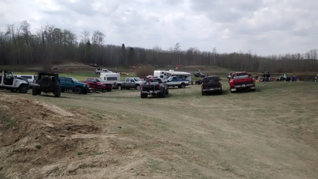

More pics of the site and race trucks and spectators trucks;

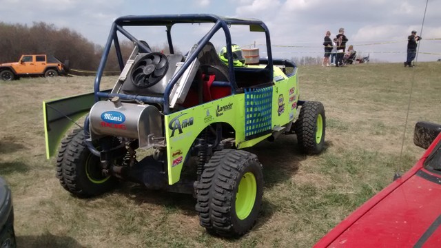

Random pics;

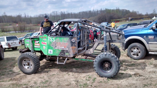

My version of a multiranger; 1st gen bumpers and stx lift, second gen cab and front, third gen box-sides; lining up for the drags;

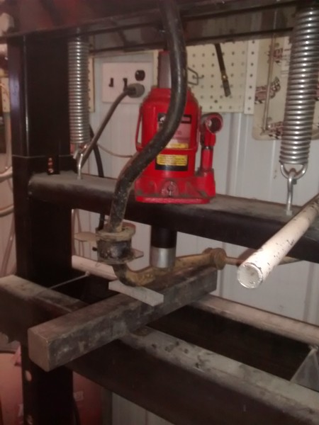

In the 20 ton press;
And after straightening the arms;
I needed to move the eyes in ~3" each side to fit the ranger frame. I think I've got it close and will be installling it tomorrow. Right now it's snowing and I don't feel like sweeping or shoveling.

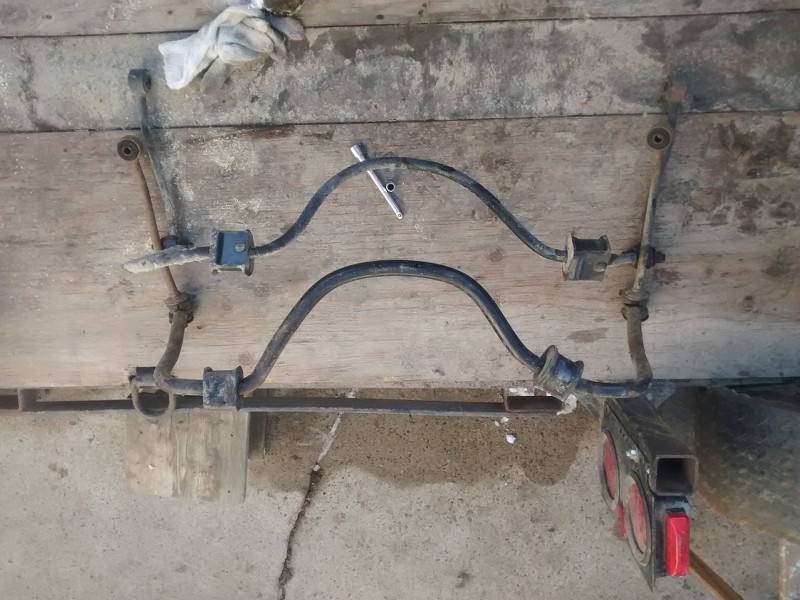

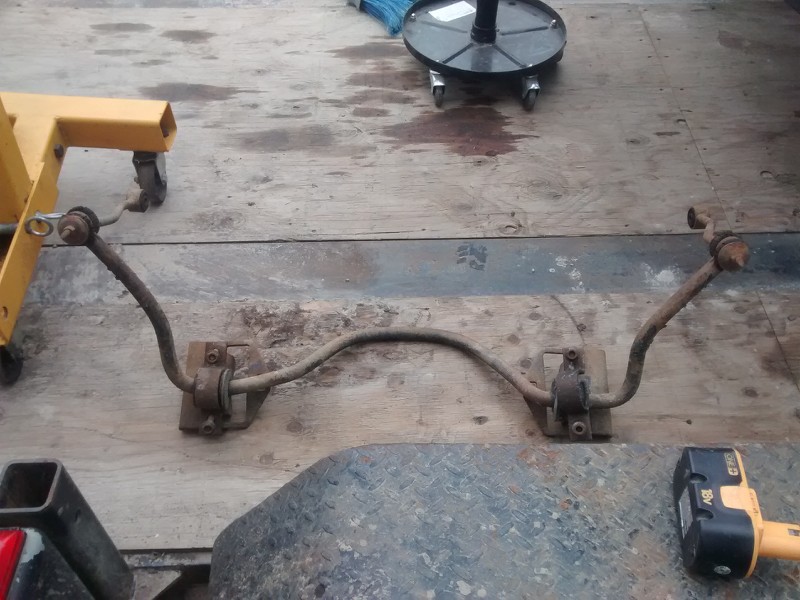

I installed the new swaybar today. It slid into place fairly easily. I'm no longer using the stock shock locations but it looks like stock shocks would clear.
Some more pics. First is a comparison of the stock 91 5/8" bar and the 97 f150 7/8" bar;
[/URL][/IMG]
The arms are the same length and the rubber bushings fit either bracket. However the end of bar is different so you have to use the links that come with the bar.
The last pic is of it installed;
[/URL][/IMG]

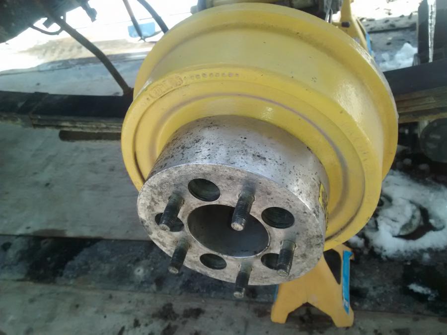

Also dug out my 2.5" spacers I bought last fall. Paid 100 plus shipping. $30 for lug nuts.

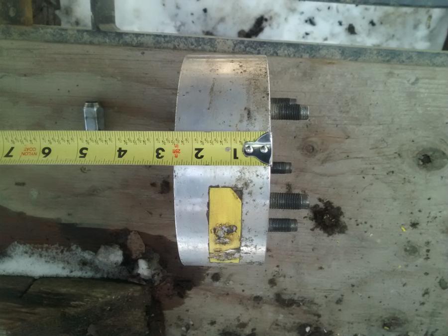

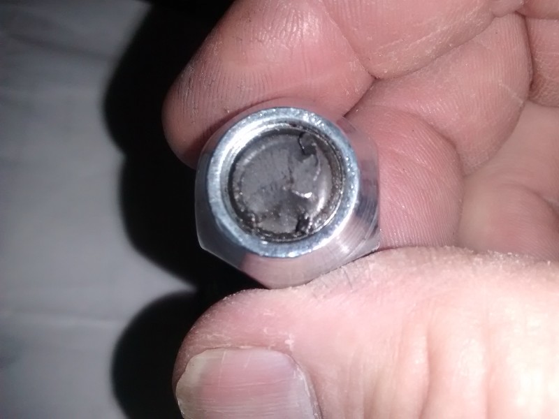

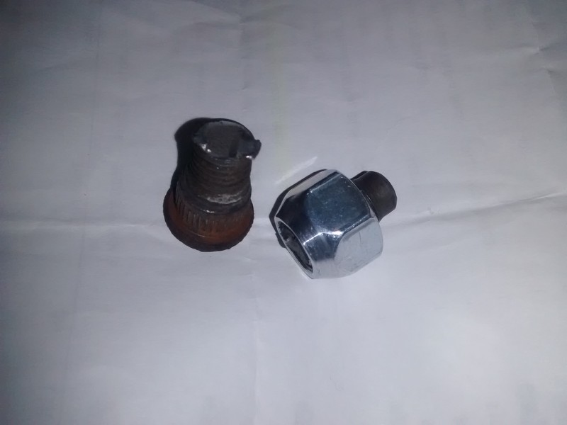

I needed some wheel nuts to attach the 2 1/2" wheel spacers. I bought 20 @ $1.37 each....ouch! When I went to install them I had a little problem when I went to torque down the wheel nuts;
Well, I guess it's better that it broke now than when I was on the track. I went and bought 10 new wheel stauds @$2.67 each.....:annoyed:

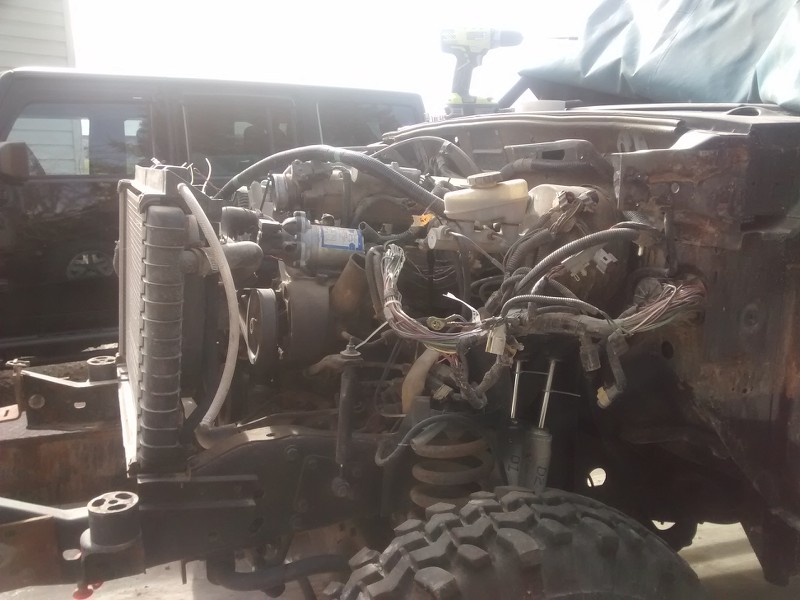

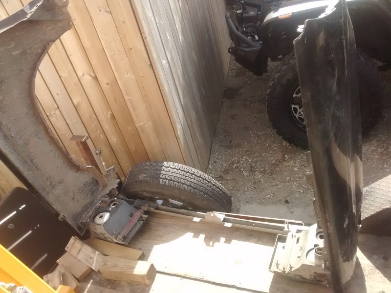

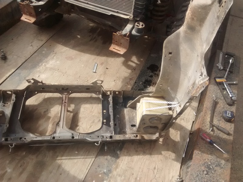

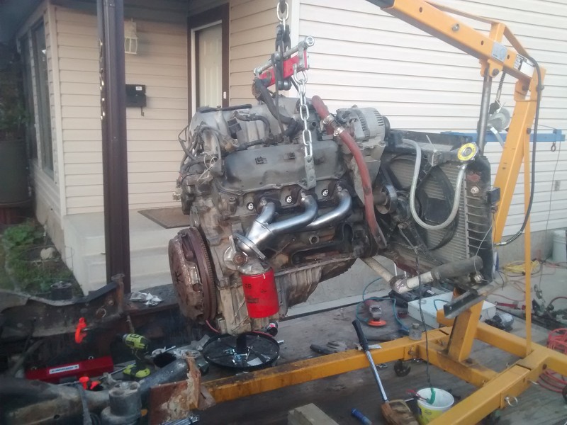

Finally was able to do some work on the truck again. I need to seal all the oil leaks. I was heming and hawing on whether to swap motors with another I have that was running good, but last time it ran was 3 or 4 years ago. I did a compression test on this one and it came back good - between 150 to 165 psi. i decided to stay with a known motor and just seal the leaks. So I removed the front clip in one piece;
and then unscrewed the inner fenders from the cab. I had previously removed the rad support and inner fenders after a wreck and screwed the new one onto the cab using self-tapping #8 x 1/2" panheads. I was a lttle surprised that only 4 screws had backed of from the 36 that I used.n Those screws and the two front body mount bolts were what held the front clip on.

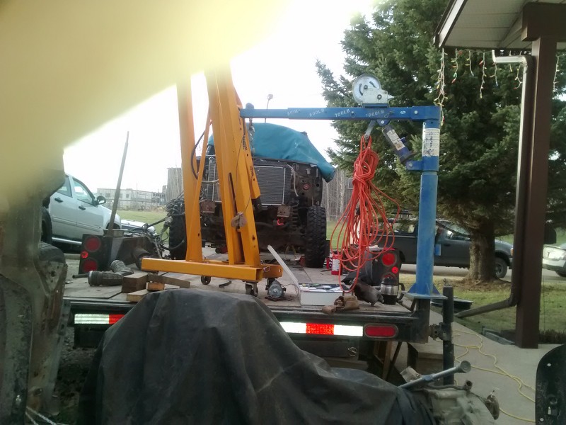

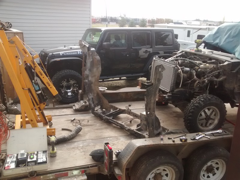

I got all the wiring moved out of the way and disconnected everything else needed to pull the motor except the fuel lines. I'm going to try to pull the motor with the rad attached as I don't want to drain the fluid, it would spill onto the deck of the trailer I'm working on and be sticky as a kids face after ice cream cake.

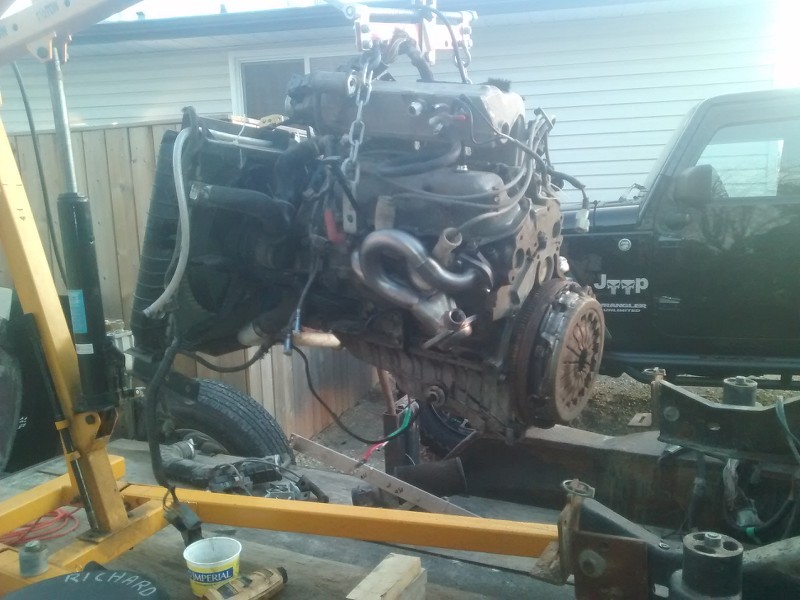

This 18' trailer has enough room to use my motor hoist so I don't have to work in the gravel. The fenders are a bit of a pain but nothing compared to working in gravel.
I'll finish up tommorow and hopefully have the motor back in and the wiring installed.
Richard

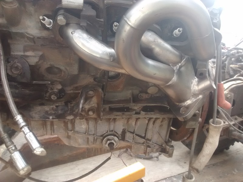

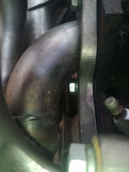

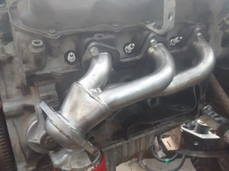

Over the last few days I have r+r'd the rear main seal, replaced the clutch, removed the exhaust manifolds and replaced with JBA headers, and replaced the valve cover gaskets. Also tried to clean the engine the best I could. It's ready to go back in and I hope I can get it to the point of running by 5 tomorrow. I have to be on the road by 6 to get to the venue to set up for the show saturday morning.
Some pics because;
This last pic shows the pain in the butt bolt. I don't know how someone would install that while the engine was in the truck;
