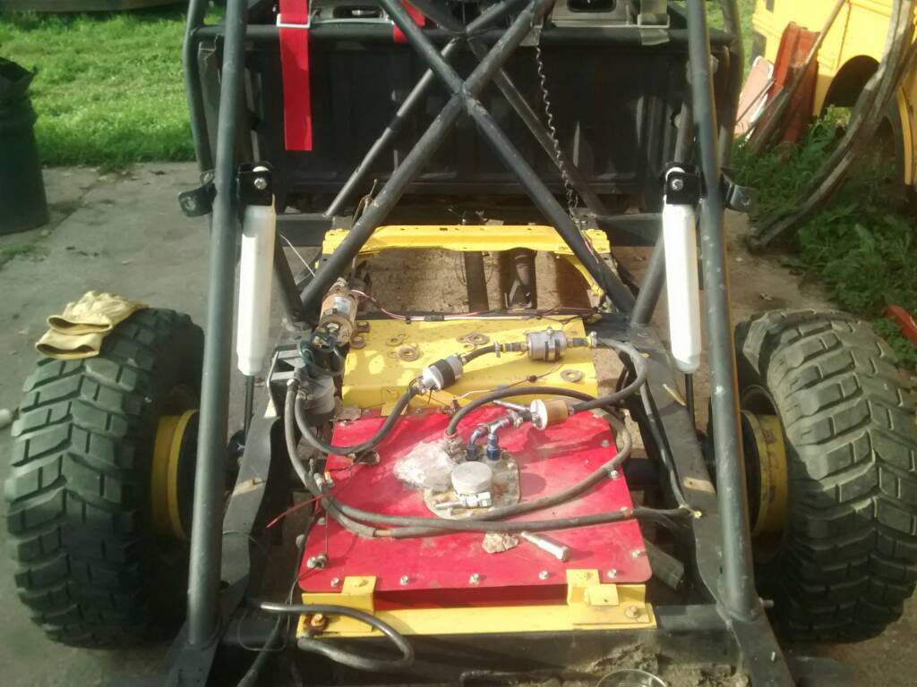

alwaysFlOoReD's race truck

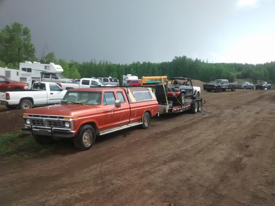

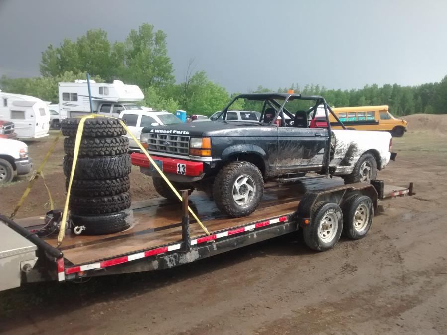

At the track this weekend. Passed tech, racing tomorrow and Sunday.

I got third in the drags. I'm not sure how I placed in the slaloms. 33 trucks showed up, about a dozen in my prolite class.
Sent from my XT1032
Today I got second in the drags and fifth in the slaloms, good enough for third place in my class.

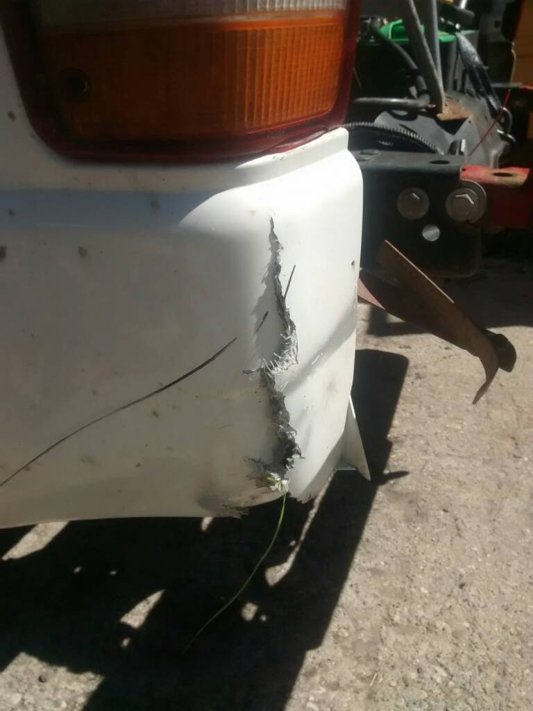

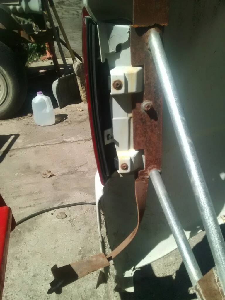

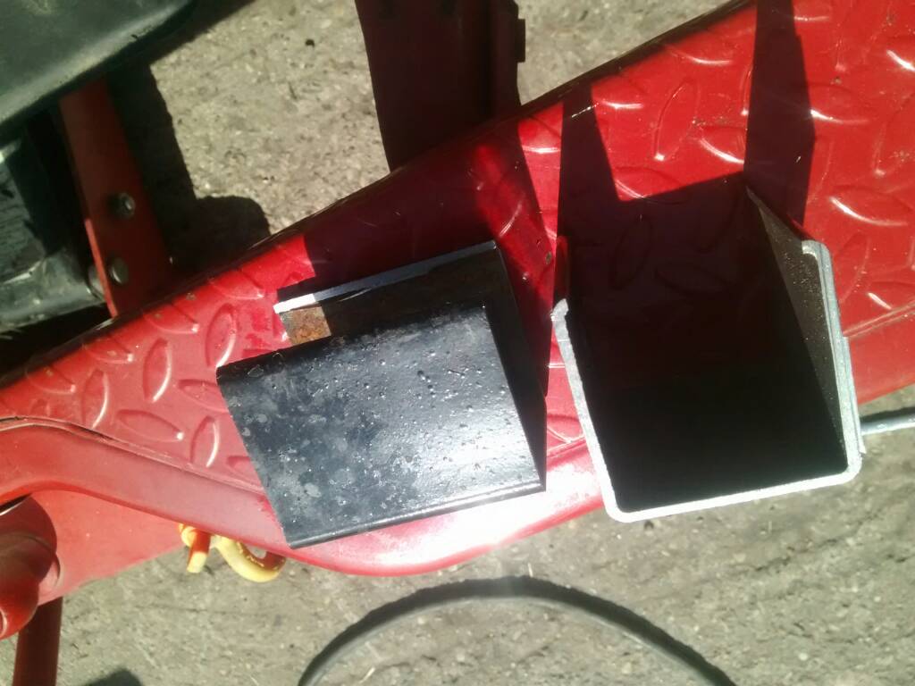

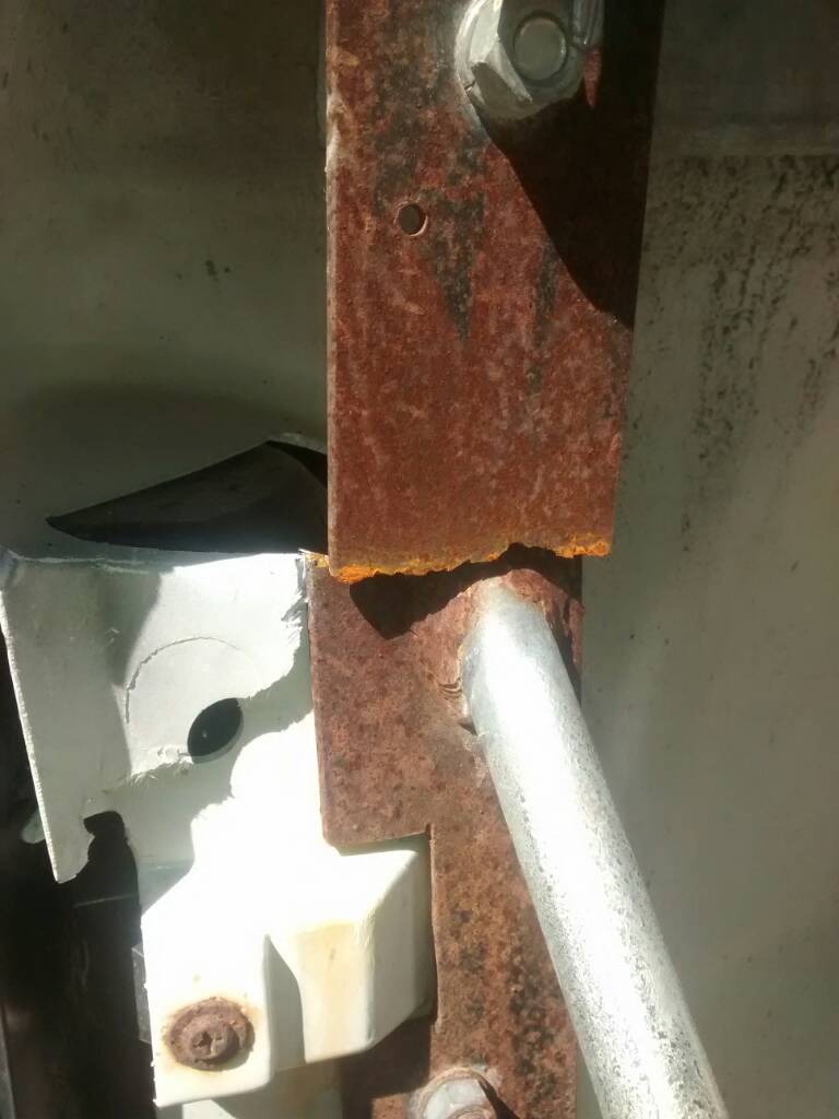

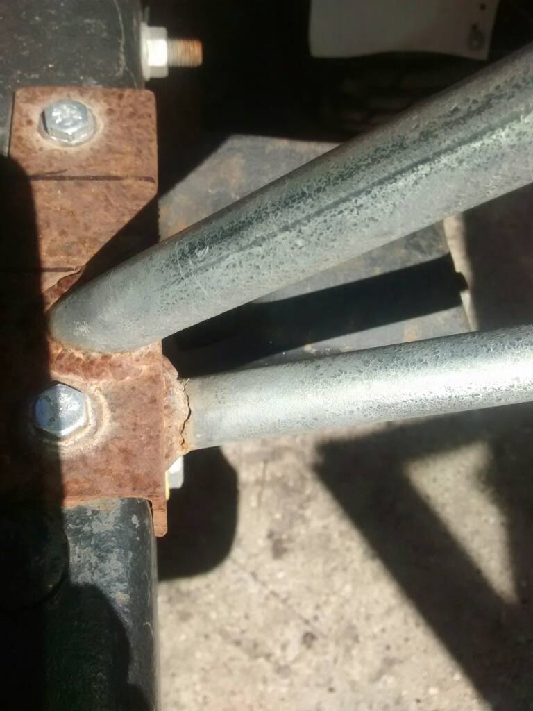

I've been doing some work on my truck for the last few days. As always I leave stuff to the last few days, as the races are next weekend. I took a pretty hard landing last race where I separated a ground wire. I also did some damage to the rear fenders. I decided to change the fender mounting to help prevent further damage.
Some pics;
As you see, I never painted anything when I first made this mount. I'll have more pics after the paint dries[emoji12]

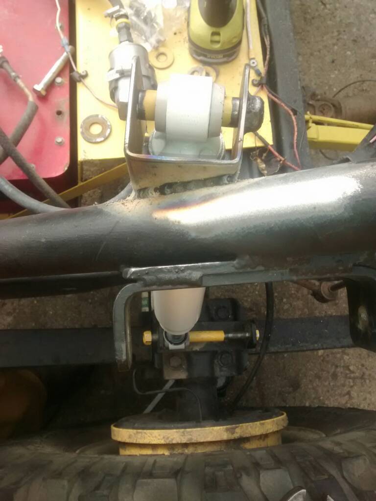

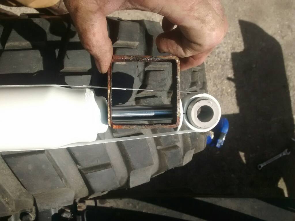

Another project I did was to change my shocks. I picked up some procomp shocks at 4WheelParts, the series main sponsor, and finally mounted them. This meant disconnecting the rear spring mounts and shimming the frame 2 3/4" from the axle, the same amount the shock protruded from the housing
This made a fool proof way of making sure the shock wouldn't be completely collapsed before the rubber bumpstops are compressed.
I used some tube that I salvaged from a trailer jack. It happened to be the right inside diameter for these shocks. I cut out a side and then drilled for the shock bolts. Instead of using the supplied shims, I made mine from 1/2" pipe. I cut to the correct length and drilled the inside with a 1/2" bit. This meant I could use 1/2" bolts instead of whatever stock ones were meant for this shock application.

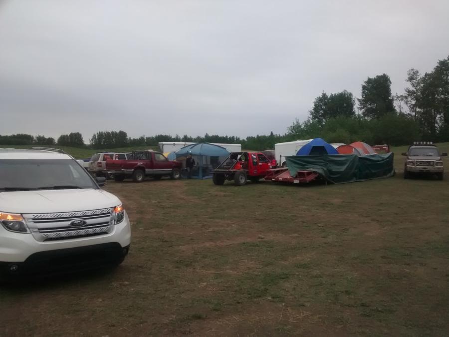

I got to the track last night under cloudy skies. Today its pissing. Forecast is 1/2" rain today. Part of the track is an old clay oval....can you say goose shit?
