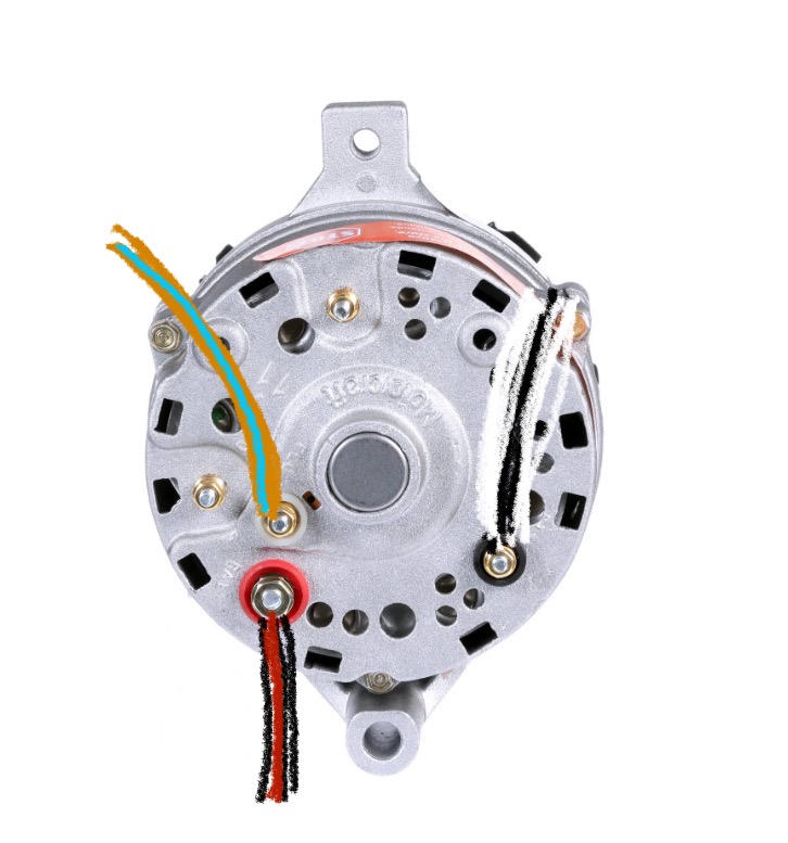

This is currently my wiring on my new alternator on my ‘83 2.0L gas ranger. It’s not charging still. Am missing the black ground wire to the leftmost post correct? It’s nowhere in the engine bay and I’m the farthest thing from an electrical guru, I tend to avoid it at all costs. I bought the truck not running and have gotten it running thus far with a lot of new parts and love but I think the charging issue is a lack of a ground wire on the alternator. Could anyone confirm and possibly send a picture of their ground wire setup? I have seen the charts and diagrams and they are hieroglyphs to me for the most part

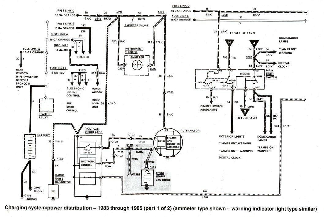

Did you get the right alternator? The diagram shows alternator on an 83 is grounded through it's frame to the engine block.

Sometimes the alternator case isn't enough of a ground for the alternator to ground, adding a ground to the ground post on the alternator isn't a horrible idea... Some alternators just have a charge wire, others have an ignition wire, others have a sense wire, some are expecting a charge light that has key on power on one side and the alternator will ground that with the engine off and put power to it when on turning the light off.

That's all true. But we are talking about his 1983 Ranger, which should theoretically be wired according to the diagram I linked.

I believe it’s hooked up right then, I just cleaned the ground point and it didn’t change anything, still only reading 12.65 V on the battery and alternator with the engine on

I tried grounding the alternator and that changes nothing so I don’t think that’s the issue there. Wire from battery to alternator seems to be okay, it is reading 12.6 V at the alternator. Not sure what else to do
EDIT: thinking maybe the module in the distributor went out?
12.6 at which post on the alternator? The one to the battery or the one to regulator?
UPDATE:
Yellow wire to voltage regulator was the issue. Charges like shuffling socks on a shag carpet now! Thank you for everyone’s help and suggestions. Got her to the gas station and took a ride around town for the first time today!

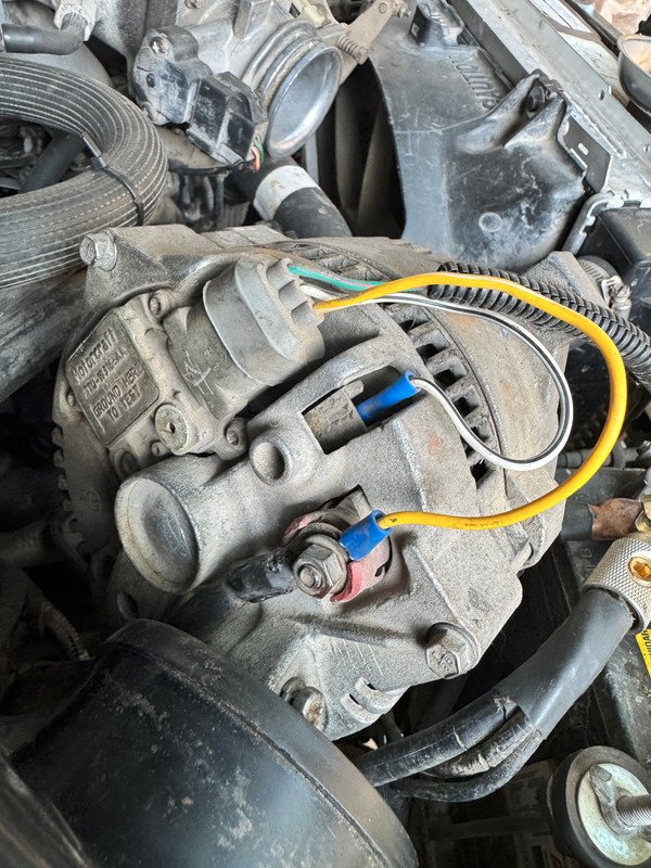

Any pictures? I think I’m having the same problem on my frame off build on my 1988 ranger
Here's a pic of the wiring of a ford 3g 130amp alternator on my b2 :)
