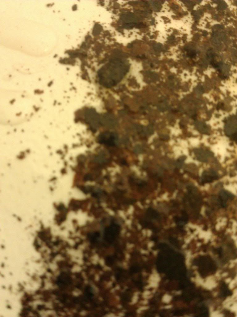

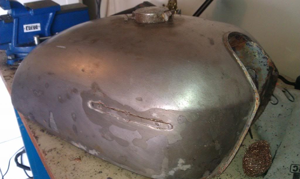

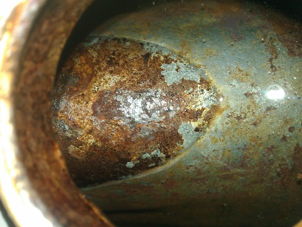

Kleen-ed the inside of the tank. Carbs kept fouling/gunking, and I threw screws, nuts, bolts, & washers in with 4 gallons of vinegar for a 3 days. Shook, dumped, rinsed, then coated. It's unbelievable how much rust came out. Seriously, I continued to be amazed with each additional shake how many clumps kept falling out.

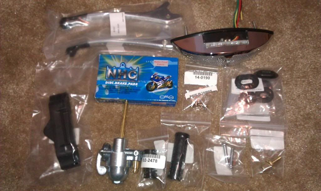

New parts!

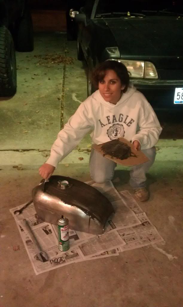

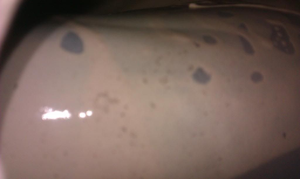

After seeing the rust, I wanted to make sure it hadn't rusted a hole in the tank. Stripped, cleaned, glassed & Bondo'd, primered, & rattle-canned painted tank here at home. It's currently being wetsanded, and given a proper coat of true white by my bodyman. It had 7...SEVEN layers of different colors of paint (one could have been primer though). Maybe that's why he kept repainting it...he didn't know to use primer?

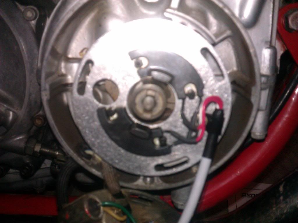

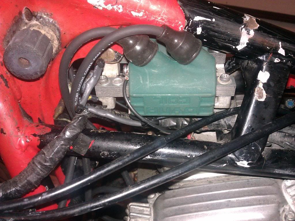

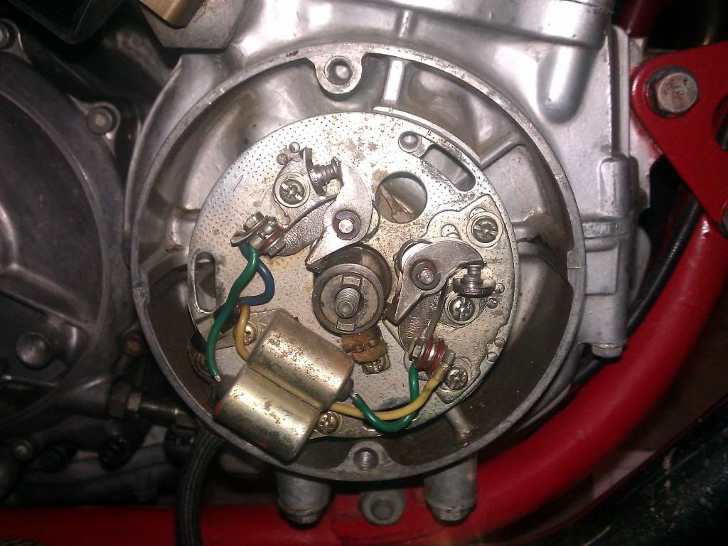

Upgraded to Dyna Coils 3 Ohm and the Dyna S igntion (cheaper setup, not the $350 ignition). How do I advance/retard the timing with a magnetic pickup, as opposed to the contact points? Rotate the assembly, right? I am unsure how to get it correctly in sync. I checked my Chilton. I guess I'm stupid?

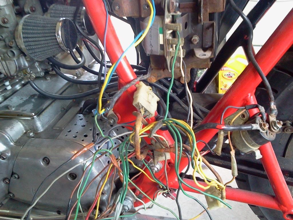

Made a practically new harness from scratch in most areas with 18 GA from O'Reilly's. It had frayed & burned small wire (over 20 GA) from previous owner. Color coding / wire diagram is consistent. (except for brown, don't have that spool color). A black wire was twist-tied to a red wire, capped to a yellow wire, electrical taped to a white wire! This was everywhere!

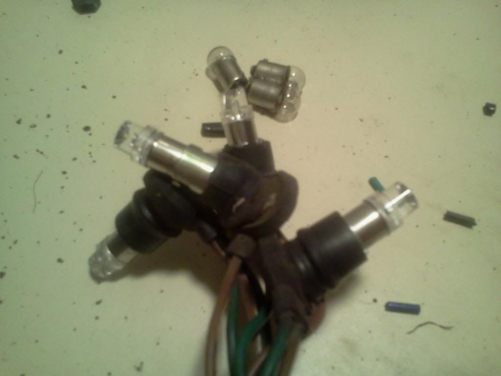

Reconditioned/cleaned up tach & speedo. Added LED SAE #57 / A9S bulbs from SuperBrightLEDs.com. $2 each. Each stock incandescent bulb draws 3 amps current, IIRC. Each LED draws 0.25 amps.
After 10 bulbs...2.5 amps is SUBSTANTIALLY less than 30 amps on this old charging system. I've read on here that this is a problem, so I decided to go this route. It actually lights up now, too! It's a nice white background with a green tinge (from the face) on the gauges.

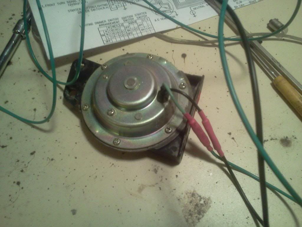

It didn't have a working high beam. Fixed that. Also, fixed horn & diaphragm. Needs to be louder if I want to be heard at 70 mph. Re-soldered connections. I have a horn now! Woohoo!

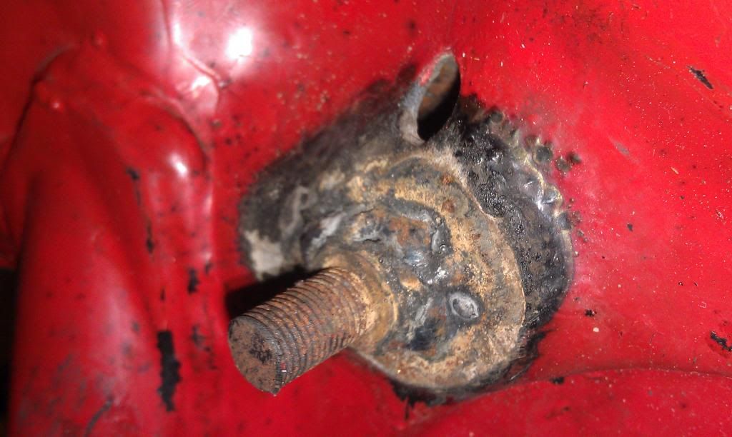

My lower tree clamp was secured with the below attached, solo, copper bolt that was stripping out. It was missing other bolts! This only one left could have dislodged while riding.
I have also discovered that random SAE/STD bolts are being used, and that suspension components are being used with varying nuts sizes (10mm, 12mm, 1/2" all on the same part). 10mm nuts should probably not be used on suspension components, just saying.

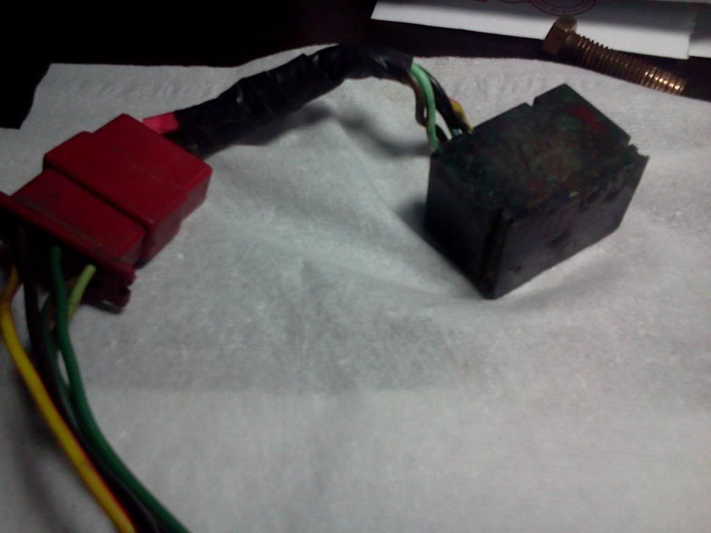

BTW, what is this part? I've been trying to figure it out...
The wiring diagrams I have pulled online, for the most part, don't exactly coincide with the standard Honda color scheme, hence the overhaul. I tried looking again today, and found nothing new. Does anyone else have any ideas?
G = Solid dark green
G/R = Dark green with red stripe
Bl = Black
Y/R = Yellow with red stripe
LG/R = Light green with red stripe
To my understanding:
LG/R goes to the neutral safety light, , neutral switch, and starter safety unit.
Y/R goes to starter magnetic switch/15amp fuse. (This is the starter solenoid, right?)
Bl is obviously a power wire, stemming from where is not known.
G & G/R are unknown.

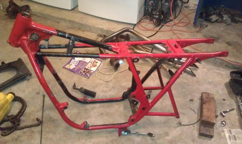

Well, on another note, as I looked at the bike tonight (since yesterday), I got a little disgusted at the frame. A latex paint was used on it, and while I'm sure it looked good at the time, it looks terrible now against the test of time. She is flaking and chipping more every day. Not only that, but the previous previous owner only painted the outside frame, what he could see and reach. On the inside, underneath, and in crevices, you still see the original black frame. Also, the red latex is really runny and drippy in many areas.
I've decided tonight that this will be a full overhaul. The frame will be powdercoated. Putting so much time into something with a shitty foundation is a waste, I suppose.

I found an online wiring diagram / parts catalog, and that black box ended up being the starter safety switch. It's just a typical 86-87-88 switch, that takes into account the hot, neutral switch @ the kickstand, ignition with the clutch depressed, and finally to the starter motor. I'm scrapping this.

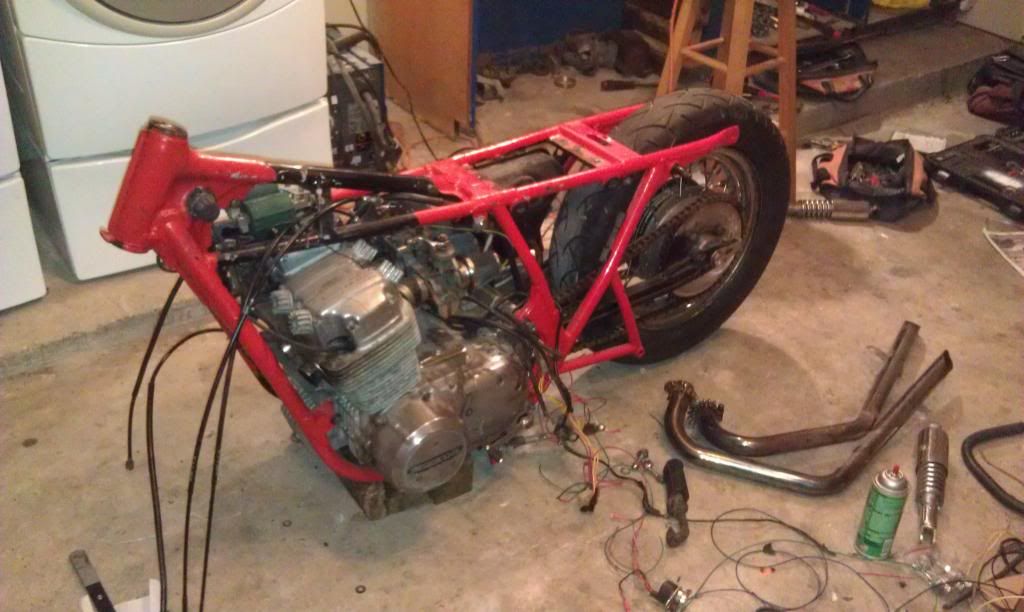

Well y'all, I played around a little more tonight.
I will be cutting the frame and welding tabs onto it over the next few days. I'm also going to trim the frame for larger tolerances to clear the motor easier when I go to install it. After that, it goes to powdercoat for a proper frame color scheme. I found 50-75% of the bolts were not torqued to spec or were missing entirely regarding rear wheel, engine, & tranny assemblies.
I rigged up a pretty nifty pulley system in my garage to lift the frame off, drop the bike on the right side, and give additional support where needed.
After tonight's ordeal, I'm going to invest in a bike lift. On the far backburner is a mid-engine 914/6 that is apart as well, and all of the P-guys say to get one when the time comes to reinstall. Might as well get it now...
Oh, I also scored this exact setup for only $260 from Craigslist yesterday (barely used, minor scratches in a couple places): :)
Also, for anyone else reading this, definitely remove the carbs from the motor (at the rubber elbows) before attempting to remove the frame. Some people have been successful, but in my instance, it made a considerable positive difference with play. Also, remove the finned camshaft valve caps on the valve cover. This truly made a huge difference as well.

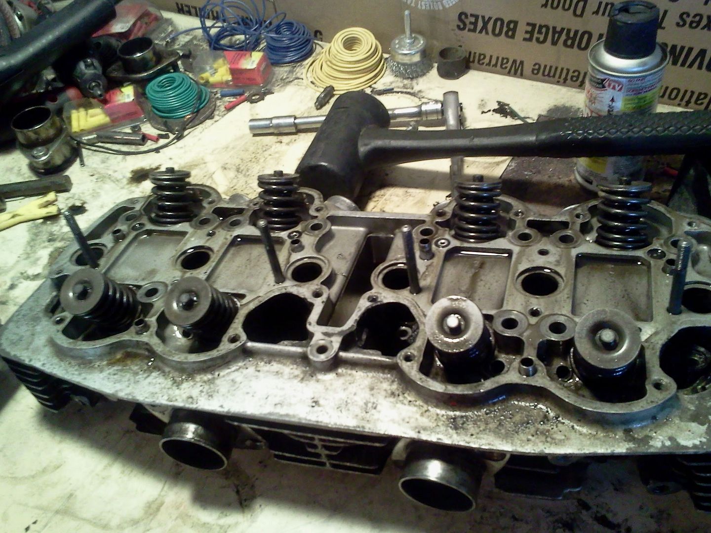

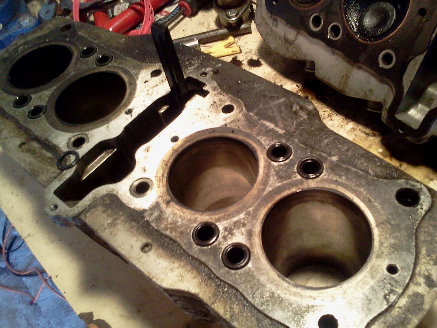

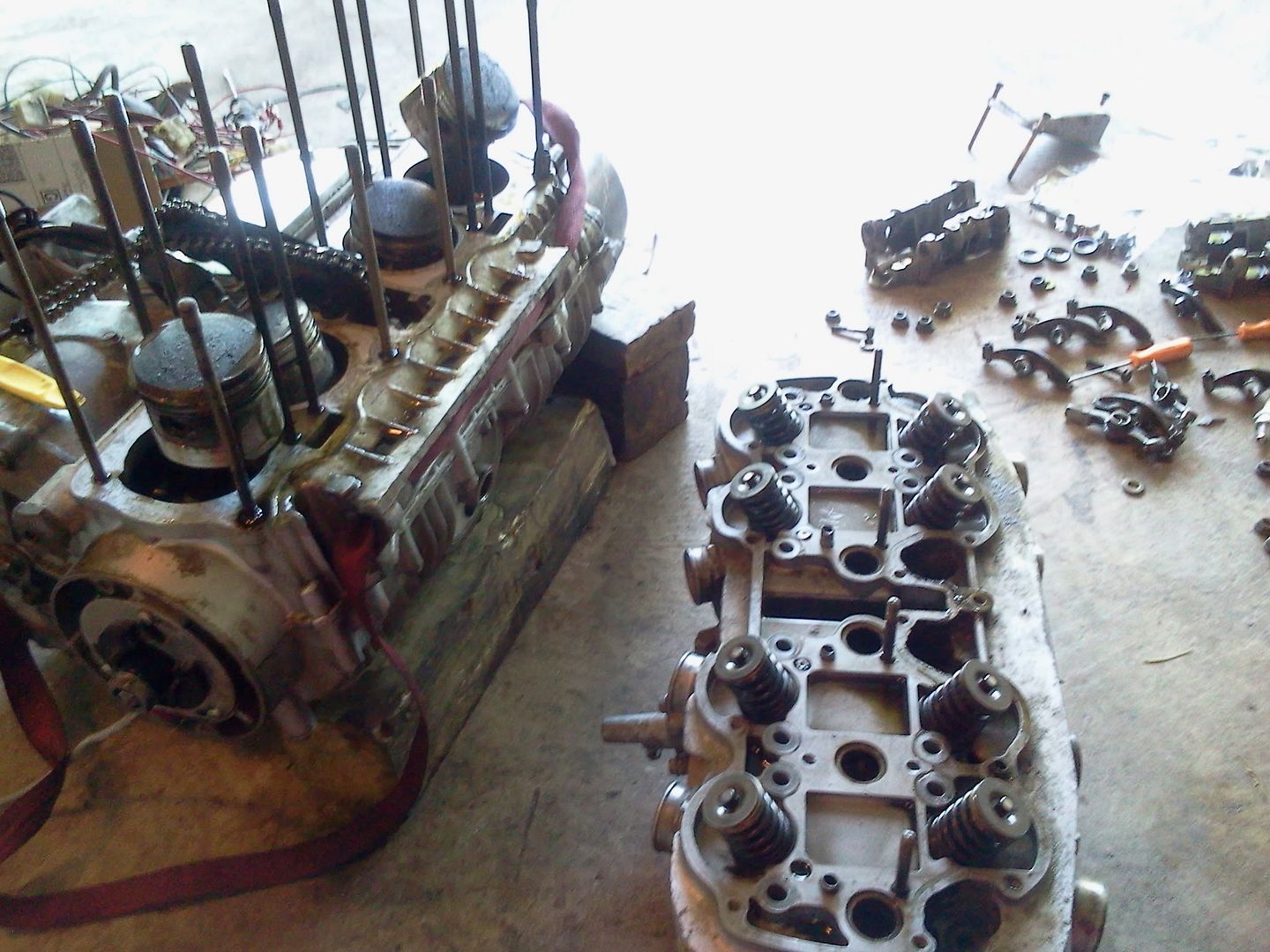

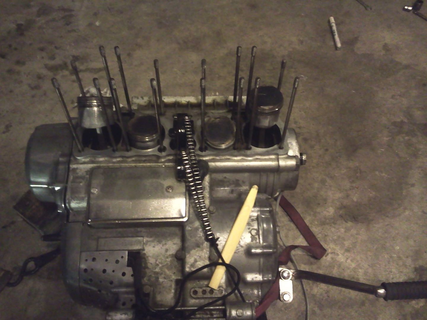

I've completely stripped the frame, removed all of the tabs, and shaved some close areas with the motor. I rounded out smaller welds and brackets, too. Subtle differences that make a difference to me, I guess.
I tore into the motor, simply for the piece of mind that it's fresh and nothing is going to go to #$%* while I'm in a corner one day. I also did it because I want to paint it a nice gloss black. /vain ;D

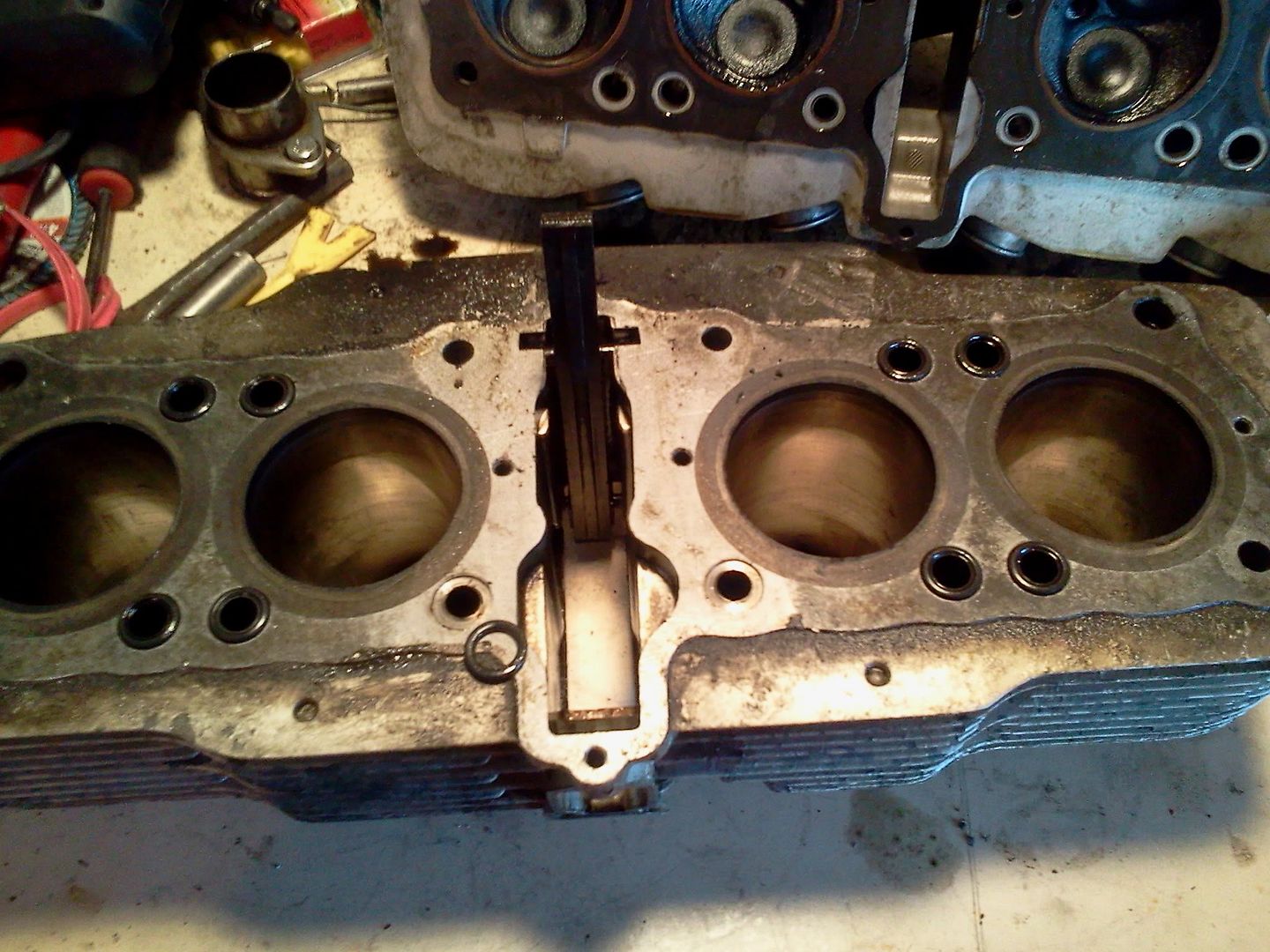

All of the cylinders looks good, and #4 looks to have run a little bit richer than the rest judging from the carbon deposits. Everything appears to be original, with the exception of the exhaust flange bolts when the previous owner swapped them out for the drag TT pipes.
The heads and pistons will be cleaned, the valves will be lapped, and the cylinder bores will be honed.
#2 & #3 exhaust bolts are completely stripped from the previous owner. #2 even has a screwdriver bit broken off in it. I attempted to remove the #2 bolt, but broke my Craftsman extractor bit.
Stay tuned...
Should I rebuild the lower half as well?
