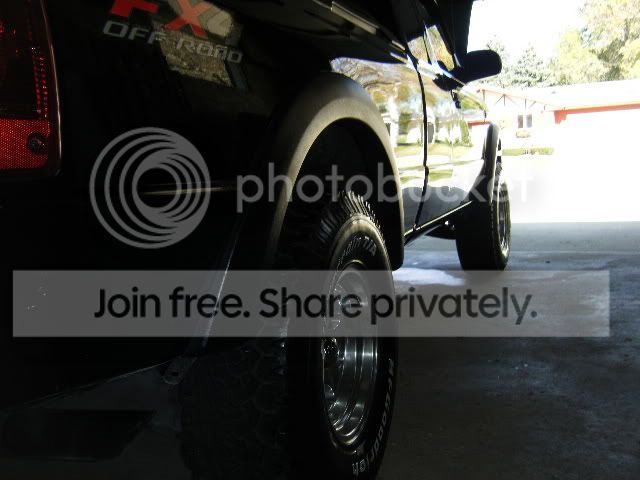

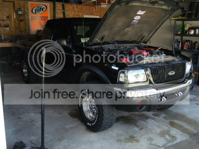

I do believe thats someones ranger on here, 04RangerFX2... Anyways she is running 31x10.50R15's on some eagle alloys I think? and that is a 2wd ranger btw so the suspension is probably a different setup.

that black truck has 15x8's with 3.25 backspacing if i'm correct. they might be 16x8 but i know its 3.25bs
That black truck is on 15's with 3.25 as you say, but its also -30 offset.

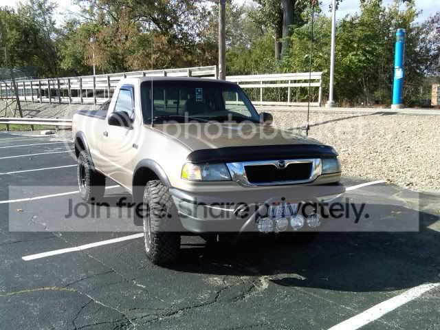

I do but not with very good stance shots... and I have my winter tires on so I really can't go get some but here you go.
This one is when i first got it, broken springs in the back and stuff:
Heres after I got the springs fixed...
best stance shot:
15x7, 4 in backspacing, no offset. I wish I would of gotten 15x8 for a better look. 31x10.5 tire. I got my rims from Summit Racing seeing as I live 15 minutes from the store.
