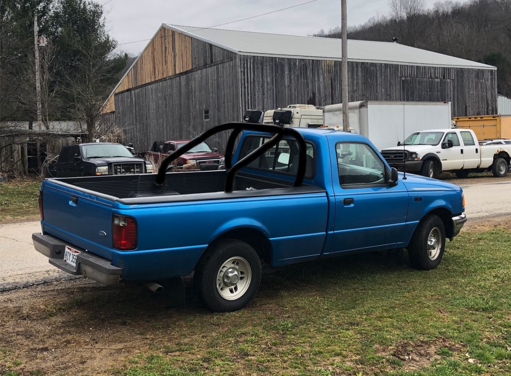

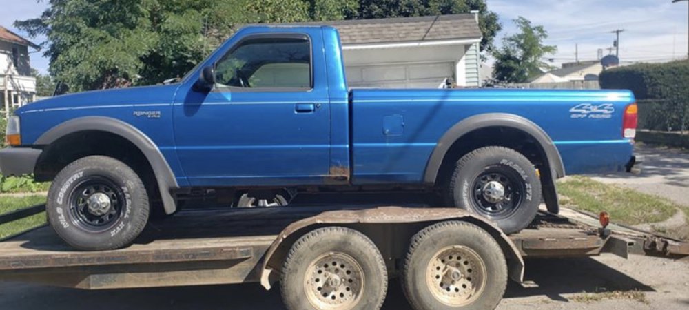

I have a 1996 Ford ranger that needs a new bed and fenders. I found this one being parted out online. It is a 1998 Ranger and it looks like the same color as my 1996. My question is, will the bed and fenders from the 1998 fit on my 1996? Thanks.

My 1996: the other side has big dents.
The bed will.
The fenders... not exactly. You will need the entire front clip including the rad support. It's probably not worth it for the fenders.
