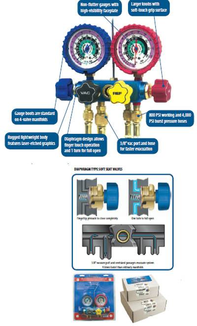

Also, I wouldn't suggest the method described earlier for using the vacuum to pull oil in unless the system is currently being vacuumed at the same time. Reason being, whatever air is contained within the hose itself will also be sucked into your system (maybe if you filled the hose first with oil, then submerge the end and draw it in would be OK, but if you got a vac pump, seems easier to just do it while you're vacuuming).
4x4 good to see someone was aware of this!
" Reason being, whatever air is contained within the hose itself will also be sucked into your system"
It can be done if you have a dual hose valve setup.
DIY on Automotive Systems, it's easier to get the oil in a pressurized can.
