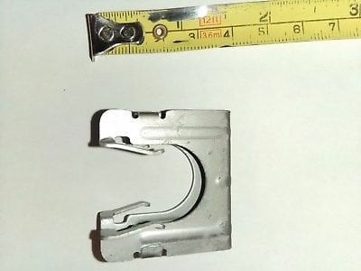

Y'all could wind wire in a way to keep those joints from pulling apart, and they do move, I saw that, although the distance all the way in and back against the clip of the spring is probably very small they do move that much especially the larger ones
There are keepers that go over the joints from the factory.
Ah!
Found this on a Mopar
They don't list Ford all you would really need to know is the diameter of the connection which is larger than the tubing itself so you probably should use a caliper to measure it. They aren't cheap!
