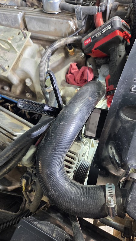

In regards to that, the bolt for the rear fuel tank strap had it out with me the first time I dropped the tank. I think it was a bolt going into an extruded clip nut, I ended up having to cut it out and just went back with a bolt and a nut. Well now with the driveshaft in it is a major PITA to get a wrench on the bolt in the crossmember. So after fighting it for 4-5 times dropping the tank since I decided to make the bolt one with the wrench... and welded a handle on it.

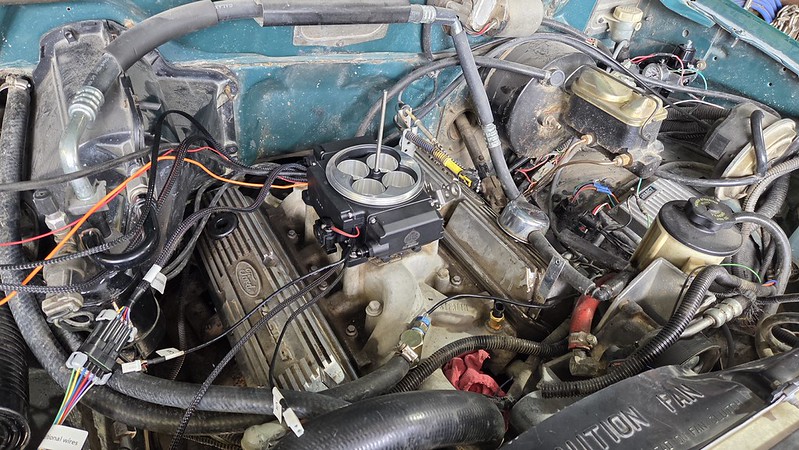

Slightly less cluttered view as I sort thru and plan things out.

It looks bad and I threw optional harnesses on there for added effect.
In truth when when you think it has the efi, ignition, fuel pump and efan controls it really isn't that big of a deal.
Left to right.
Oxygen sensor pigtail
Battery power and ground.
Fuel pump trigger wire
Coolant temp sensor pigtail
Key power
Multicolor wire cluster is efan, tack in/out etc (I won't use them all)
Coil harness
Distributor harness (two wires)
Can buss connector for tuning
Considering how much it simplifies just the ignition let along coolant fans and fuel its kind of a wash.
its simpler than any 80s carb underhood disaster of wiring and vacuum egr thermactor controls.
