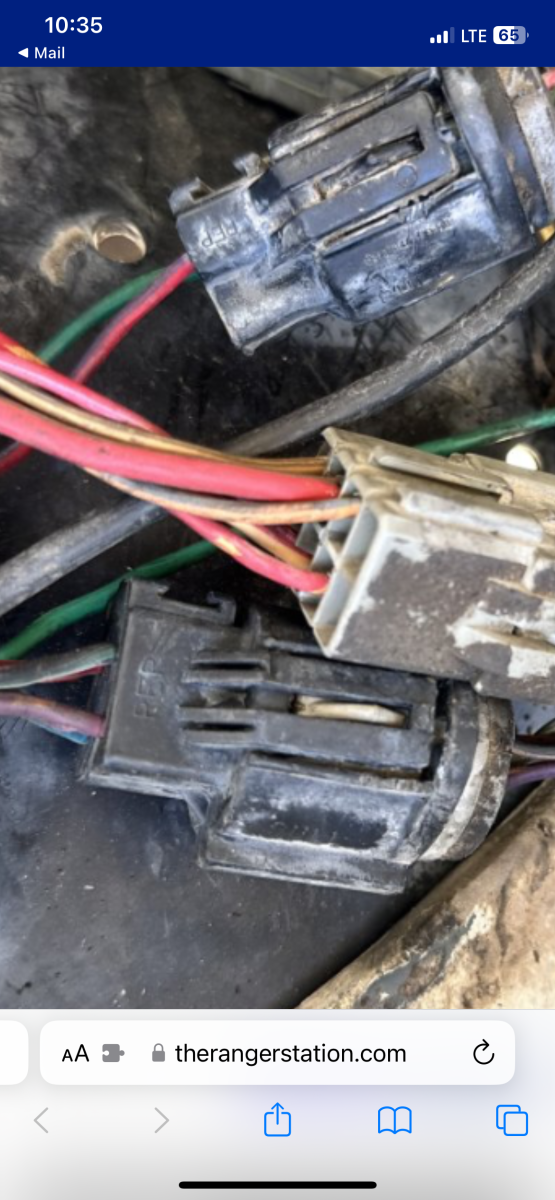

yessir the red/Lb wire would be the 12v start position can also test it with the test light while someone is turning the key. I’m thinking my issue is my ignition cylinder. Seeing that I have 2 separate keys that came with the Bronco makes me think it was changed and went out again
one key should be for door cylinder and one key for the ignition cylinder as far as i know. I had some wiring issues at my igntion column and my harness for the switch is SUPER lose. also missing a screw which is also nice. i disconnected the harness and the whole assembly fell out and i managed to put it back together but it has ALOT of play so im just going to order a new switch, they're only like 20-45$.
hmm not sure why it wouldn’t crank without the round plug, plugged in. I believe one of the round plugs are for backup lights, blinkers and what not, the other should go to the NSS or clutch safety switch. The big red wire is the constant 12v to the coil or ballast if you’re using that one
Yeah one of the round plugs is for starter

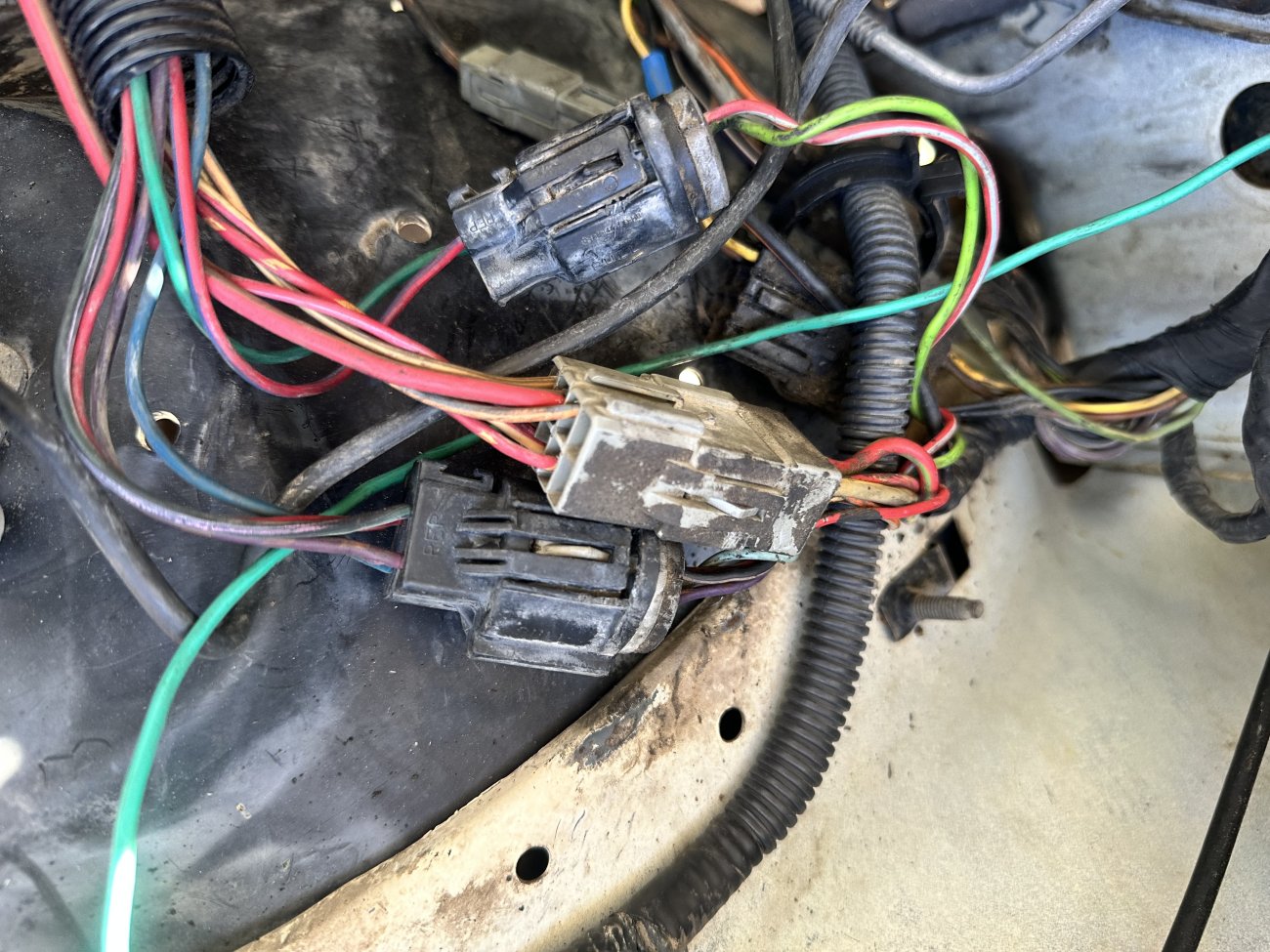

I did some more digging, i realized i cut the wires to my backup lamp switch haha , easy fix though.
yeah so i guess just make sure you wire those red/lt bl wires in parrell at the driver side connectors, should complete circuit for starter. I am personally 100% confident in doing this swap now. Ill do my own harness and make it look really clean and not use that crappy plastic conduit. I prefer tecflex
