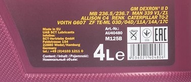

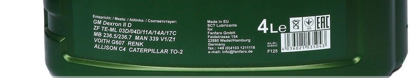

I can't find a Mercon Motorcraft in Europe, I find this
50506
50507
but that doesn't answer my question, can we put syntetics in an a4ld
