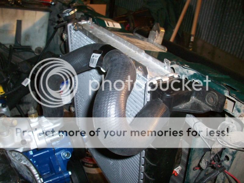

SN-95 Mustang 90 degree water neck, 5.0 Exp upper hose and 4.0 Explorer. I have just test fit it, I think it might fit better with a little trimming. Lower is a generic flexhose.
Wonder why ford made the hose have so many bends?

They were dodging a bunch of junk with the hose. I was mainly concerned about the alternator.

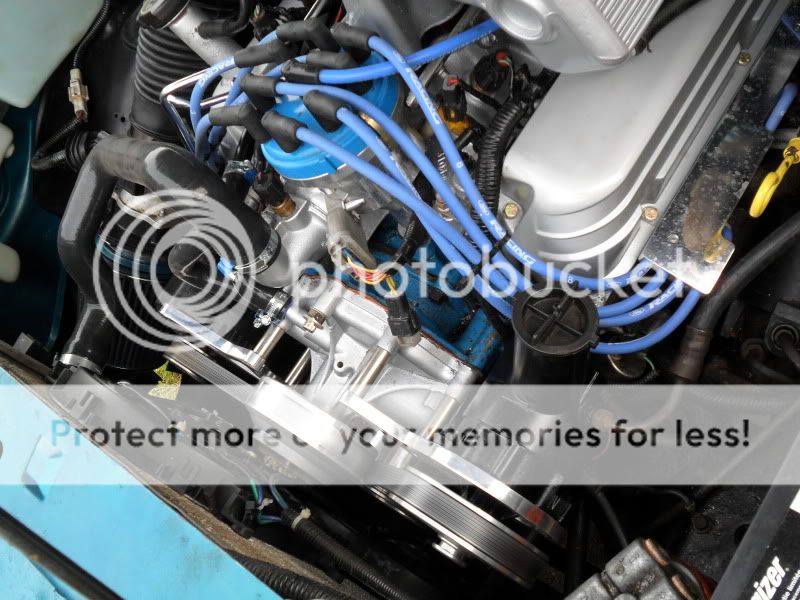

The temp sender is pictured, and why I got the Mustang thermostat housing. The Explorer one has hole but it is filled in, you could drill and tap it but if I am buying a new housing I might as well just get what I want.

I'm using a stock Fox body Mustang upper hose (well, it's a silicone kit), Fox Mustang water neck, and my fan temp switch is in the front driver side of the lower intake manifold.
(my Autometer water gauge is in the DS rear corner of my intake lower, and my stock dash gauge is in the water neck. They all seem to reflect similar temps)

Teddy, whose FEAD setup are you using ? Looks nice and clean, definately not Ford's.
I do agree, under the hood of your truck looks damn good.
