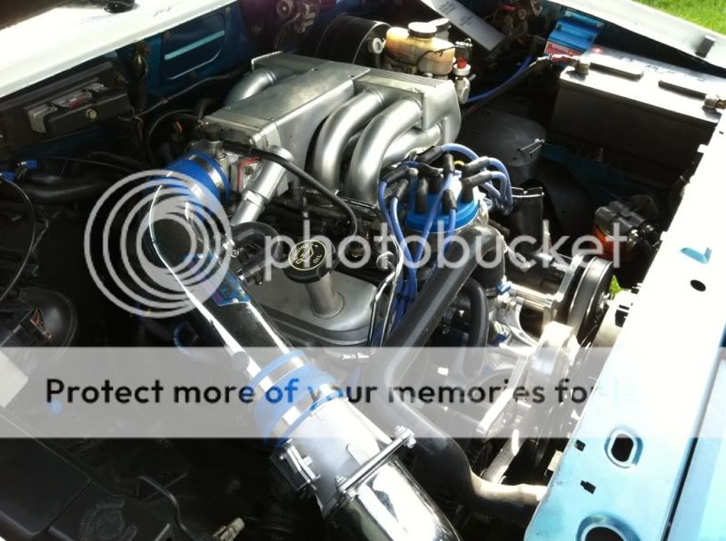

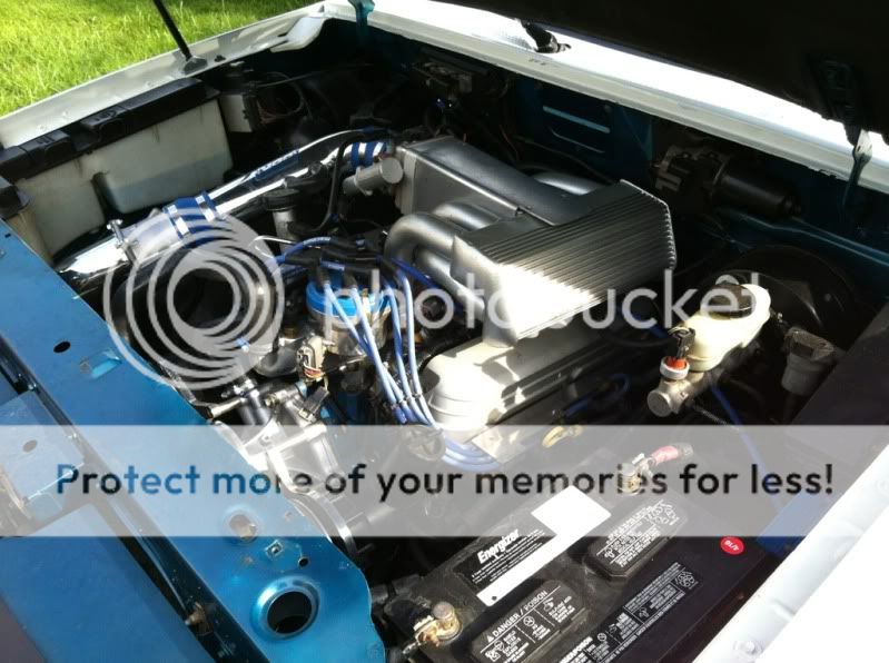

Teddy, whose FEAD setup are you using ? Looks nice and clean, definately not Ford's.
That's just the typical March-style knockoff. But, I mounted the alternator upside down for that hidden look. Matches the location of the ps pump this way.
Here's what it looks like now, BTW. Dirty, but many changes...
