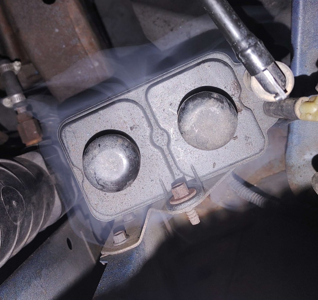

3. I've got a few vacuum leaks that I'm not sure if they're normal. I did a smoke test and saw smoke come from where the lid of the carbon canister meets the main body of the canister, I saw smoke coming from the breather valve on the driver side valve cover, and I also saw a little smoke coming from the EGR valve. I can't tell if the smoke is coming from the valve itself or where it meets the intake manifold plenum. I'm pretty sure that leak at the EGR valve isn't normal, but I'm wondering if the breather valve or the carbon canister leak is normal. I've heard the canister is supposed to vent, not sure from what part though.

3. There should not be smoke coming from any of those areas you mentioned. The charcoal canister vents are those egg-looking caps on the top.

I looked a little closer and saw that the smoke is coming from the EGR valve itself and not from where it bolts onto the intake manifold plenum. I found a small spot in the plastic casing of the crankcase breather where it's leaking. I also found out that the carbon canister is fine, it was leaking from the spot its supposed to vent at, it just looked like it was coming from the sides of it.
