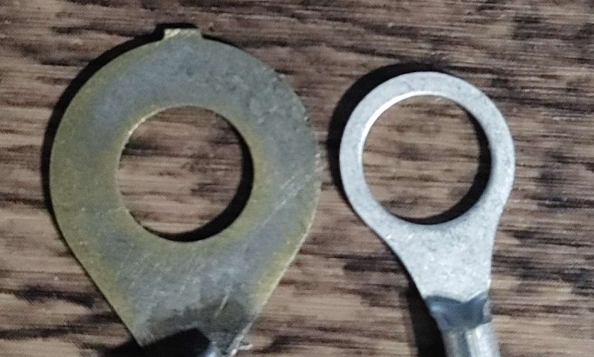

First, sorry for taking a few days to respond. I was gonna go get the new ring terminal after work the other day, but my car also stopped starting too and I had to get towed home from work. The battery leaked a little and caused a bunch of corrosion on the terminals which made a bad connection. The ground side battery terminal connector was also cracked which I wasn't aware of until now. Cleaned it up good, swapped out the connector, and its fine now.
Anyway, I could only find a much thinner ring terminal that was 22-18 gauge and 5/16" stud size. Almost nowhere even had those sizes, let alone one as wide as the original. I attached a picture of the new one vs the original, do you think the new one is too small to carry the power going through it? Also, I had to get a new ring terminal because the fusible link wire burned up right at the ring terminal crimp so the wire was too short to just connect another bit of fusible link wire to.
Another thing I found is that it still didn't work with the new relay and fusible link. I measured a constant 11.80 volts (which is the same as battery voltage) at the yellow colored wire attached to one of the big pins. I put in the old relay and somehow it works still. I feel like these aren't the same models the original relay even though every place online says to get the part number RY-111, multiple new relays did nothing that were labeled as that model number, but the original relay works great. I don't want to keep the original though as the cap doesn't stay on at all which is what caused this issue in the first place, plus the spot where the clip goes on the original relay is broken, and it also has burn marks on it.
I was wondering too if getting battery voltage at the larger pin (11.80V with accessories on) while only getting 11.51V at the smaller pin is normal. The battery is 4-5 years old, but the truck also has been sitting for about a week.
Extra thing I found when looking into this issue is that the side of the positive battery cable that connects to the starter relay was so corroded that I had to hold a wire wheel on it for a few seconds before I could get to bare metal.

Also I just wanted to confirm, is the new ring terminal size fine or should I worry about it getting hot since its a lot smaller?
Eyelet size is fine, will be OK up to 40amps, fusible links are 30amps usually, so "fuse" will blow before eyelet will melt from heat
