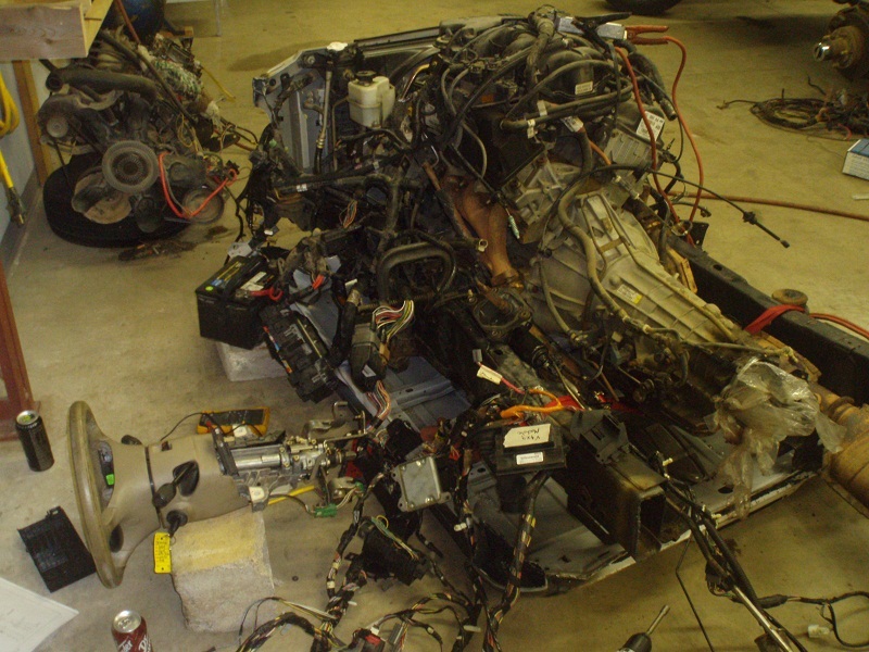

Im interested in this and well Im in the same boat as you. I have a 2000 ford ranger trailhead. I bought a wrecked 2004 sport trac 4x4 with the 4.0 sohc engine. My plan was to just swap in the 4x4. So far its been pretty easy. Now Im thinking I would like the 4.0 in my ranger since I just have 3 liters in it it would be nice. I have the entire wreck. I just pulled the entire harness off the chasis and the dash I even have the steering column.I tired to start it before I pulled it and it. It would not turn over something was holding the starter out. I believe I have everything but the gem. We will see how it goes.

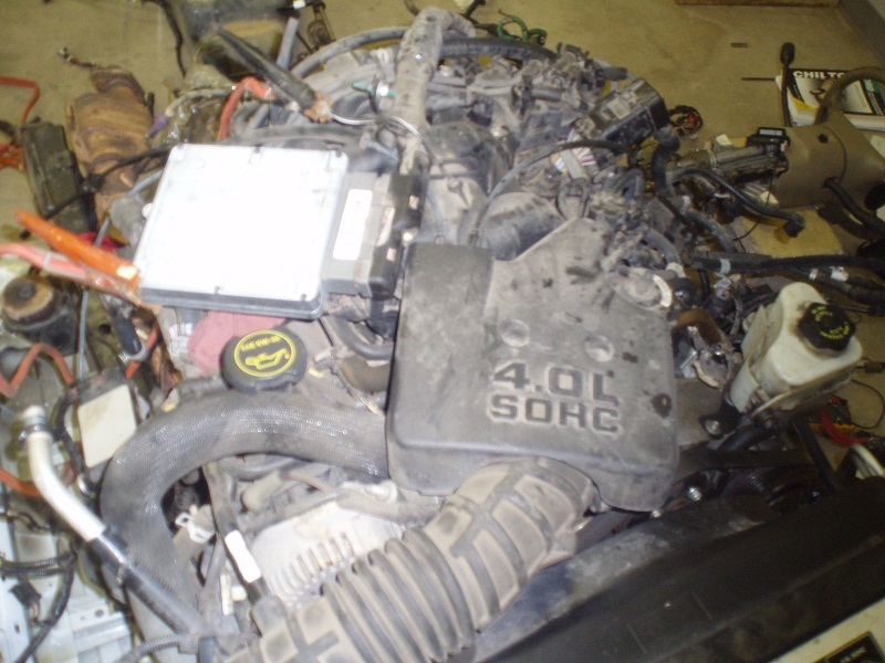

I figured I would give an update on my progress here is a pick of the 4.0. I just got it to run today. Im gonna trim up the harness. Then I will try to swap it in.
