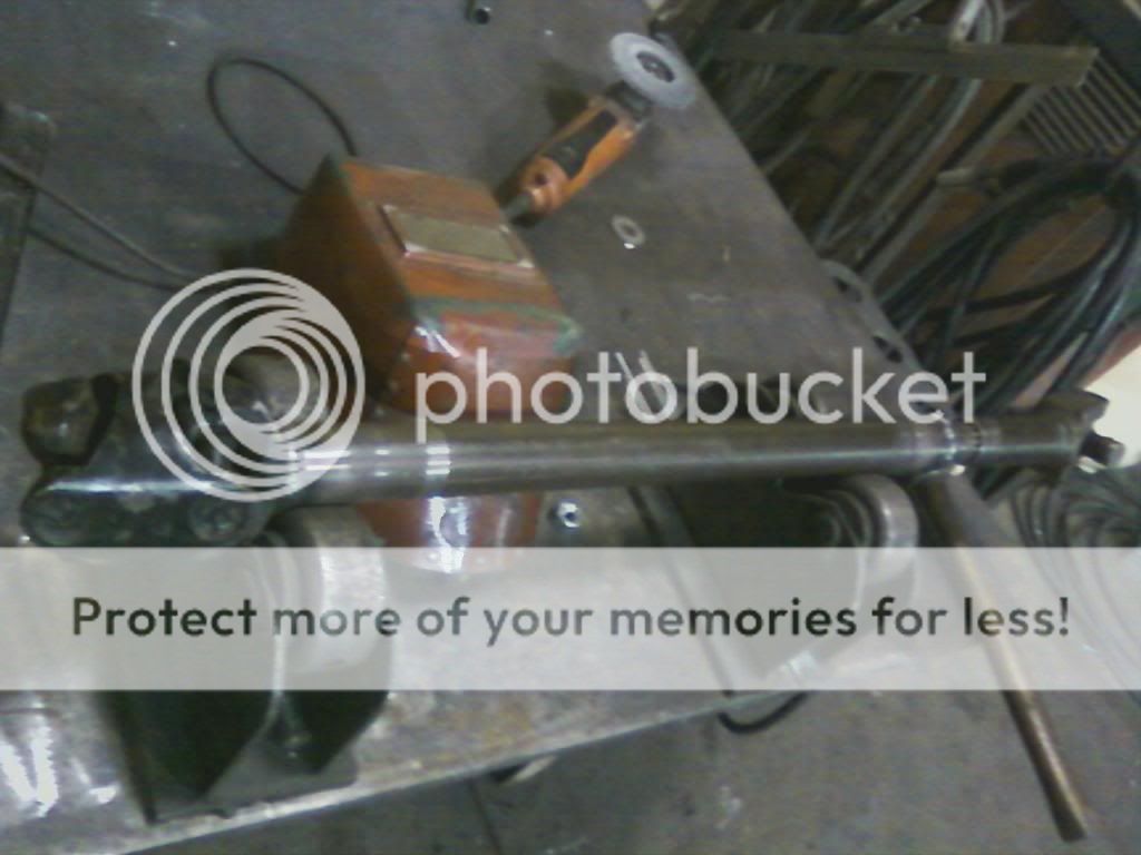

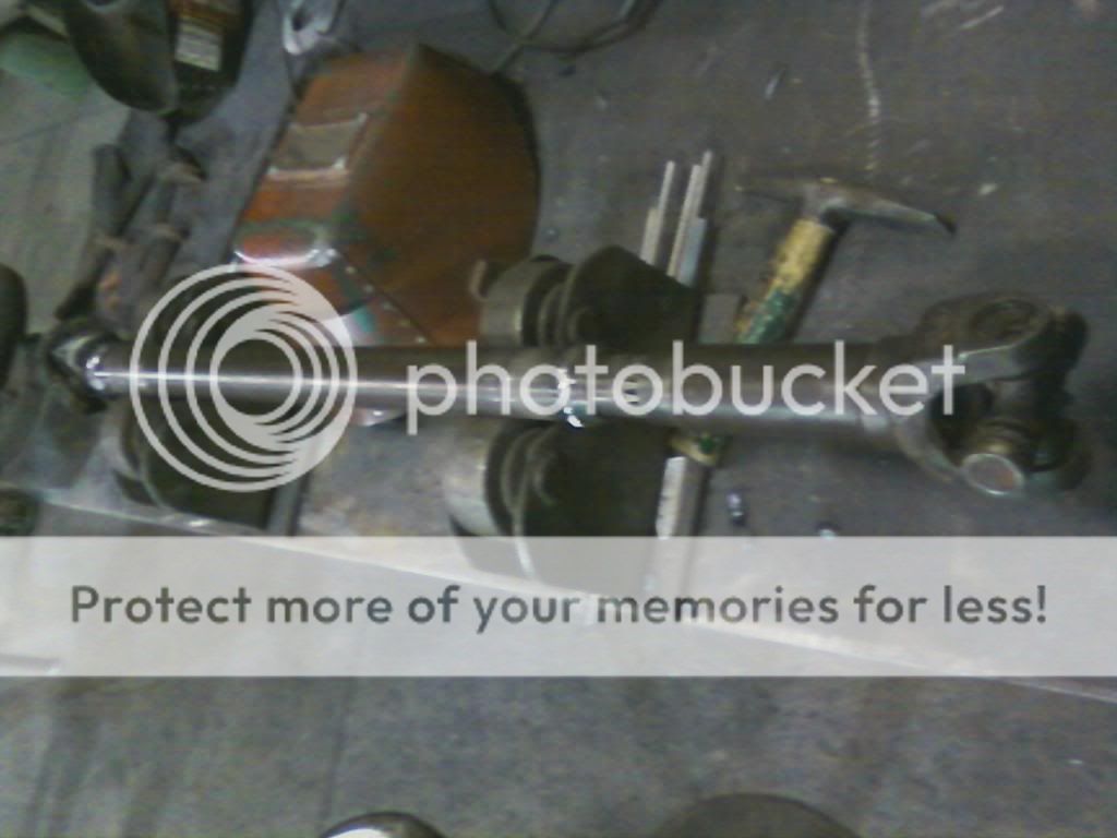

made and installed my front driveshaft on sunday.
i'll be wheelin by next week.

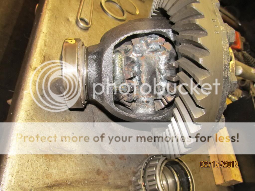

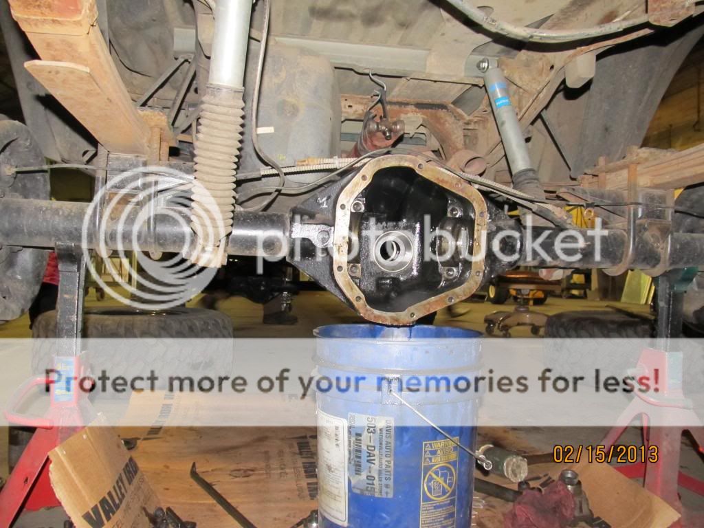

So I installed my gears in the rear axle. When I opened up th diff cover I found out that my spider gears where pritty much shot. So I installed a Lincon locker lol. Not so sure I like the churping around the corners but it will have to do for now I guess. next Friday I'll get the front done. Luckly I have a limited slip carrier for the front. Its not a locker but its better then nothing. Pics to come.
My diff all cleaned out
My my welded carrier

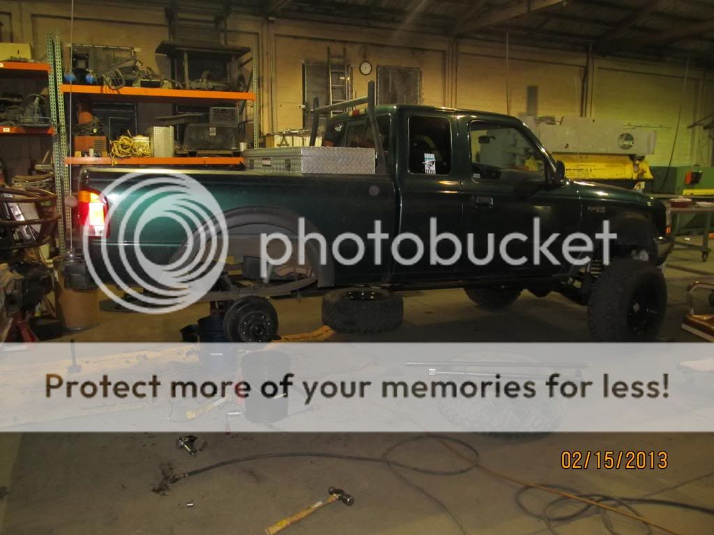

and of course the buggy got worked on as well
proof... can you see em?

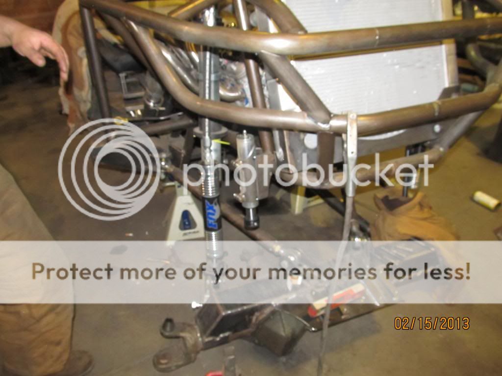

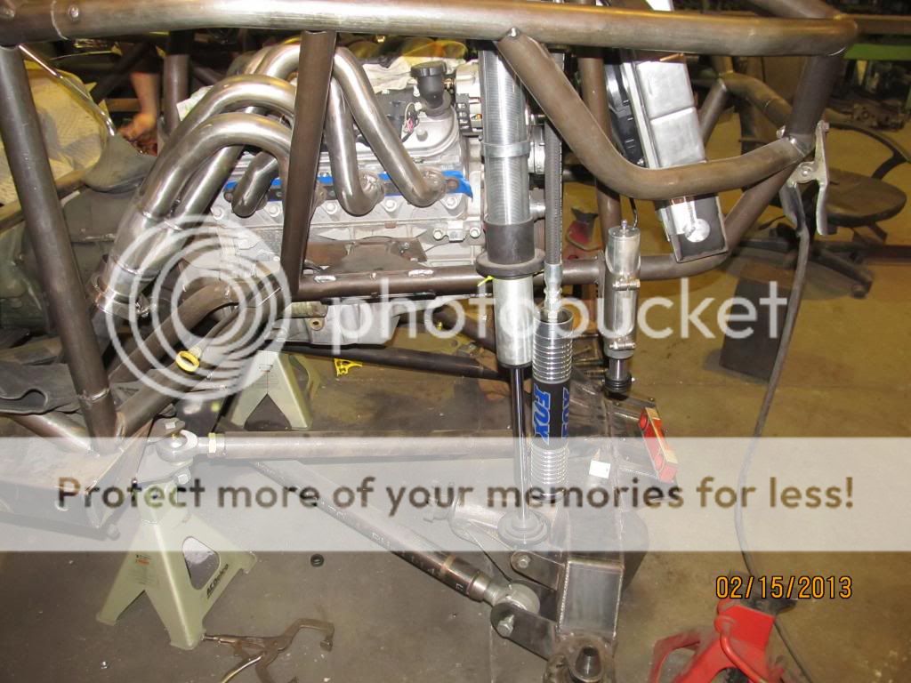

What type/Make of PS gear box is that ,that you have installed on outboard side of frame rail?
88 toyota 4runner 4x4 IFS box
