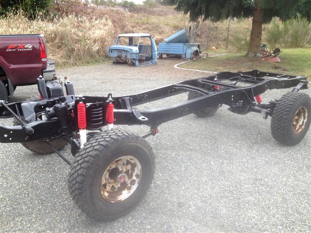

After nearly a 30yr absence from wheelin, finally got to last weekend with my Son. Had a lot of looks, as our '94 ranger is stock, all Jeeps in the group. Well the Ranger earned it's stripes, as we only need one tug, got high centered, and made the whole day issue free.
So, that got me a thinkin!! I just so happen to have a '79 doner F-150 for our current build, and with this fine job you have done, has given us the push to make a serious wheelin rig out of the Ranger!!
By this time next year, should be done..... I hope.
Here is our current project, frame up resto on a '79 F-150 4x4, was Grandpa's rig!!

Sounds like a good start to a fun project. I'm more than willing to try and answer any questions you have. There is a lot of nice rigs on this forum to get Ideas off of. My first suggestion would be, since you have a bear frame to work with, box it in. I'm glad I could give someone some inspiration. Good luck.
