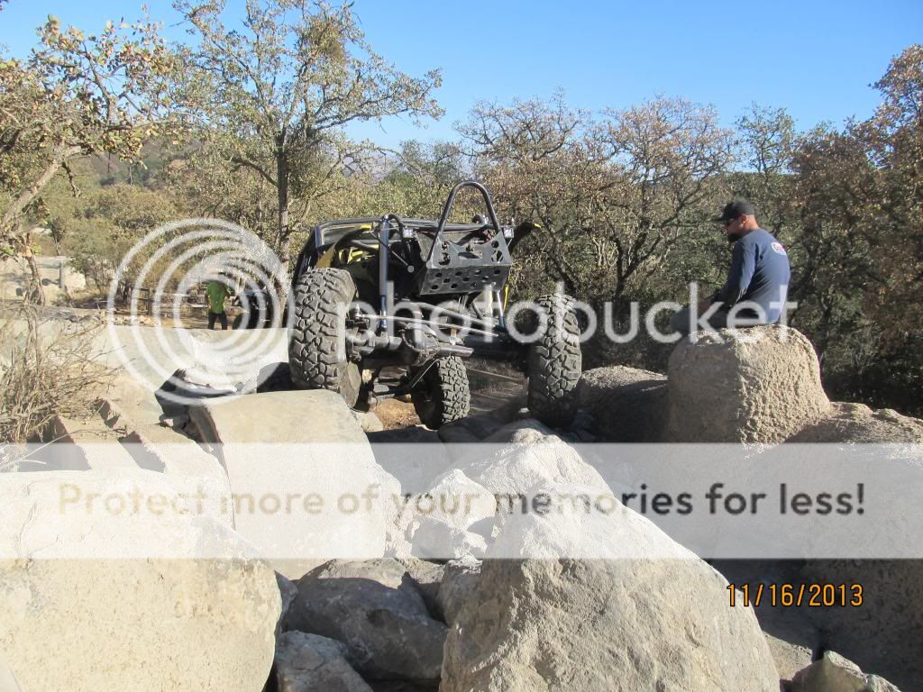

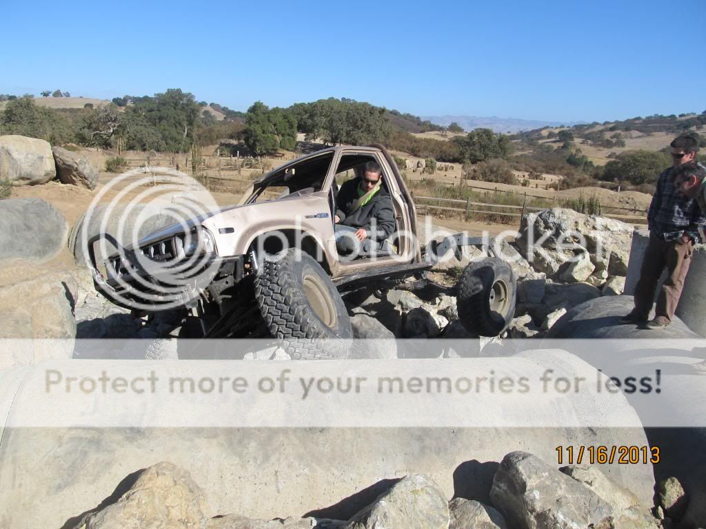

Finally something worth sharing! She did well. I need a belly pan ASAP.

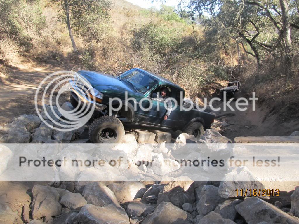

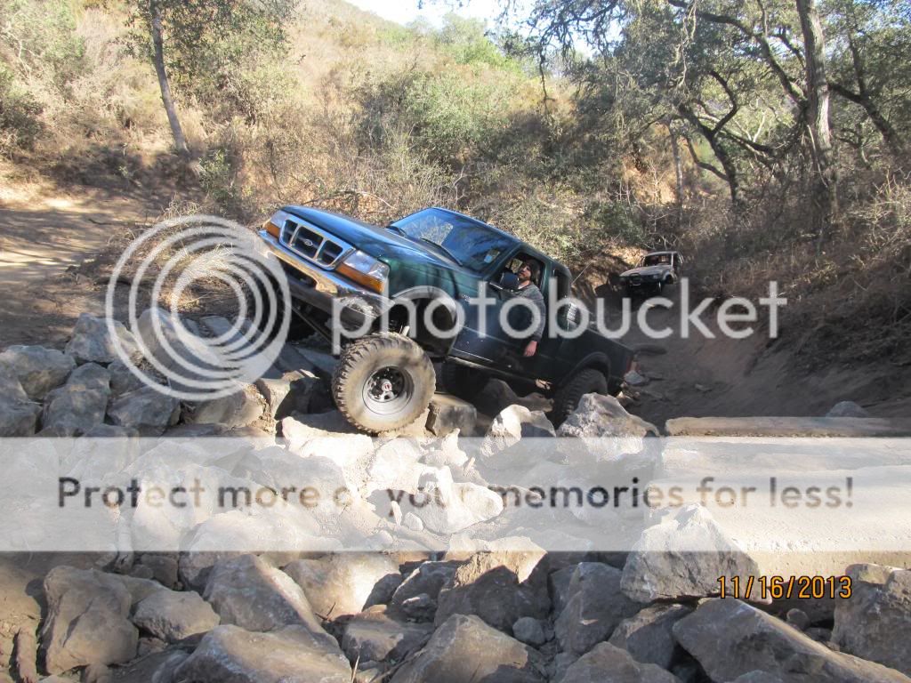

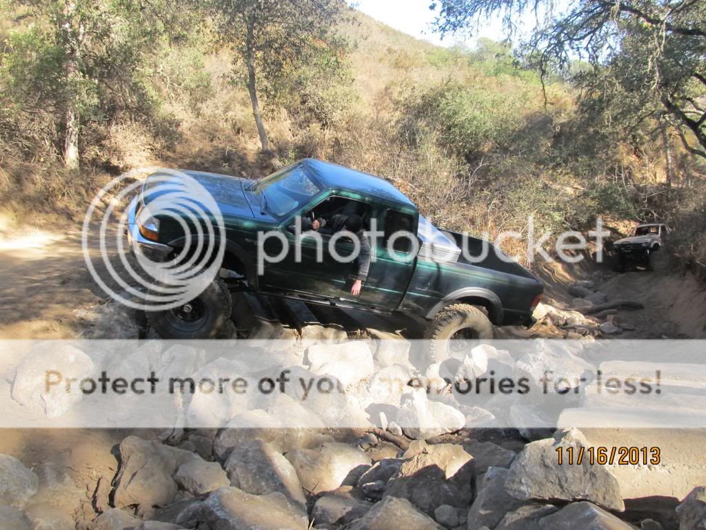

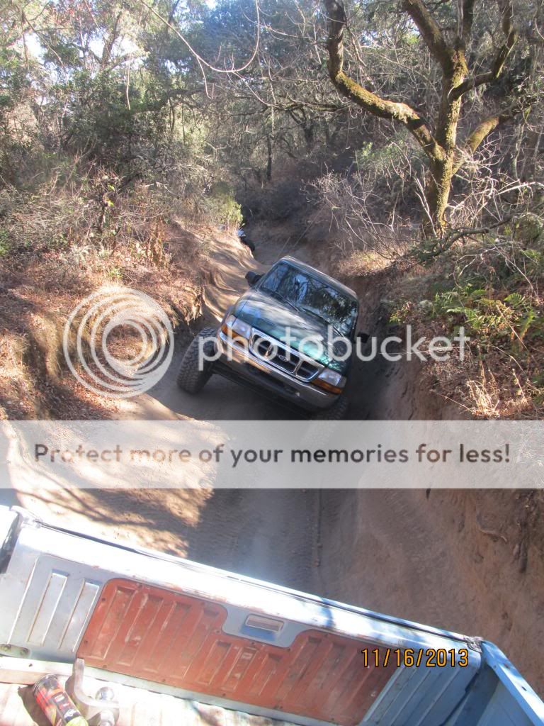

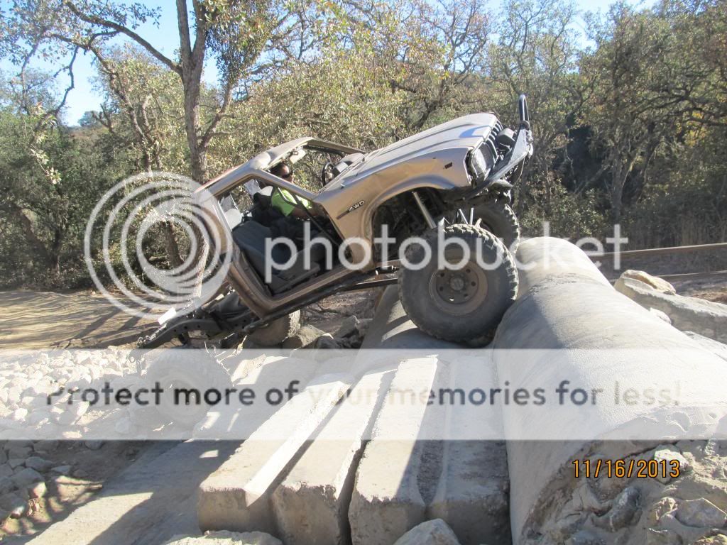

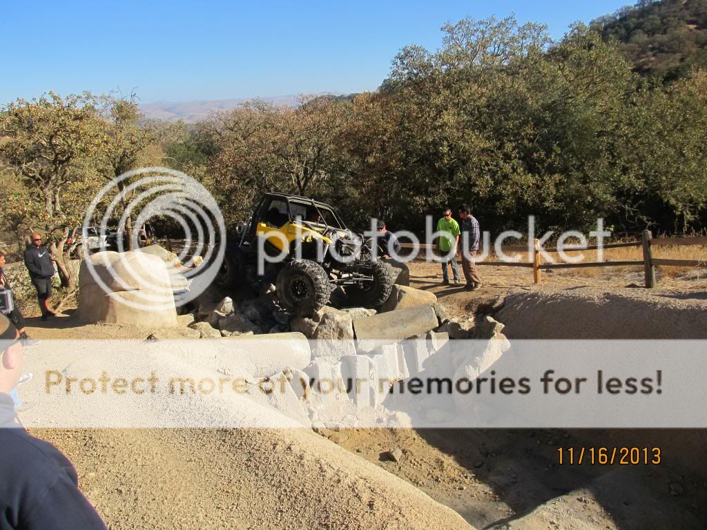

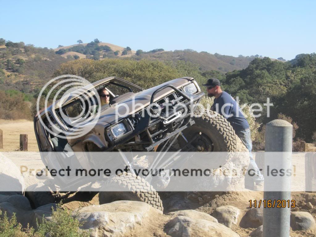

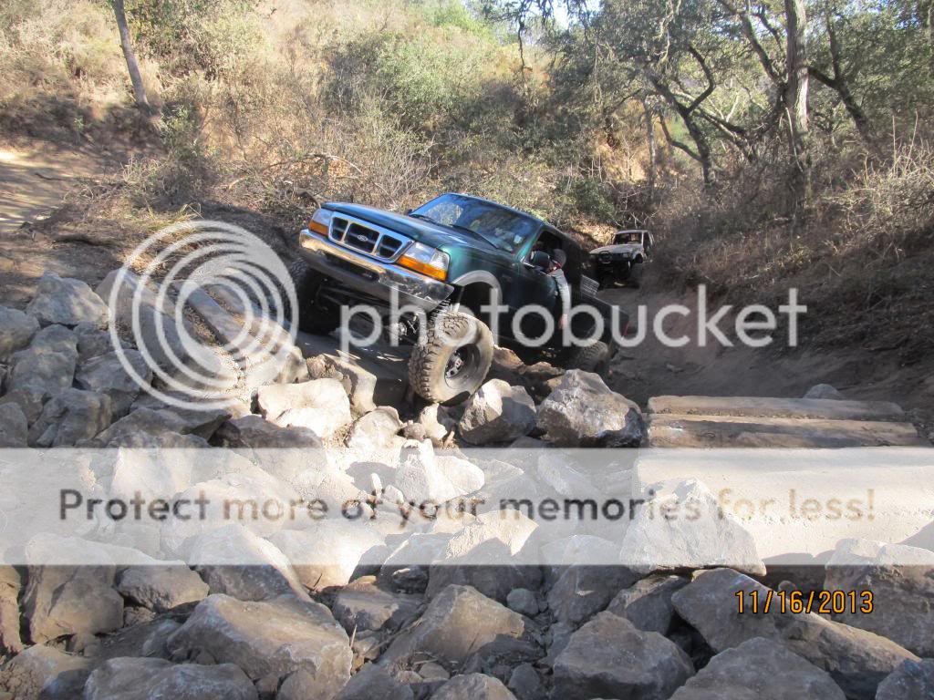

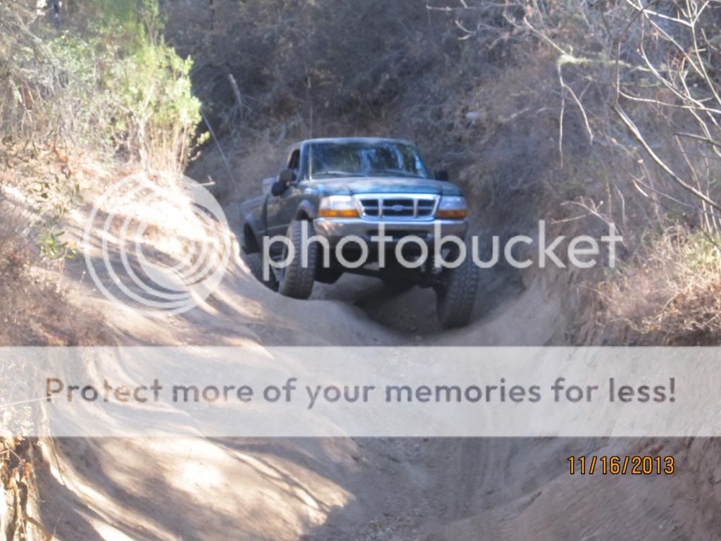

Some nice pics u got their, looked like a fun time!! How did the ranger do wheeling?
It did well. I need bumpers and a belly pan really bad. there was a lot I didn't do because of it.
