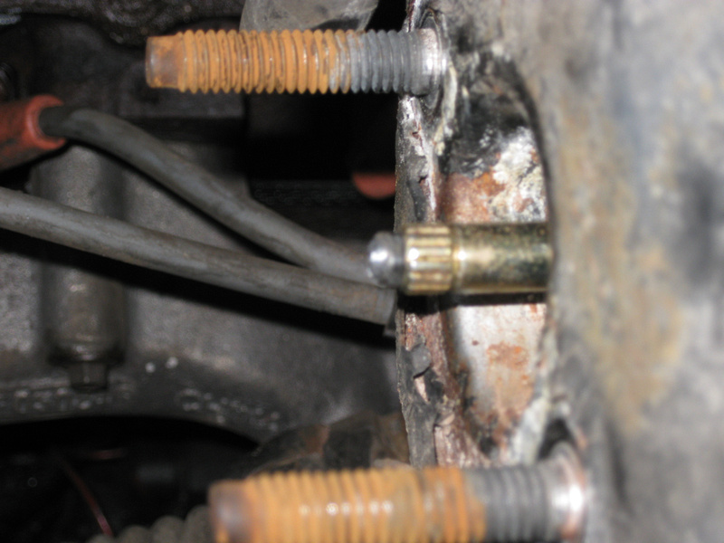

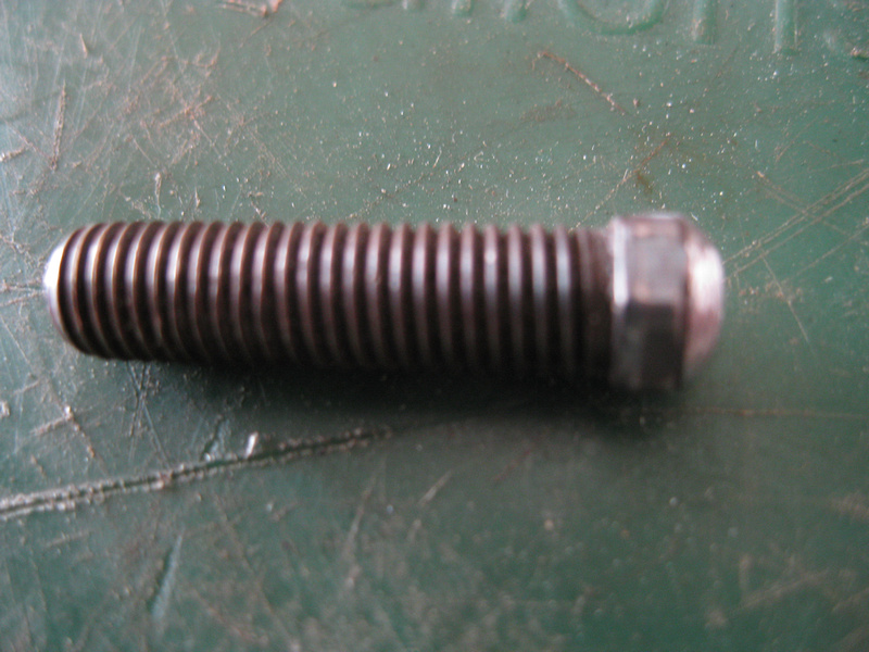

I've borrowed some pictures from the original article to show this. Here's the stock pushrod.
And here it is with 1/8" ground off, and tightened fully.
And close up shots of before vs after.

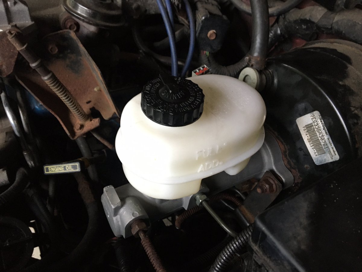

Once you do that, the Dodge master cylinder bolts right up to the brake booster, and the lines bolt right in as well. Here's a picture of the master cylinder installed in my truck.
The only other difference (and this would be the case with an f350 master as well) is that there's no brake fluid level sensor. To get rid of the light on your dash after the install, you'll need to jump the two wires in the brake fluid level sensor connector that are not the black wire - as shown here. This was my way of verifying that this would get rid of the light, I will do something less hacky to actually jump the two wires lol.
Like I said, I don't think it can get any simpler than that for a master cylinder upgrade. Larger bore than the f350 master, much simpler nearly bolt-in swap. I've got 33's on my Ranger and this swap was well worth it. The stock master did okay, but I never felt like I was getting the full braking power anymore since going to larger tires. It definitely felt like I had to put a bit of effort into stopping even in normal everyday driving. After swapping the Dodge master in, the brakes feel much more responsive, and the pedal feel feels like factory, but firmer. I'm able now to lock up the brakes which I was not able to do with the stock MC.
