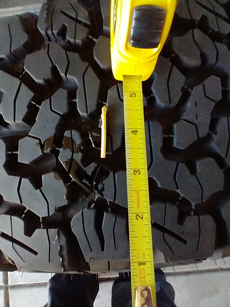

Success!
It was longer than the inch that I suspected. First puff of air, hit the bucket like a BB gun.
