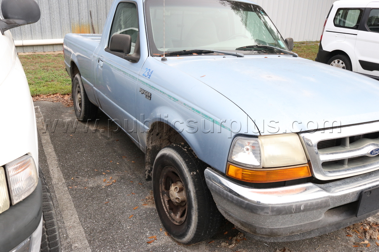

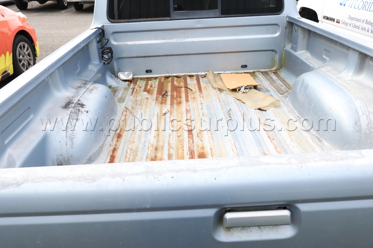

I finally found a deal I couldn't pass up at a university surplus auction - a '98 Ranger, standard cab, 6' bed, 2.5L and 2WD. No options, no power anything. A basic, reasonably sized truck that's honest about what it is. A truck that is plenty capable for what 90% of people would ever need a truck to do. It was listed with 174,xxx miles and a note that it stalls when put in gear (automatic transmission.) I checked some junk yard prices for a manual transmission and decided that worst case I could stomach the cost of a swap, and ended up getting it for ~$700. Aside from the transmission issue, the paint is pretty bad after nearly 30 years of living outside under the Florida sun, and the passenger door is pretty banged up, but being a university vehicle I know it has been inspected annually and had regular maintenance - probably better than I could assume from a private owner or a truck that has been through multiple owners.

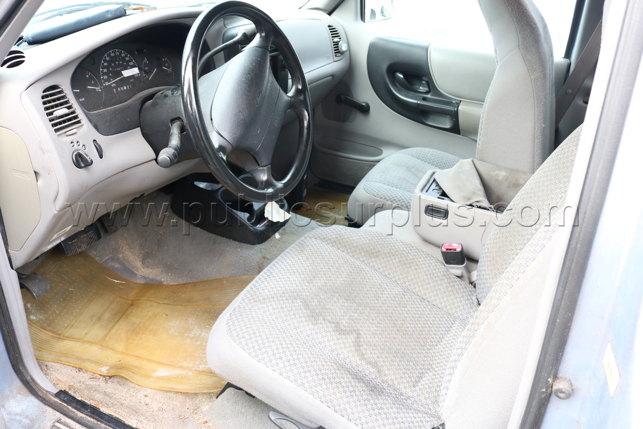

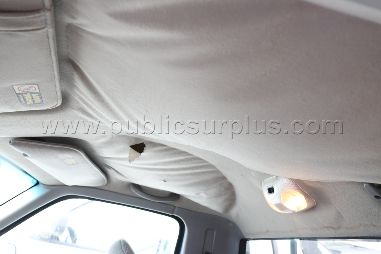

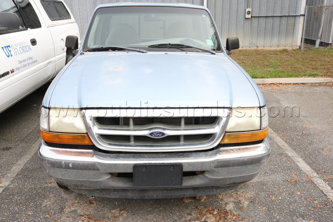

Auction pics:

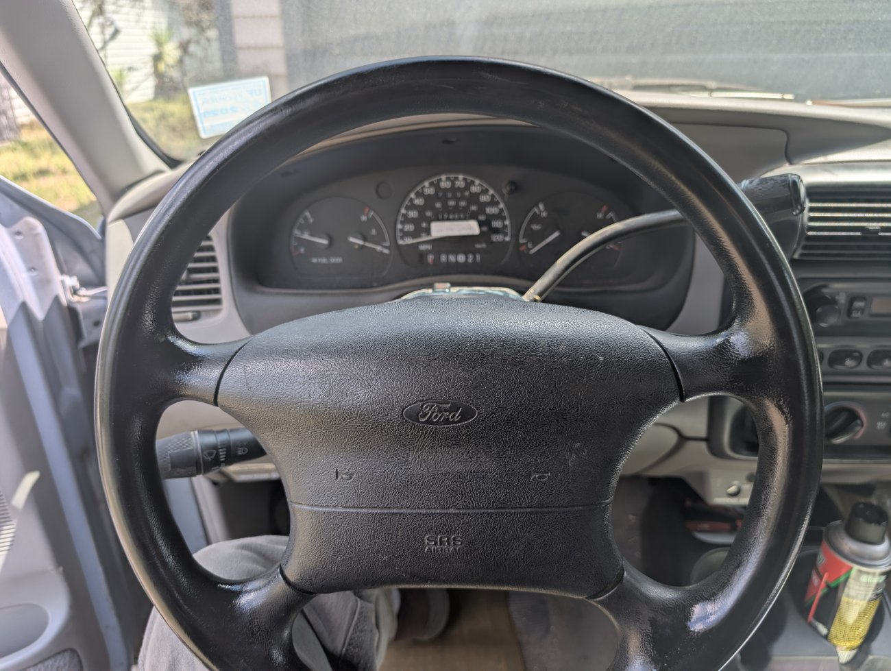

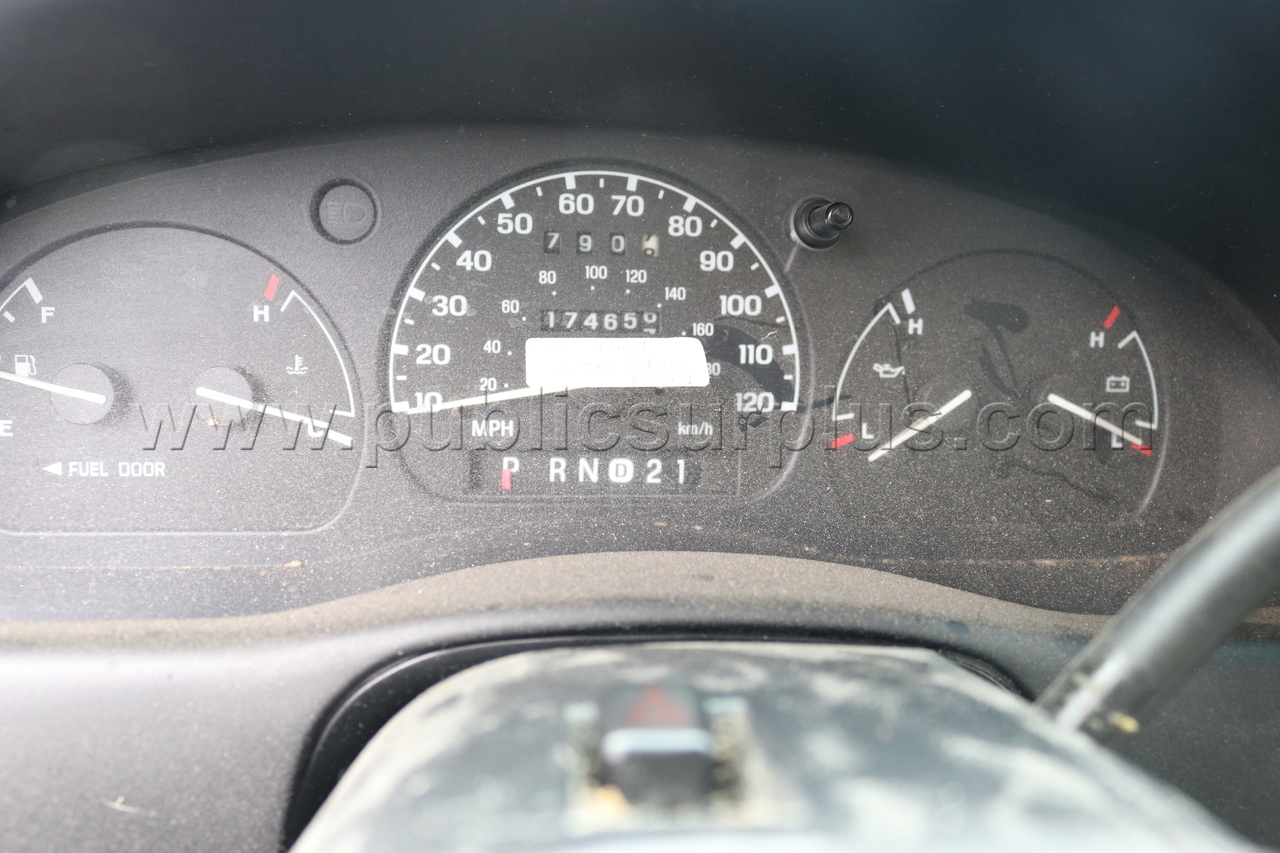

It is an "XLT" trim, which I find funny, as far as I can tell it means nothing. The only things on this truck that could be considered options are the automatic transmission and the factory pinstripe. Maybe the paint, it seems to be an uncommon color (light denim blue.) Otherwise it has no additional comforts - manual windows and mirrors, no tilt steering, no cruise control, basic AM/FM radio, speedo only cluster.

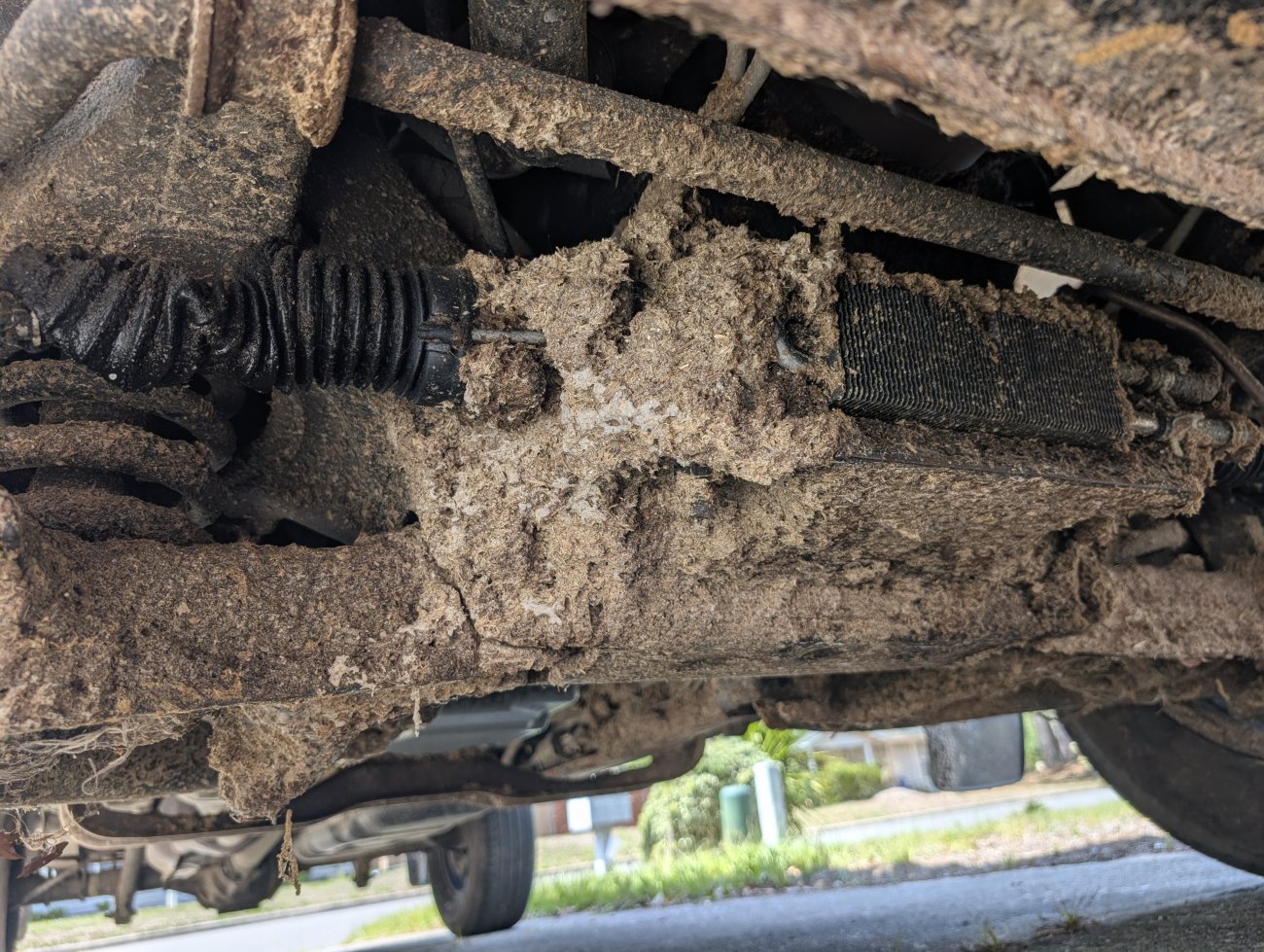

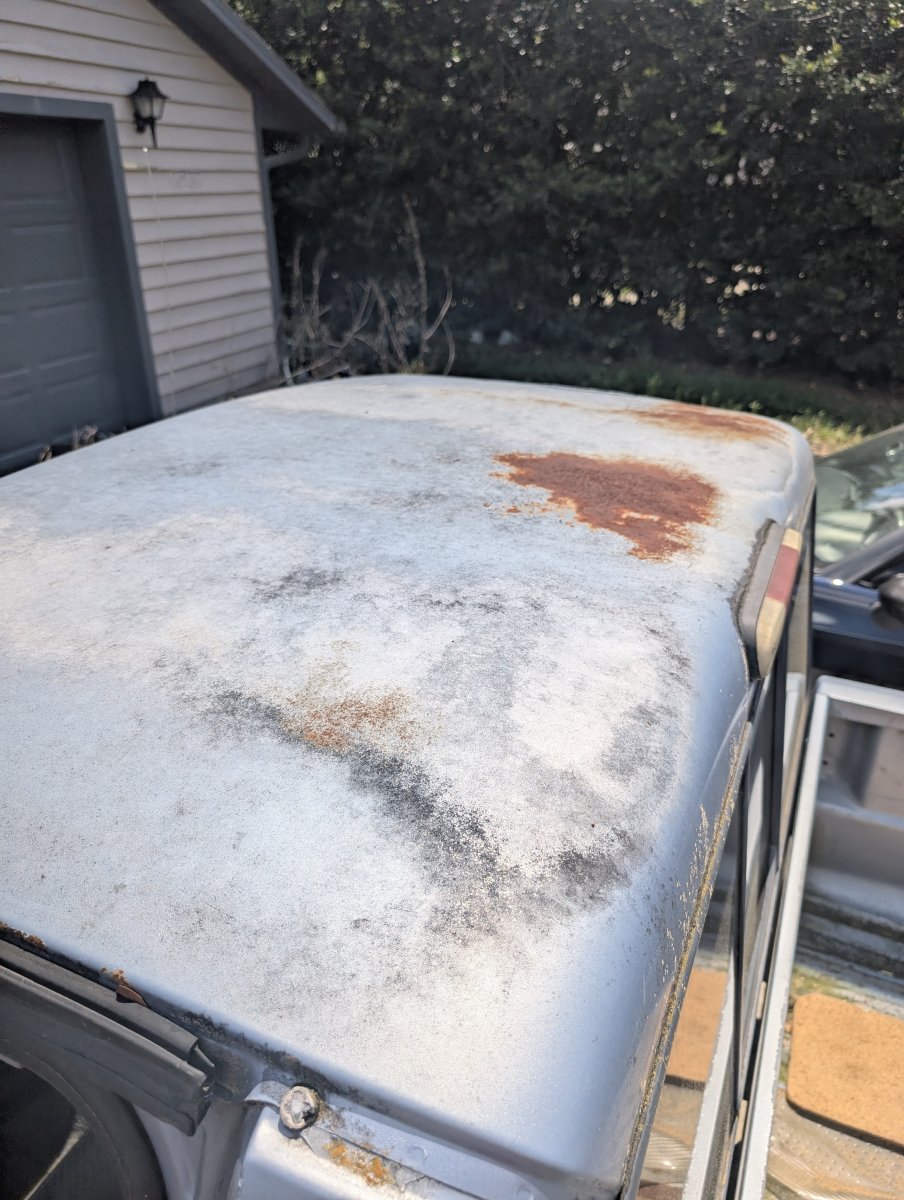

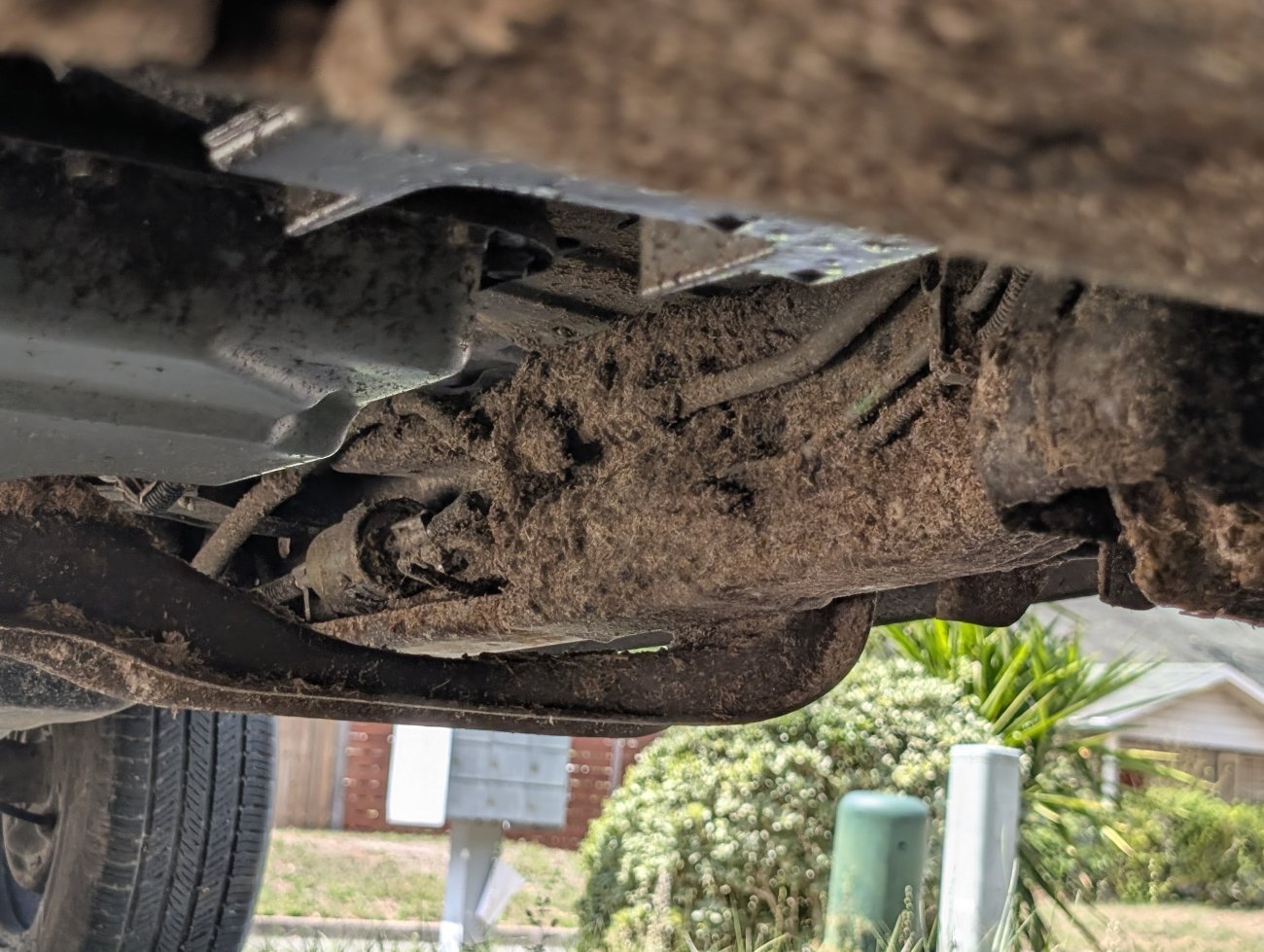

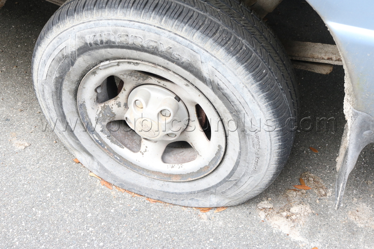

Title shows that it was bought new with 14 miles in 1998, I am only the second owner. Relatively low mileage being a university vehicle, it probably never got very far from campus. From what I can gather by the miscellaneous items and papers I've found in it I think it was used by a veterinary medicine lab, specifically in the livestock program. And it has most definitely been used well, I can't begin to describe how many pounds of caked up grass and mud I've washed out of the frame, undercarriage, suspension, etc. I'm considering it "organic corrosion protection." The good news though is the frame is in great shape, no major rust to speak of. The body has some light rust where the paint has worn away, but nothing past the surface, nothing bubbling or rotting through. The tire that was flat in the auction pics holds air perfectly well, I think it just sat for a while before going to auction. Battery was dead but relatively new and holds a charge fine after jumping it one time.

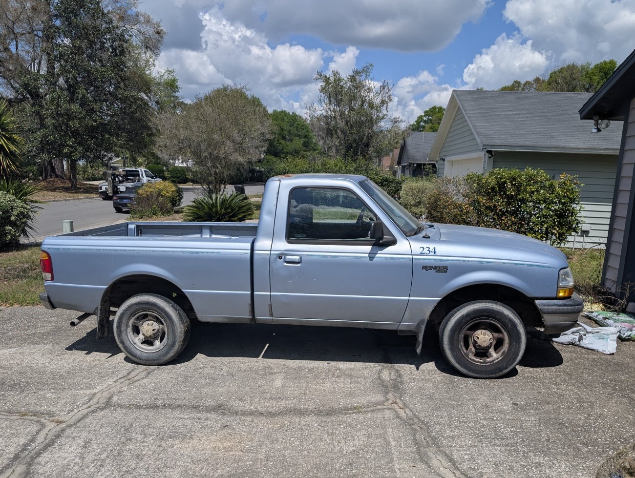

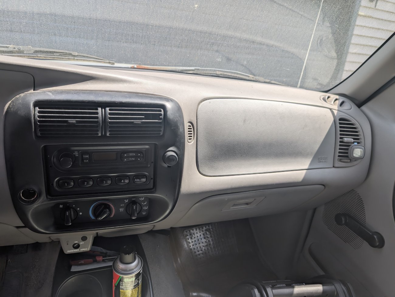

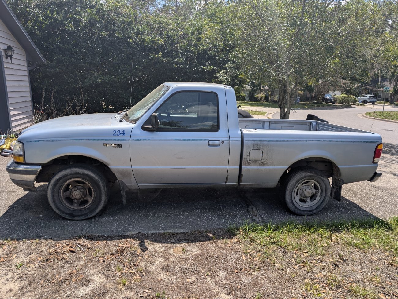

After getting it home, but before washing:
So my goal with this truck is to make it a "clean beater" - keep it basic, simple, reliable, and utilitarian, but freshen it up and make it presentable. Less stuff to break is better, and mechanical is preferred over electrical wherever possible. I intend to use it as a truck, it's not going to be babied and I don't want to worry about it getting dirty or banged up, and I want to keep it simple and cheap to fix when something does happen. I have a newer and nicer vehicle for a daily, one that gets much better gas mileage, so the Ranger will really only be driven when I need to use it. I'm not planning to do anything crazy with it, no serious offroad build or suspension modifications. I mainly intend to just freshen it up and make some light modifications to make it more useful, though I might throw in some fun bits here and there. I will post updates as I go, but here's the current to-do list in no particular order:

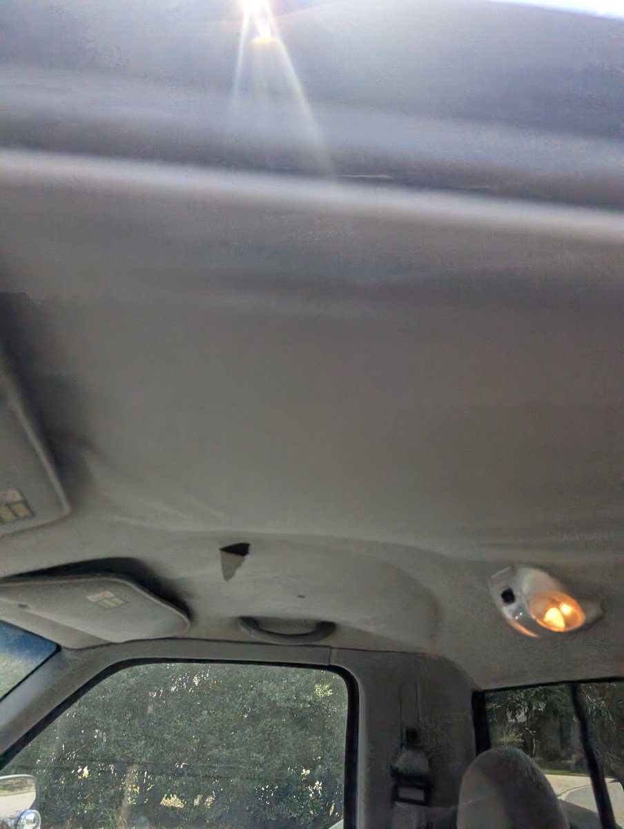

  • Replace torn headliner

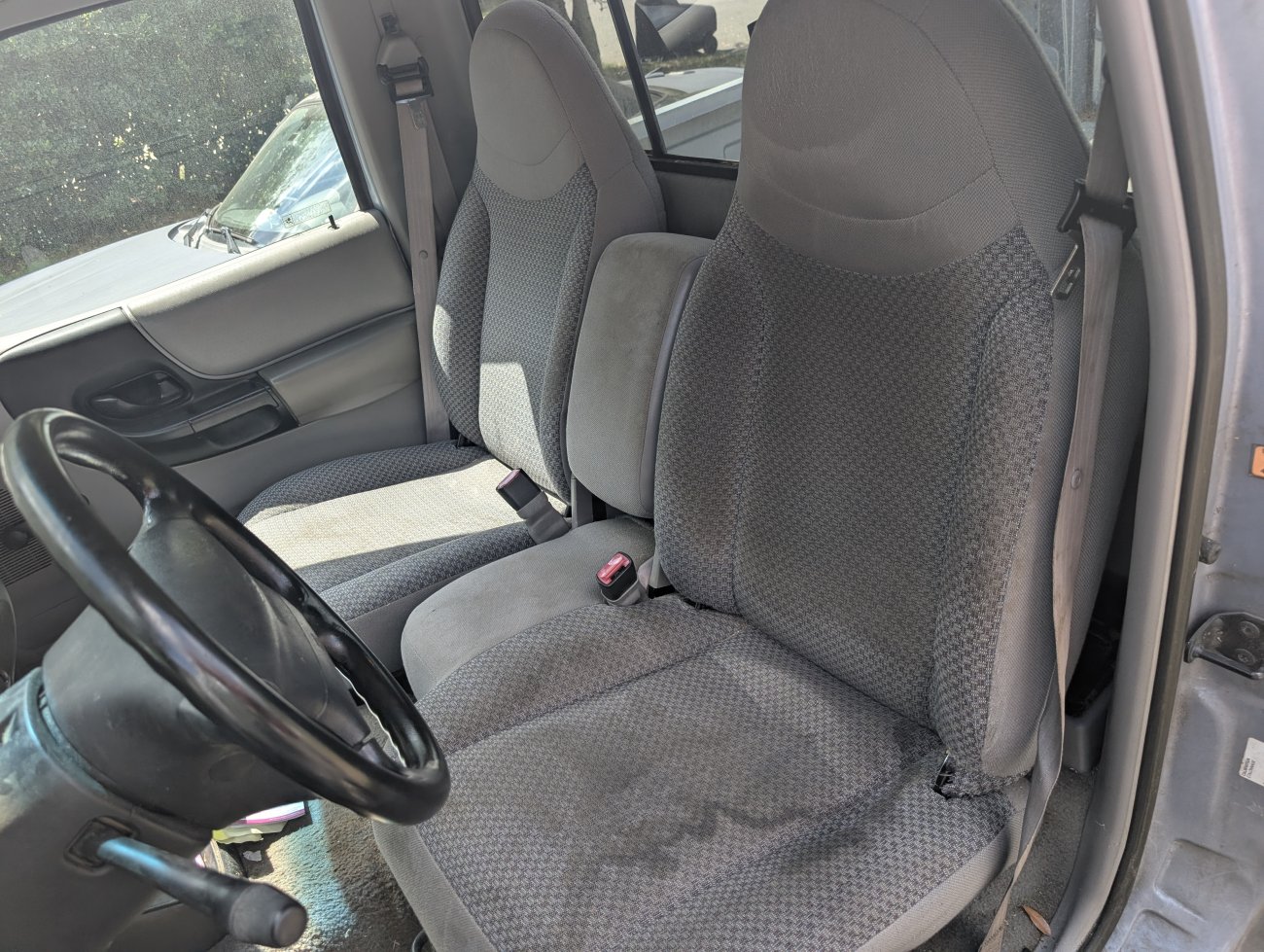

  • Replace cloth seats with vinyl from a later model Ranger, sticking with the bench. Current seats are cloth that is heavily stained, and pretty uncomfortable.
  • Install cluster with tach in preparation for manual transmission
