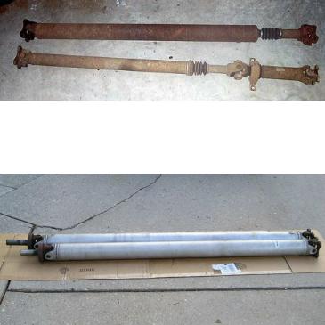

Is there factory 1 piece shaft i can swap in my truck to get rid of the 2 piece with carrier bearing that i have now? Its a 2wd truck, x cab.
We did it on my 94, the hardest part is removing the carrier bearing support crossmember can stay in place
I have a pull-a-part local to me & they have several different rangers & explorers, just wondering which one i need, if any will fit.
In the how to section, you just need one from the same wheelbase
For a 2WD truck, the driveshaft also needs to come from a '98+ Ranger Supercab having the same transmission type (stick or automatic).
Thanks for the info. I will be at the local pull a part Saturday digging to see what i can find.
Make the effort to physically check under your truck and measure it, then way you have knowledge of your own
Got ant aluminum 'shaft from a 2001 3.0 x-cab. Went right in. Getting the old one out was a bitch, with having to cut/grind the rivets off the carrier bearing mount. The bad news is, this didn't fix the low speed "shudder" or noise i am hearing. I think something in the rearend is going out....
