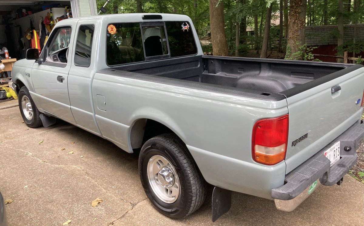

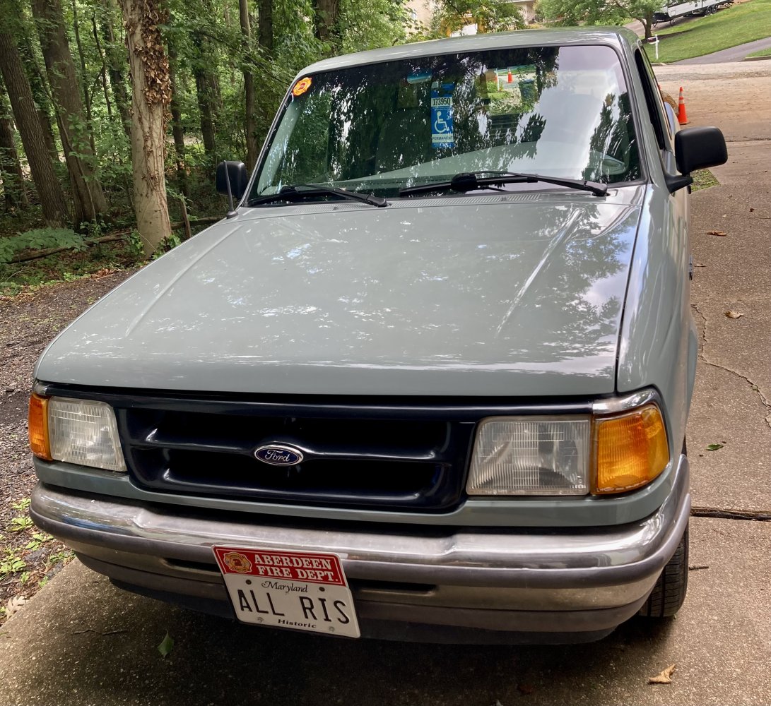

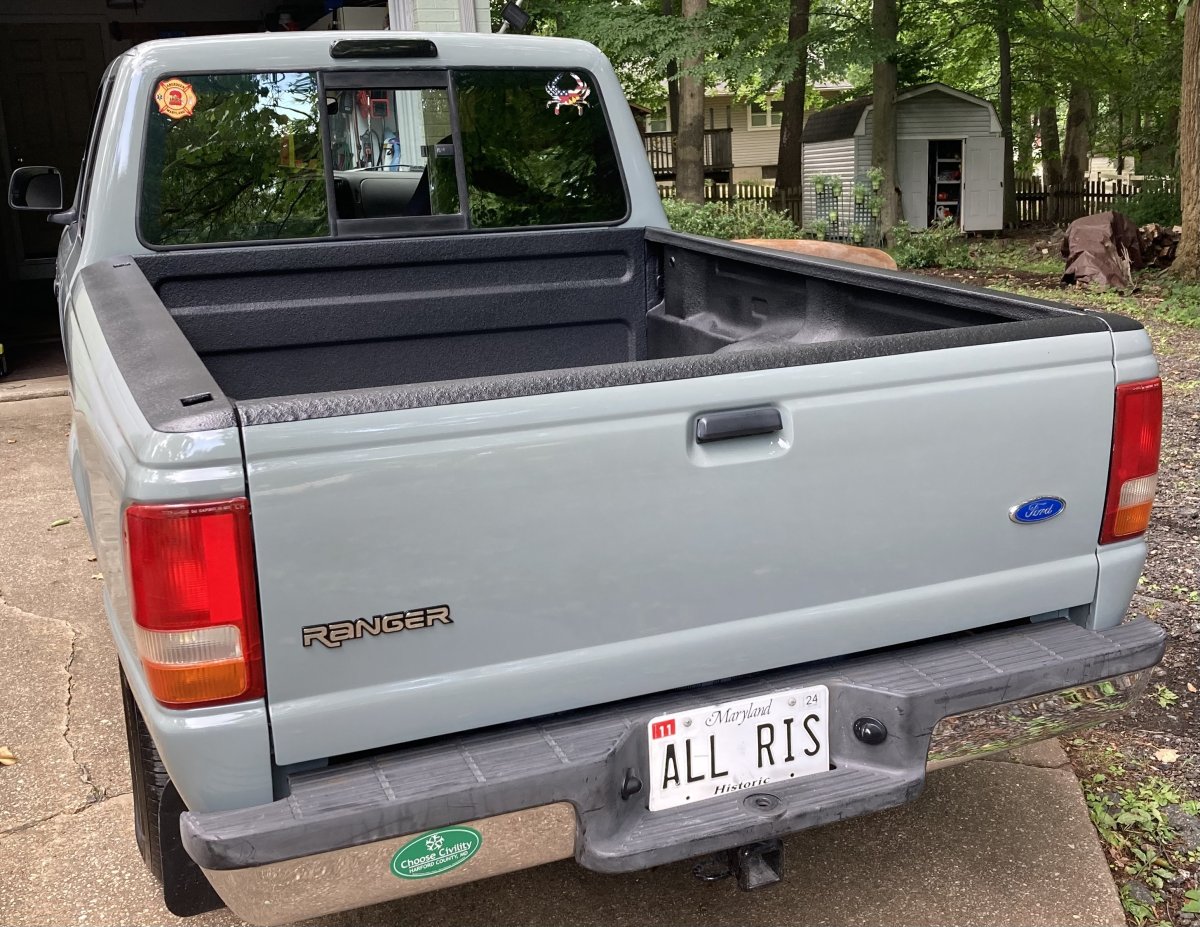

Acquired in Oct 22; redid entire undercarriage-1 1/8 sway bar; all new steering/stabilizer components; performance rotors/brakes with all SS lines; trans/cross member/driveshaft mounts; rear spring hangars & bushings(NEVER do that again!! 3/4” air impact for nearly a day; about did this 82 year old in!!):
Just out of paint shop; H & H Auto Body in Havre de Grace MD; 2023 Toyota Lunar Rock.
Original wheels; Kuhmo tires.
Need to replace inst panel(AGAIN!!); installed one with tach; now odometer stopped working!!! Recovered headliner from a salvage with extra padding.
Modified driver seat to eliminate stupid extra part; cheapo covers & carpet for now.

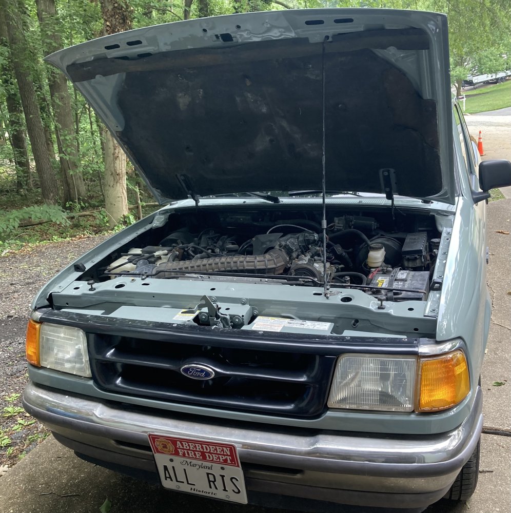

Originally acquired for a 302 swap, but after all the mechanical work decided to see if she would even run: after plugs/wires/most of sensors; thing runs like a sewing machine!!

I like that color. Truck looks great!
Since you got a 3/4" impact I was hoping you might do a few others :D
Great looking truck man, good luck with it
One thing I've noticed a lot of lately, if you hadn't already seen it or done it is the 02 Sensors, seems they wear out by the clock
Thanks!
Actually replaced all 3 just before going to paint shop!!
I'm not normally a fan of the flat grat, but it came out great.
