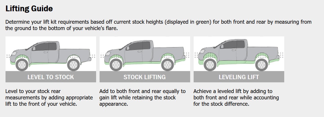

One vendor I was considering offers three different styles of lift kits (note the Leveling Lift at right; this is to what I was referring). As I understand, while it lifts both front and rear, the front is given added lift to eliminate the stock rake.
Alternately, to get the same effect, I could go with "Stock Lifting" (lifting the same amount front & rear) and eliminate the rake by adding lifting springs to the front correct?

Body lift and spring lift to level... that is the way I'm familiar with.
I would be surprised if your pictures depict "body lift only"... I have been wrong before though. Seems impossible to keep the body lines straight.
