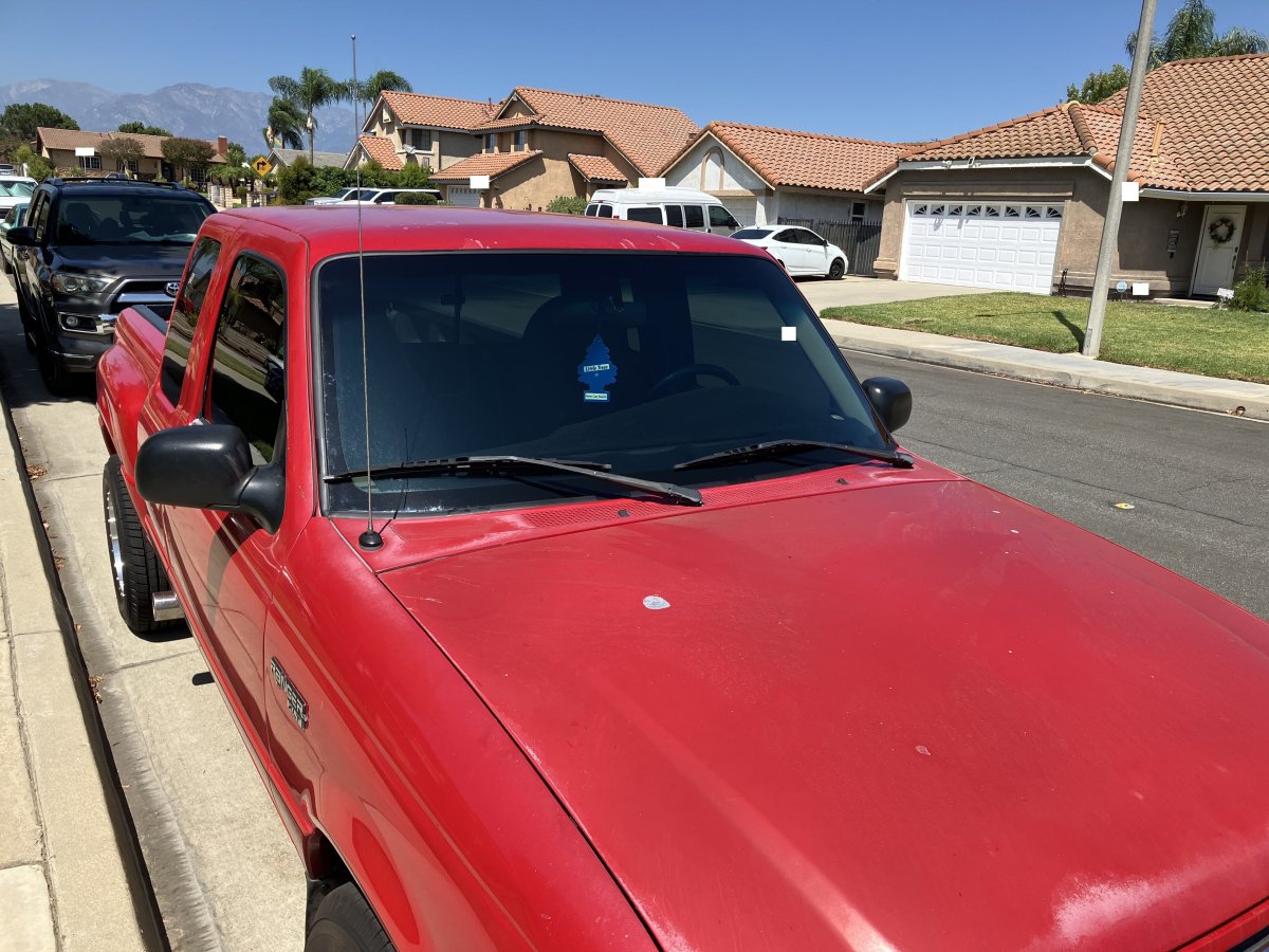

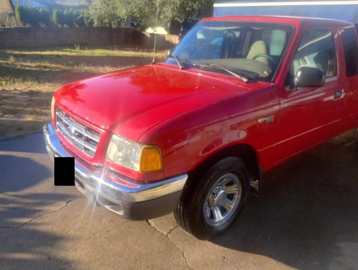

Here is a picture of the OEE Glass vs the OEM glass carlite ford glass. The OEM glass appears much darker but it is clear.
The OEE glass wouldn't wipe clean in the morning or repel the water very well. So Condensation wouldn't wipe away well. So i could not see well in the morning with the OEE glass and it is not winter time yet, Its summer time.
The Windshield has clear ceramic tint on it that is legal. Witch might also make the windshield appear darker
I have not tried early morning driving yet with the new windshield. Hoping it will wipe clean just with the wipers. I might have to replace my wipers.

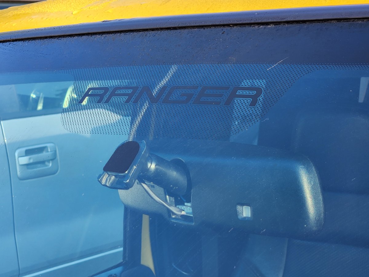

It's the windshield that comes stock with the FX4 / Level II. Cost a little extra but it's a Carlite. Diamond polishing powder for windshields

The polishing powder gives good results when done correctly. Normally done when the stock glass needs rework & new glass is non existent. The diamond powder (600 mesh) is corse enough to remove light pits & scratches, and leave a high gloss. I use a buffing pad with a light oil like wd40 and about 1 gram. Have to charge the buffing pad slowly. Then when it's full then it's ready. The glass polishing is a typical rework on existing glass on older vehicles. Keep it on the pad and not on the paint, motor, lungs.
The Ranger windshield is a stock Carlite part, costs around $460 installed, you could get the same thing with a vinyl decal, but no hatch marks-dots. The wife told me that I will not replace my broken "Ranger" glass with no other than the one it came with, I said ok! Ask your windshield guy, there available as new old stock.

It works pretty good but it will not remove deep scratches, mostly abrasions left by wipers. It is available through Eastwood. Those new ceramic "waxes" or coatings also work well on glass. They will protect it from wiper marks, also make it a little easier to clean off dead bugs. I think they also will extend the life of wiper blades. I use Turtle Wax products but would imagine the other brands are equally as good.
