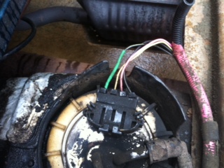

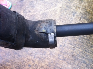

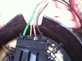

Well took the bed off again just a few minutes ago and change the filler neck hose assy and put bed back on. Took a few pic's so i hope i can get them uploaded. Also attached a file with the wiring diagram for the instrument panel to sending unit. The filler hose had several cracks in the hose and every time i filled up with gas i could smell it for a while.
So I've been reading this thread for about an hour now. Trying to figure everything out, and I am at a crossroads. I tested my sending unit, and it read 16 Ohms with the float all the way down and 152 Ohms with it raised. So I think my sending unit is good, I even hooked up a new one just to test and it did not affect the gauges. But if I disconnect the fuel pump the gauge shoots to full, and drops to empty if I reconnect it. Where can I go to try and fix this problem?
solved, previous owner failed to reconnect a connection under the hood.
