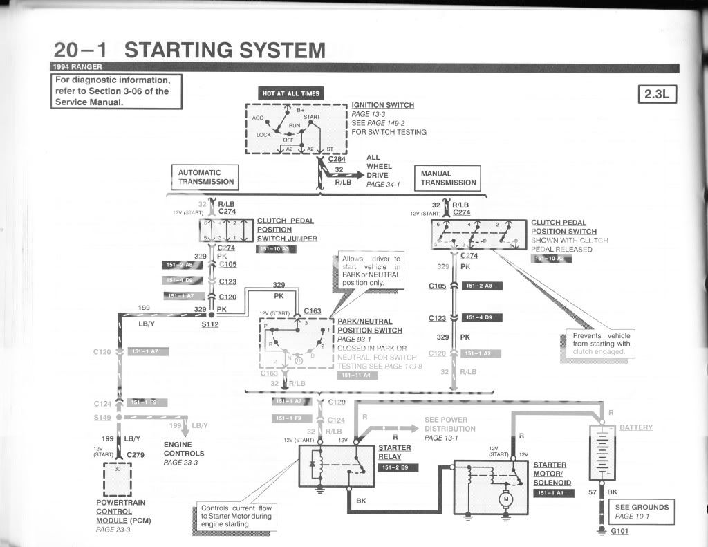

Here is a scan from the Ford electrical and vacuum troubleshooting manual factory service manual for my 94 (not sure how much would be different since your 96 should be OBDII)

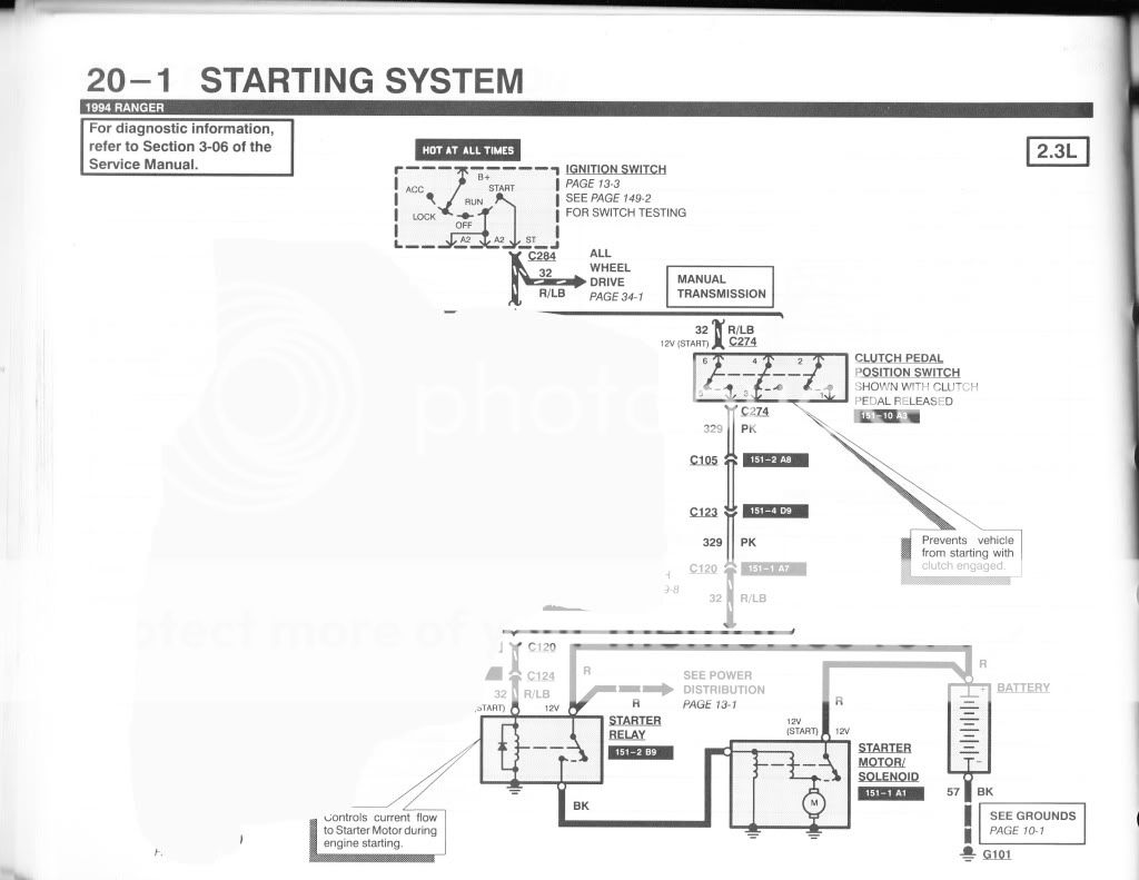

Actually, use this diagram, I whited out automatic trans stuff...
This diagram shows when you turn your key to "Start" battery voltage should go from the Red with Light Blue wire from the ignition switch into the clutch switch, out by way of the Pink wire which splices with the Red with Light Blue wire that goes to the fender mounted starter relay. To check voltage on these wires, ground the black lead of your meter and probe the back of the sockets with the red. I hope this helps. Oh, and btw, as far as my manual goes, ebay FTW and ALWAYS make sure your truck is in neutral before jumping the fender mounted relay or the solenoid on the starter itself. I also broke my fender mounted relay jump starting it with the tire iron I used to beat my starter with, then broke the new one so I have to take it back. I would suggest using a 1/4 drive ratchet to install a new one since you can't torque the snot out of them causing the new relay to break.

Pocket rocket, appreciate those attached pics of the starting system, I've got a layout in the haynes manual but this also gives me something to compare it to (could be a little different due to mine bein a 96 and your's being a 94).
Modelageek, never had to replace the starer solenoid, just the fender relay. I'll try testing the clutch switch with the multimeter and see if I can get a reading when trying to start the truck. What voltage should I be getting to know if it is alright or not? Clutch switch is very easy to switch out so if I have to replace it it is not a problem (just wish they weren't $50 a pop)
I'm sure there will probably be some difference like I mentioned because you are OBDII and my 94 isn't. You should get the same as your battery voltage (maybe a little less, but not more than a half a volt I would say) from the clutch switch. Basically you have 2 switches in line between the fender relay and your battery to simplify it (ignition switch and clutch switch) and both have to be on at the same time for the starter relay to energize. Pics were no problem :icon_thumby:
