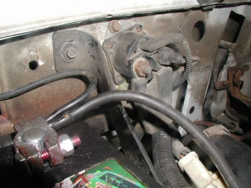

Ok, maybe something here. I have 12.5 volts from the positive cable to the starter, and I have 12.5 volts at the starter relay (I guess this would technically be the starter solenoid switch since the solenoid itself is mounted on the starter?) on one of the posts (the relay is mounted to the fender between the distribution box and battery). I cannot get a reading on the small ignition wire at the starter or at the post on the relay that connects to the ignition wire (when trying to start the motor). Ford had a stock piece that you attach two wires to (the positive cable and ignition I think) that both attach to female spades (it's one unit, I have a picture attached of a similar piece on an F-150). I stripped and ran new 10 gauge wire from this stock piece (so there is about 2 inches of original wire left, 1 outside the piece and one attaching to the female spade inside the plastic). That old wire could be bad, because my connections I have double checked and they are fine.

I'm only getting power to the one post so it definitely could be the relay. I'm not sure if the clutch/neutral swtich is wired to the relay or not (if someone else knows about this because I have no idea). I have tried to jump the 2 big posts on the fender relay to no avail (I get the same clicking sound when I simply put the truck in the "on" position, when it is in the "on" position and jump the relay with a screwdriver, and when I simply try and start the truck).

Just finshed putting new spades and bolts for 2 of the 3 grounds for the negative battery cable (the fender and body across from battery but not the motor) and still doing the same thing. Probably gonna replace the starter relay next.
Just replaced the relay and the truck is still giving me that same dam* clicking sound. I don't know what in the h e double hockey stick to attack next.

Just wanted to mention I put a new relay as well as cleaning all of the grounds I could find (found a couple more, amazing what happens when you take a break as well as have some sunlight for the first time in a week to help) and I got her to start up, but I had to the jump the new relay to do it, so here is the question, I believe it is an ignition problem now but not 100% sure. Thanks again to everyone who helped me get this far, happy to have half the battle but still have half to go.
either the relay is bad, or the ignition switch isn't sending power to the relay. good job. glad you've pretty much got it figured out, many others would've given up by now.
The ignition switch is most likely the culprit, the new relay actually lets me jump it (the old one did not). You know my luck isn't great when tightening the bolt on the new relay and the post snapped, so I'm off to get another new one, as well as a new ignition switch. Should be good to go after that, thanks to everyone for all the help, I"ll let y'all know when I get this thing 100% done.
