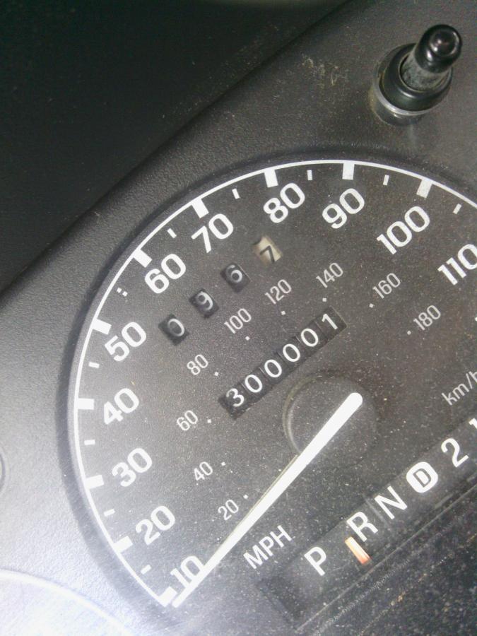

My ride just turned 300,000 on the 3.0 Automatic and it runs pretty good I use it daily.
